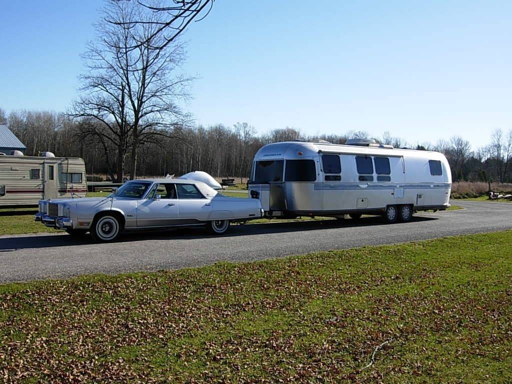

I bought a the 78 Salon with a an open differential 2.7 ratio and installed a 3.23 sure grip into it then installed the 4 point Reese receiver and the rest of addons including the triple core rad, power steering cooler so I could pull a 6,800 lb 30-foot wide body Airstream. I put the GV overdrive in it for the 99% of the time I wasn't pulling the Airstream. Below is a pic of my 78 NYB Salon car setup to pull the Airstream.

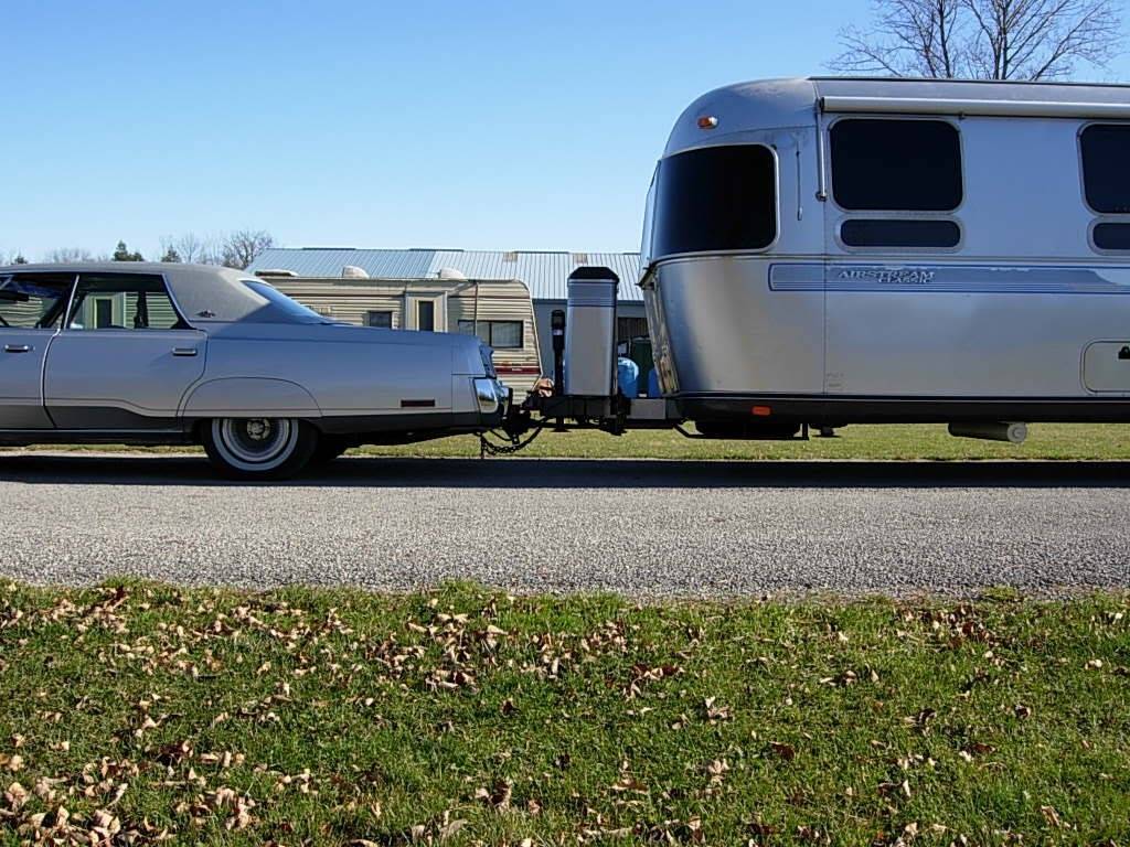

Above is a pic of the Reese load leveling bars snapped up tight with sway control. Sway was a big concern with this setup as the NYB has no sway bars, all away control was done via the Reese hitch. The GV overdrive is obviously shut off when pulling this setup letting the 440 and 3.23 do their work. When not pulling the trailer just click the floor switch to turn on GV and the car is a missile.
That car does have the optional load leveling air suspension as well and the air shocks are functioning fine after I repaired it but it's the hitch that brings it up level. Part of the heavy trailer package for that car in 1978 included 1" torsion bars from the .991" standard torsion bars and they were acquired from a 75 Imperial which got 1" torsion bars standard. That Airstream tongue weight was 670 lb.

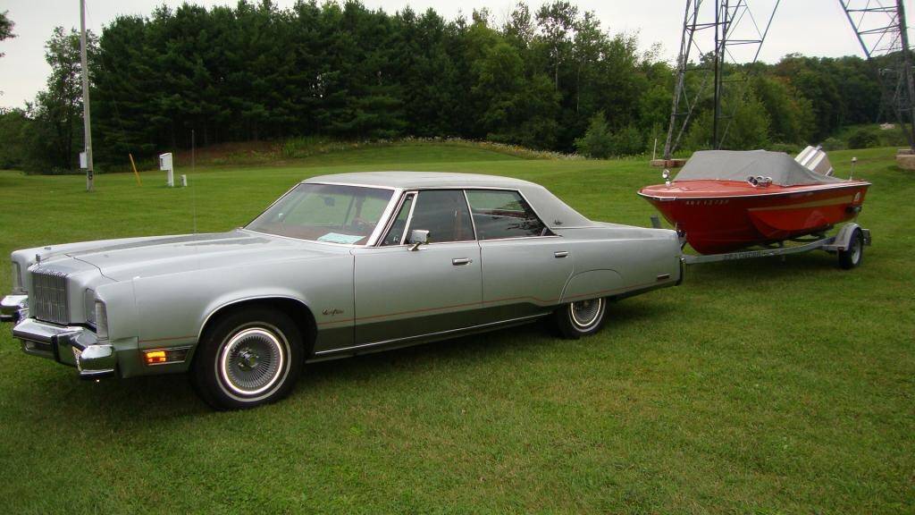

I've switched from the Airstream to boats now. I have six Chrysler boats in various states of repair/disrepair and the pic above is at Moparfest 2014 in New Hamburg, Ontario. The boat is a 15-1/2' 1967 Chrysler Charger with a 105 hp Chrysler motor. The motor is also a 67 still running breaker point ignition.
