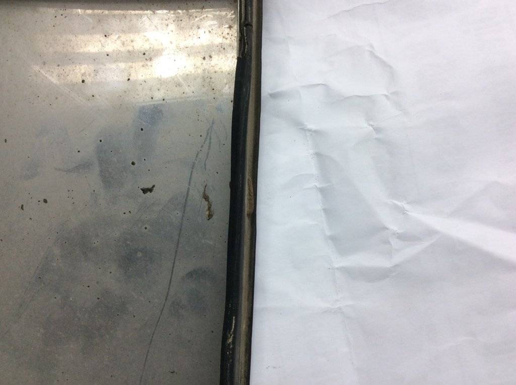

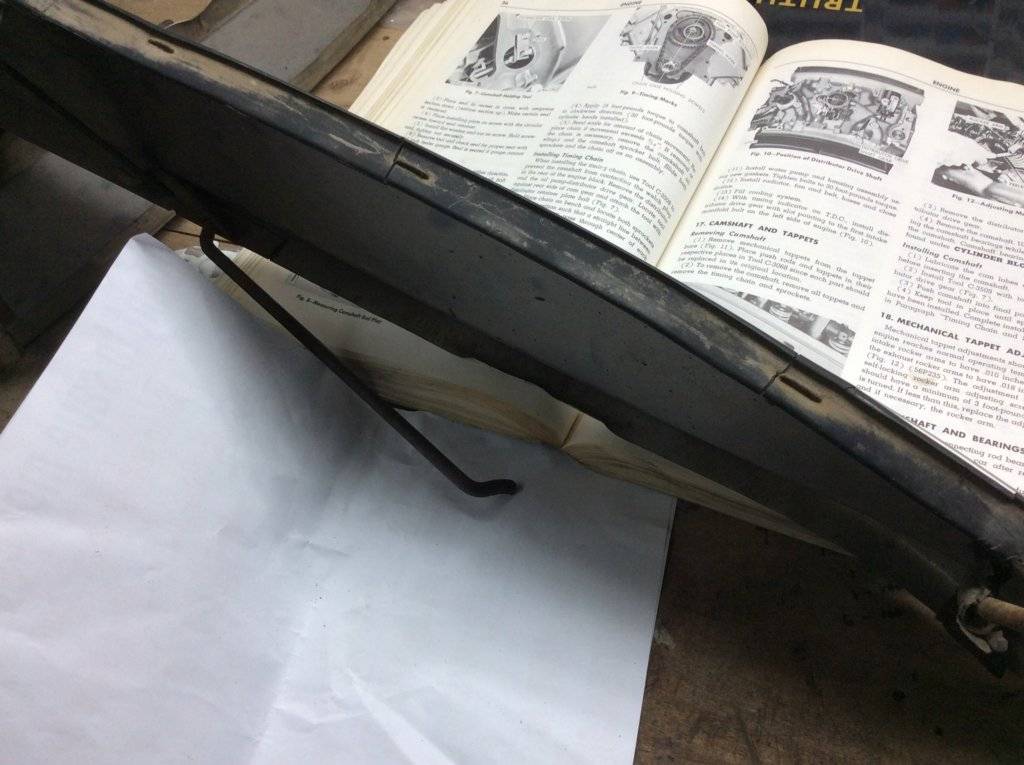

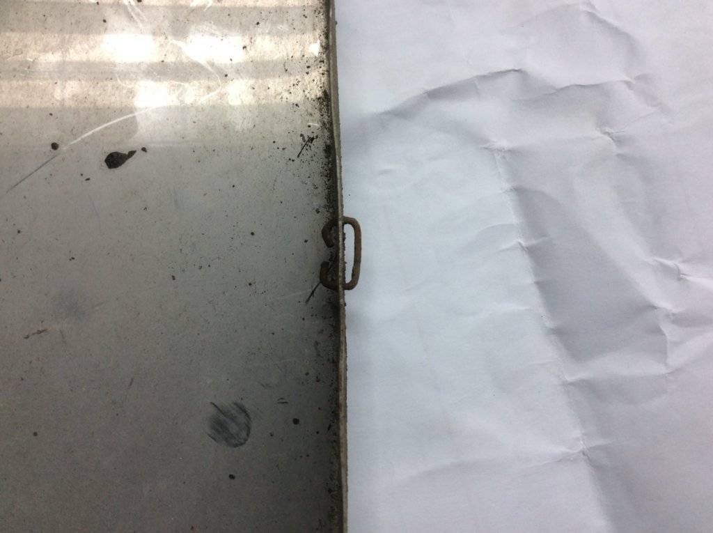

...I have wheel skirts that need new seals. I got suitable welting, but I need some help attaching it.
Right now the perished welting is stapled in. See pic. I’ve pulled a couple of staples. Not salvageable.
I’m worried a screw would have a profile that won’t let the skirt mate properly and will tear up the trim on the car. I’m guessing it was made with an industrial stapler, but Couldn’t find a stapler that I would think would restaple it.
Anyone else been through this? I included an empty close up shot of the staple, close up of existing and a longer shot.
Possibly an insulated wire of the same diameter or a non-stranded wire with the insulator removed? Then cut to length and shape as the staple, then install it and bend the inner ends for retention. Once installed, the staple is not really needed to hold the welting in place.
Just some thoughts,
CBODY67
Just some thoughts,
CBODY67
OR...I could just try some solid core wire and twist it. Same effect.
