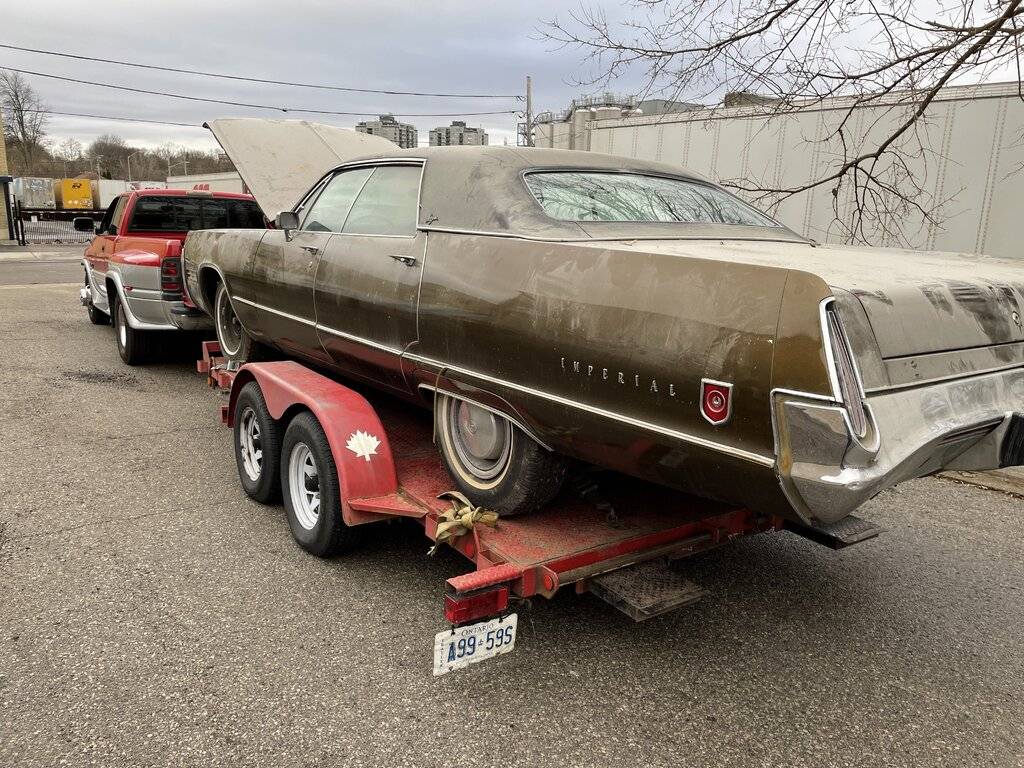

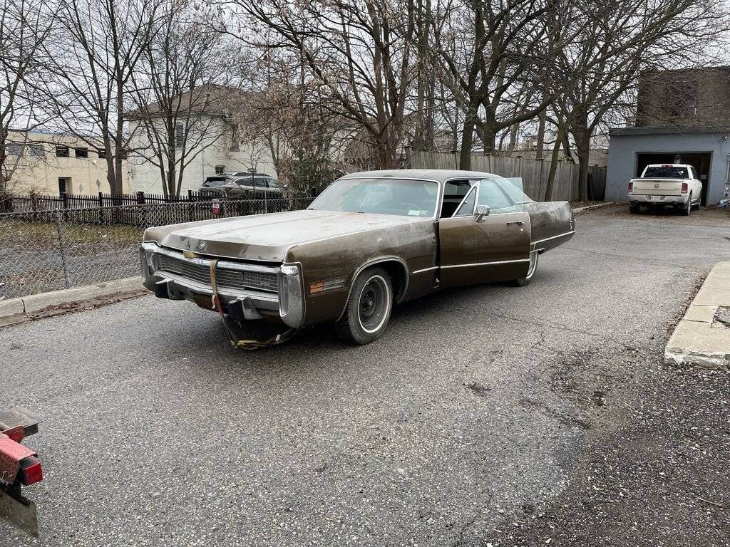

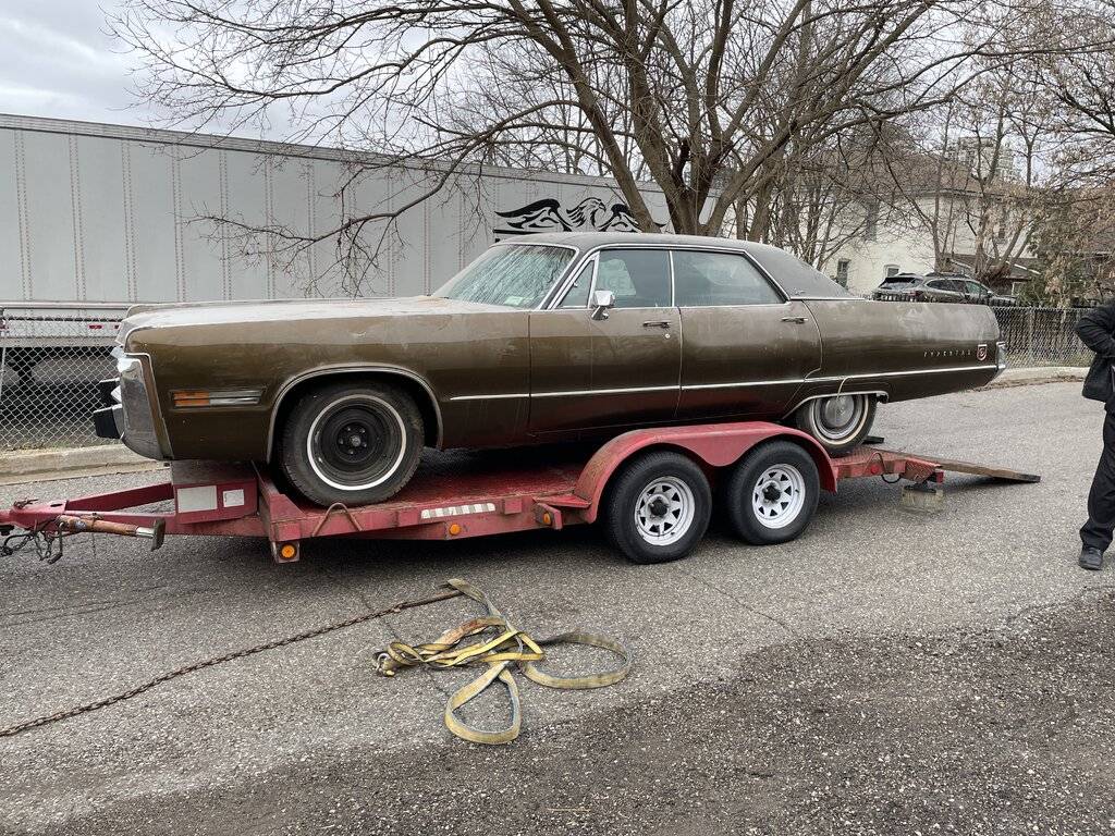

First I did a test fit on my friends truck and trailer, his truck was more then able. We really wanted to see if it would fit his trailer before driving a few hours to get the Brownie Imperial.
It fit, just. We pushed brownie on with the help of some construction guys near by, They were looking at the Imperial enough to charge them admission by pushing. Good thing it saved a lot of time and pain.
Heavy weight trailer, good trailer tires with correct tire presure and bearings.

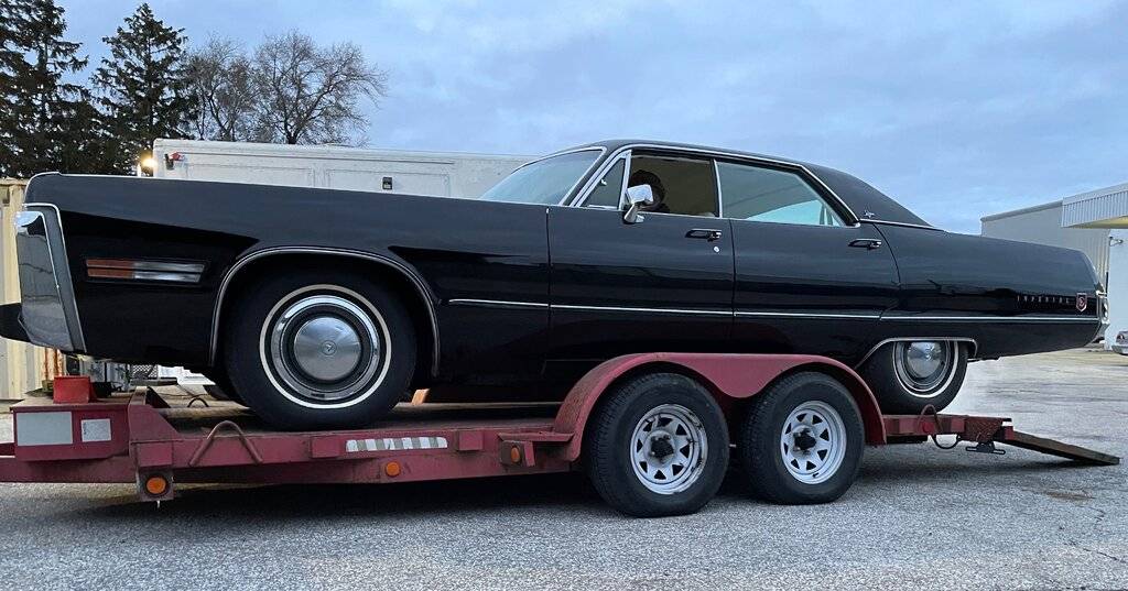

ive got an 18 foot trailer,7k capacity... my 69 300 fits on it with no overhang. 7k weight limit. a 16 ft would probably work, but car will be hanging off the back
We were worried about the nose overhang meets tail gate on tight turns. It worked out well on this set up. Check the nose to truck clearance.
