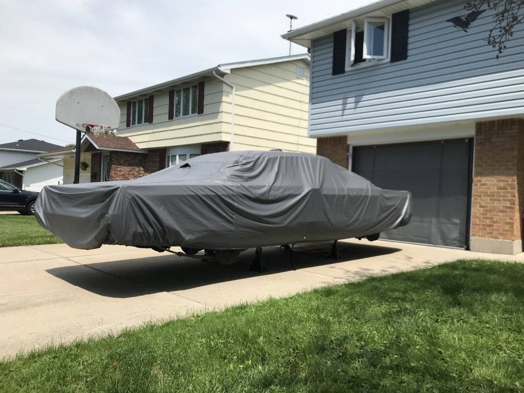

Getting my Newport ready for the ride to Carlisle. As part of that it's getting new sneakers, here it is in "Hover Mode" :lol:
I would have liked to go with 15" Magnums like Cbarge has on his 68 (I love the look of his car!) instead of the 14" Magnums that I have, but that didn't fit in the budget. I went with the Hankook Optima whitewalls, they should look fine. The old tires had plenty of tread, but were getting pretty dry rotted.

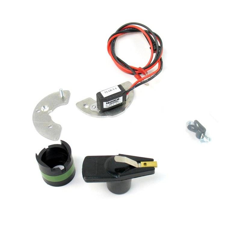

Rock Auto sells a points conversion kit WVE/AIRTEX/WELLS 1A4090 for 181.99. Has anyone heard anything good or bad about it?
I googled it and it looks just like a Pertronix unit, except it's more expensive.
Pertronix 1381a
Not positive but they have reboxed stuff before sure looks like a petronix.
I'll sell you a Dave's special points elimination system.
Looks just like the above units for only $211.89 and I sign each unit for 5/50 guarantee. PM me if your interested.
does the conversion require other components or does this wire directly to the coil?
Nothing else, just wire it in according to the directions.
I suggest going with the Pertronix unit rather than the Wells piece. It's obviously the same unit, but you can buy the Pertronix version for about $100 less. You will also be able to call Pertronix etc. should there be an issue. PerTronix Ignitor® Solid-State Ignition Systems 1381A (Double check the part # and application)
I'd also look at the Pertronix Ignitor II as I think it's a more reliable unit because it has some internal circuitry that protects it if the key is left on.

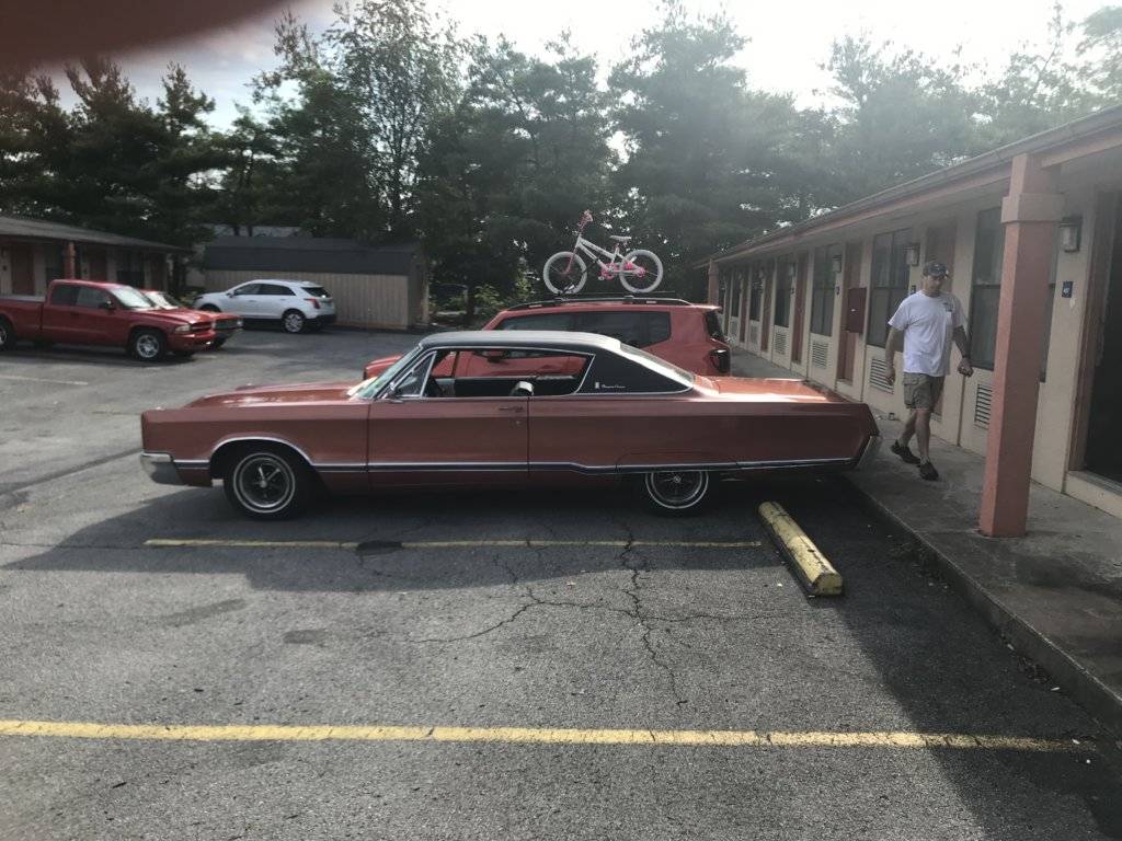

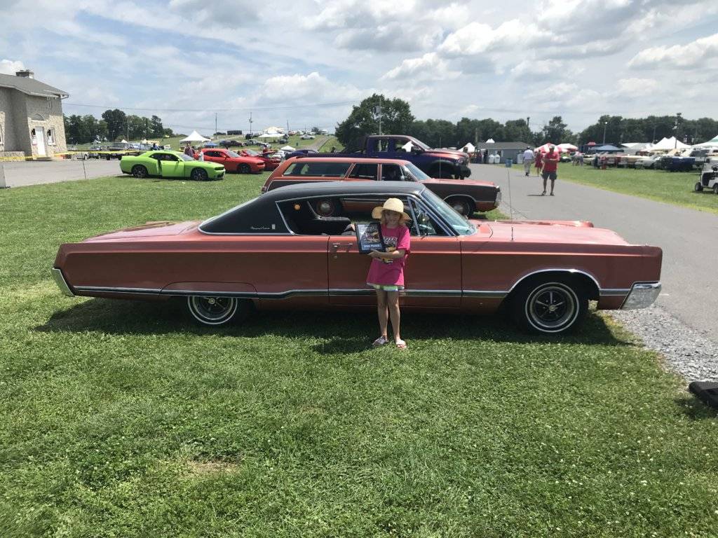

I had a great trip to Carlisle. The road trip went well, I caravaned down with my youngest son, Jeff, who was driving my father in laws 67 Barracuda. Very cool to have two 67 Mopars heading down together. Had some minor cooling issues, but as long as I slowed down a bit on the longer hills I was ok. (I did add a digital temp gauge which was great to have). This was my first time to Carlisle, and it was awesome! My oldest son, Chris, came up from Raleigh and brought his 8 yr old daughter, and my brother in law and father in law were there as well, so it was a real family affair! The cap to the event was that my car won second place in it's category - really cool! Here are some pics - from the trip down, at the hotel, and my granddaughter holding the plaque.
