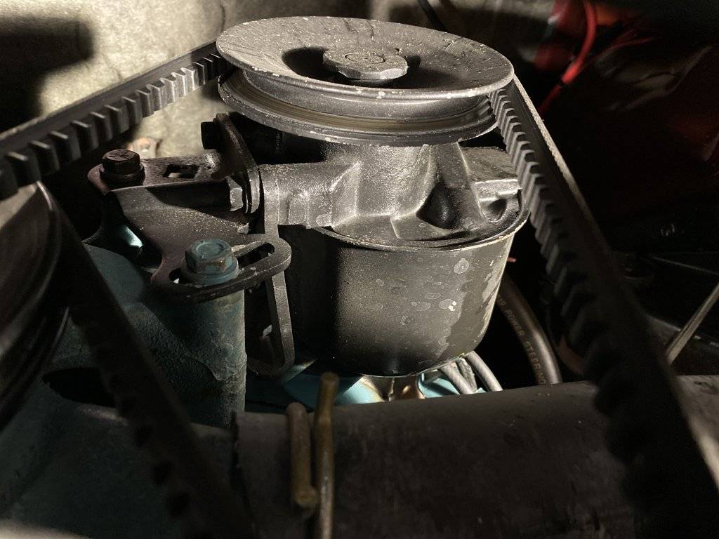

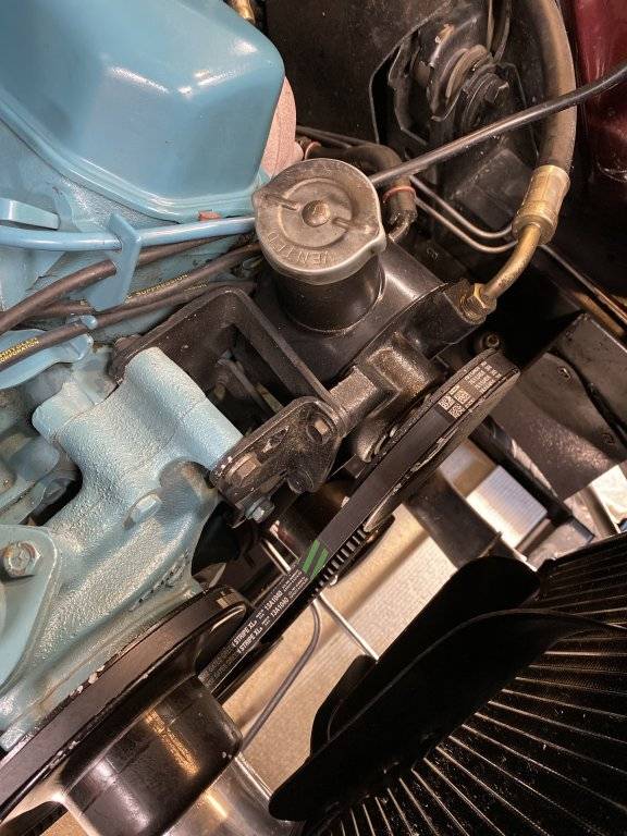

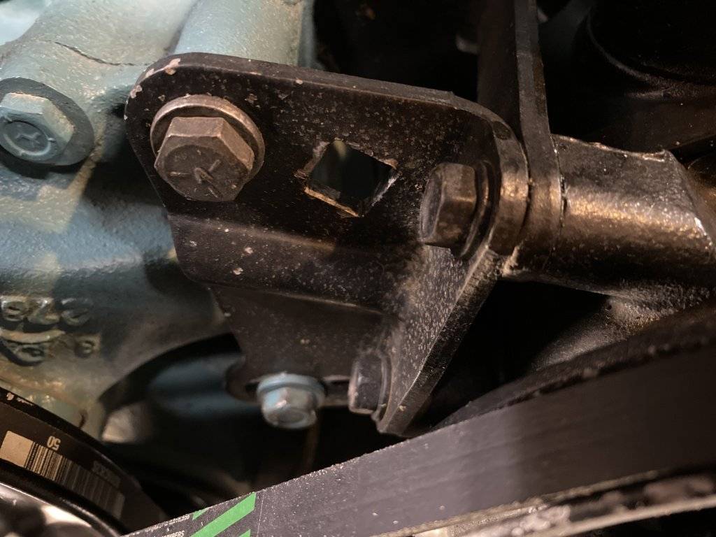

@Big_John that video is for pre’68 with the much too complicated hinging bracket. (The video is labeled wrong). ‘68 and up are a simple bracket.
@NHCars for ‘68
Pictures of bracket From the under side. (Adjust from the top side)
From the top
Blue bolt hole is slotted. 1/2” drive hole is up by the long pivot bolt (top). Loosen pivot bolt. Insert 1/2”drive ratchet or breaker bar. Loosen lower slotted bolt. Use 1/2 ratchet to tighten belt. While holding ratchet and belt tight, tighten the bottom slotted bolt, then tighten the top pivot.
I distinctly remember that type of bracket on my Dad's '68 300 that he bought new. He cussed at the bracket more than once.... Especially after a warranty repair of the pump and the belt adjustment was done incorrectly.
@NHCars for ‘68
From the top
The parts manual I can download is missing that section, so I can't point at part numbers.
The OP has a Chrysler, not a Dodge, so the bracket may be different... the other possibly is because of different pumps fitted to the cars.

Big John; Any idea what the part number (or name) is for the item in your photo. I think it might be exactly what I need. That, and some pulleys in the vicinity.
Not sure what you mean.
If you are missing all or part of the bracket, it might be better to go to a newer style.
Yes I am a little Dodge blinded. The Chrysler’s used a larger pump than the Dodge’s as well, so maybe took a little longer for Chrysler to switch to the simpler bracket.
Well, this is what happens when I've just gotten off an hour long conversation with the cruise ship's "customer service" getting them to fix their screw up from a year ago. I get fired up about being right.. LOL!
