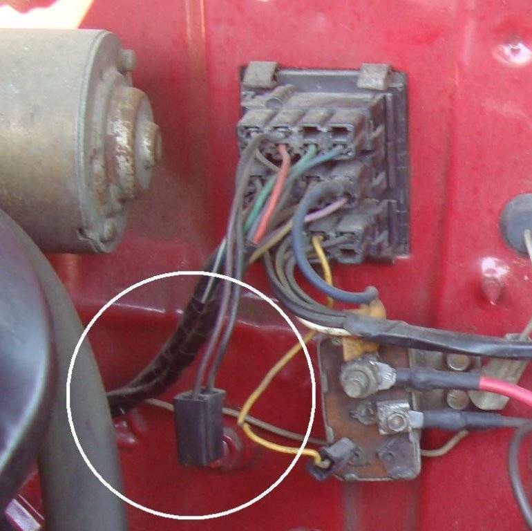

What and where is the bulkhead fuse block? Are you talking about the fuse block in the car or should I be looking into the connection of the fuse box through the firewall?
Before you tear into that, jumper the starter relay as I suggested above. That bypasses all the wiring into the firewall, under the dash etc.
While there could be a problem with the connections to the fuse block, you want to be sure that the problem is not under the hood.

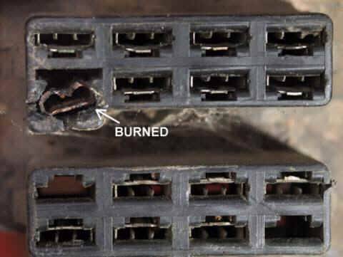

What he is talking about is the connections that go through the firewall. They are prone to corrosion and loosening. It would be the first place to look after you've done some basic diagnosis. I use a product called Deoxit to clean them if needed.

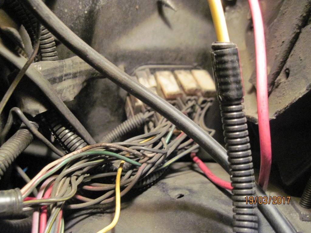

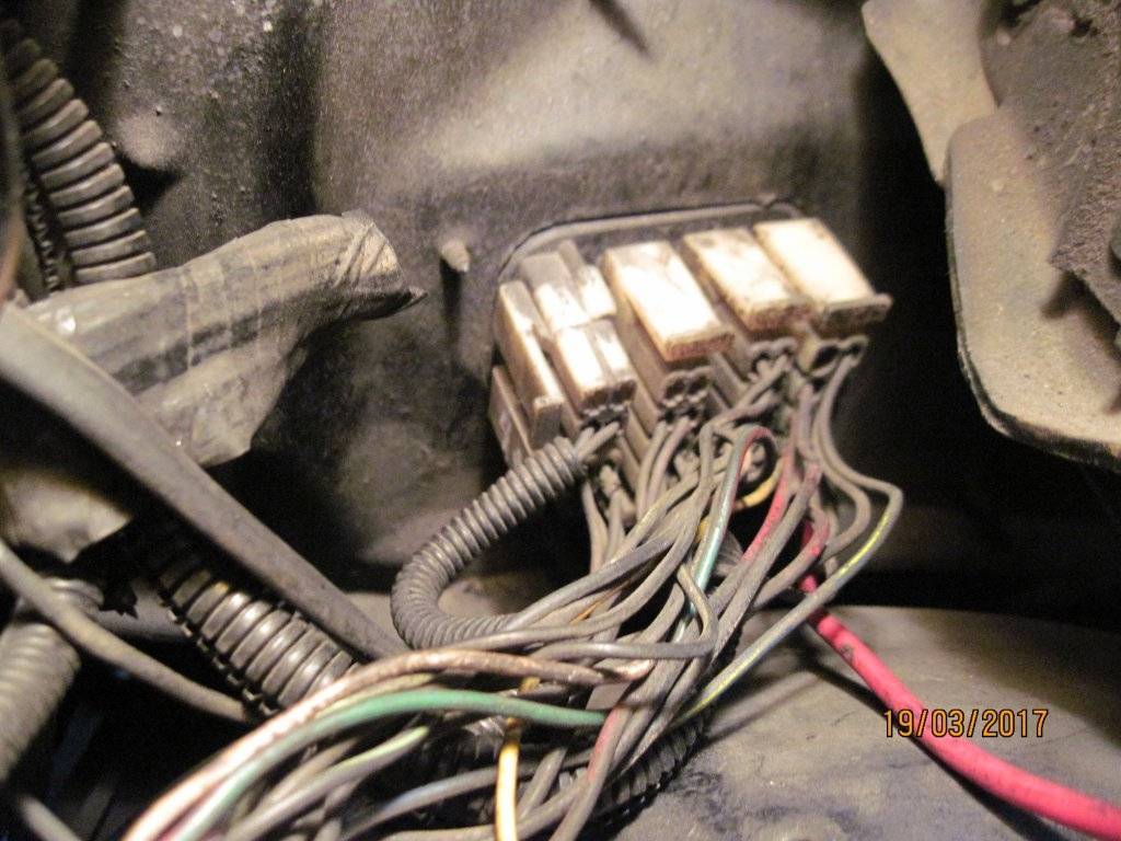

Yes in the engine bay...... see some pictures below.

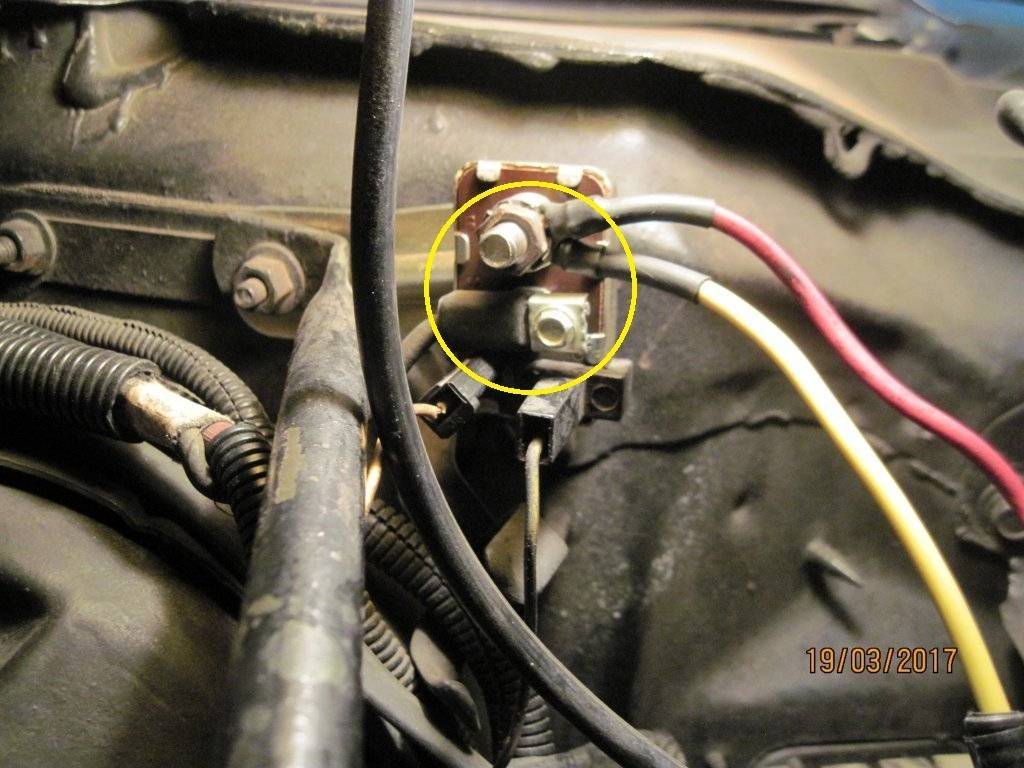

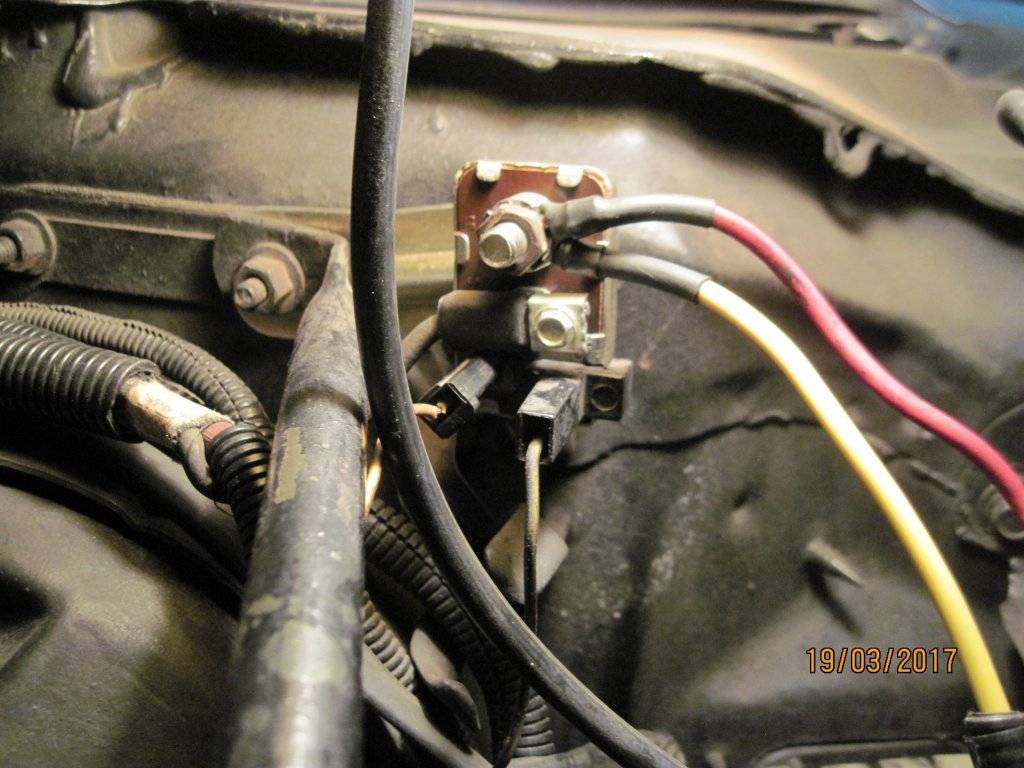

I am thinking there is a starter relay problem. I do not understand it, but all the power for the car seems to go through the starter relay. As soon as the starter clicks, the total car loses power for ever. The only way to get power back to my lights, radio etc is to disconnect the battery, then all is fine until I try to start again. I would have expected the starter to drain the power while it was trying to start and then I stopped trying to start it, the radio would be back on. I put the volt meter across the battery and turned the key, there was a constant 12.76 volts, before, during and after I turned the key and lost the power to the car. I connected the volt meter to the positive on the battery and the other end to the top bolt on the starter relay and there was no volts, I tried again to the lower bolt and there was 12.68. I repeated it with the fuse wire disconnected and in both cases the voltage was 12.69
Will keep looking, atleast it is easy to create the problem. I just turn the key on, hear a click and then mo power unless I disconnect one of the two smaller wires that I assume goes to the solenoid, then there is no click and no lost of power. It seems like the starter is drawing power and kicking out a breaker, but just where?

See the two connections on the starter relay? Without turning the key or doing anything else, stick an old screwdriver between them. If the engine doesn't turn over or does the same thing as before, it's a bad connection/cable at the battery, starter, or ground.
