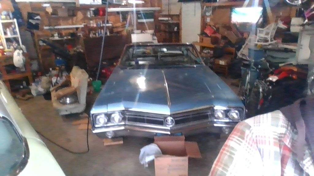

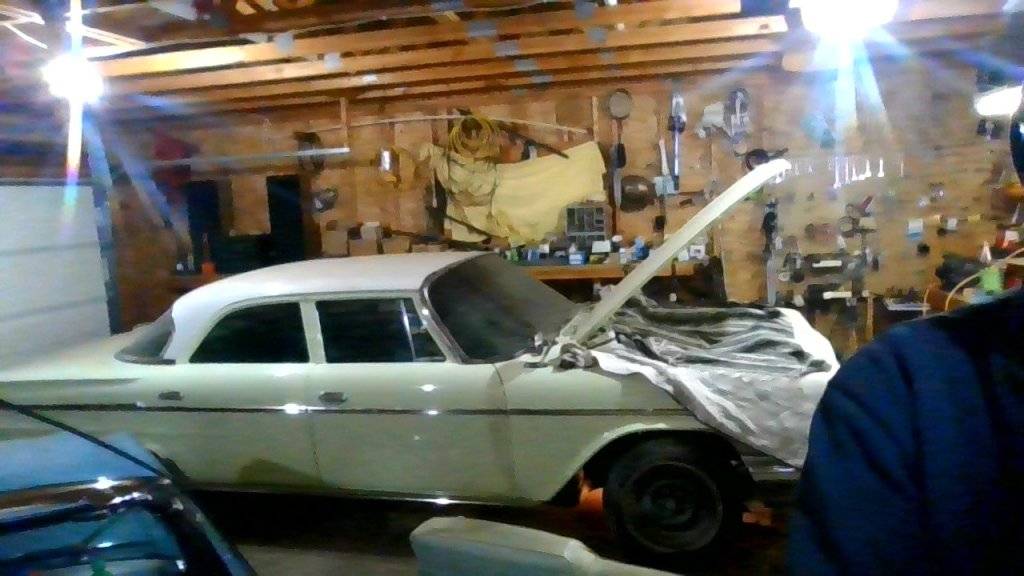

Thank you - One with the hood down, and one with it's garage mate a 65 Buick Wildcat... will i get banned for posting the buick pic? You guys should cut me a little slack since i finally wised up enough to buy a Chrysler right...

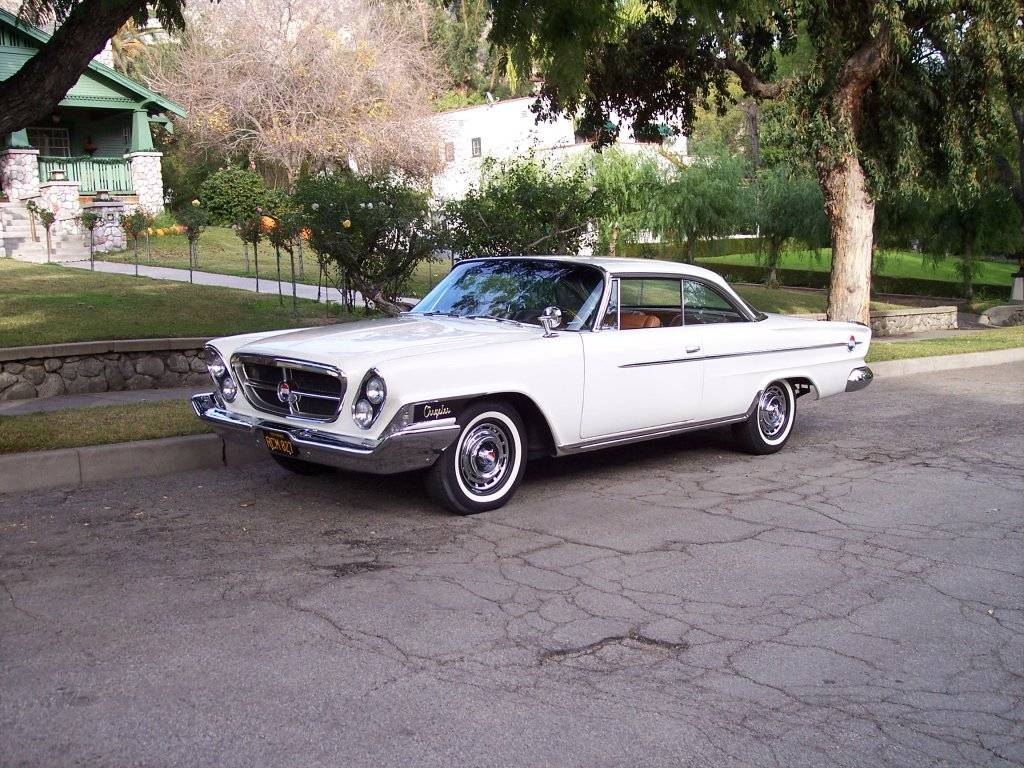

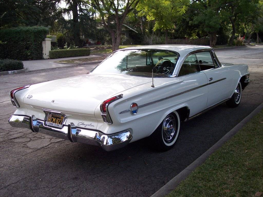

To help you feel welcome and at home, here are some views of my 300H. I love it even if it is a plucked chicken. I restored it fully in 1978 and it still looks just the same now since it has been a pampered car ever since.
Best wishes in the pursuit of your dreams regarding your new acquisition - it seems like it is a solid foundation for a makeover and to be loved by its new owner

hahaha - that should fix it, a little Holy water never hurt.. It was a close squeeze fitting both of those beasts in the garage... only one 9 foot door so one car sits sideways...
I can't open the driver's door on the Newport... I wanted to get a pic of the fender tag, but not yet, the laptop can not get a good pic... will have to wait till car runs and hopefully moves, not sure about the brakes, engine, tranny yet...

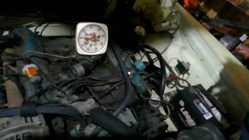

Well, as far as i can tell, my no fuel issue should be the fuel pump. I can suck gas manually from the tank. They have one in town... Going to get it, and putting some heat lamps and heaters under the car... still 0 in my garage.. really do not want to fire it up when the block is this cold, so will put some blankets up top and let the block warm up some..

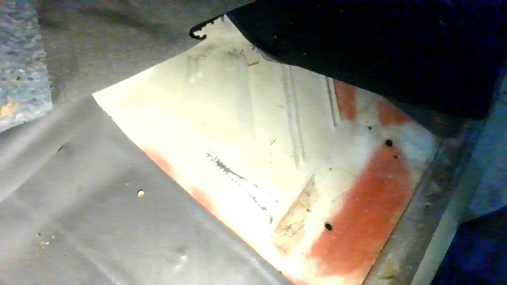

Also a poor pic of the floor pan.. P.O. ( previous owner ) already put down sound deadener but all the pans seem solid as nails.

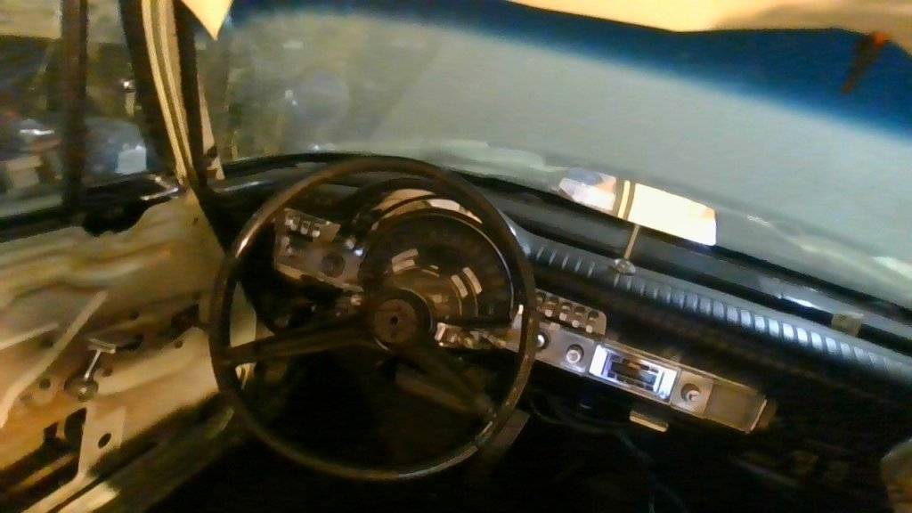

And the coolest dash ever ha
Sorry for the poor pic quality, its hard to hold this laptop backwards and keep my ugly mug out of the photo
Well, i got the pump on... squirted a little gas down the carb and it fired up... took a couple times, and some rough running for a bit, but then it smoothed out and ran ok...
i am not too happy as there is a light "knock" or tapping noise coming from the front of the motor it seems ugh

So the car starts and idles nice... all the pulleys are tight ( water pump etc ) there is a light tapping noise at idle... the gauge shows good oil pressure.. oil clean etc... water circulates , temp good.. no leaks...
I took a 4 foot hollow plastic handle from a paint roller ( like a mop handle ) and put it to my ear touching various parts of the engine while idling... i have heard of this but have never needed to try it before ( like a stethescope i guess)
anyway, it is AMAZING how this amplifies the sound... touch the alternator you can hear bearings whir, touch the valve covers you can hear the parts, touch the oil pan also can hear machinery churning...
When i touch the fuel pump the tapping is very distinct and amplified, and can hear it plain as day... ( beware of whirring fan if you ever try this! )
I just put on this pump, and it pumps fuel fine, old pump looked new, but did not pump fuel... tapping noise is very distinct thru handle to ear...
so fuel pump rod? or cam but motor seems to run good?
