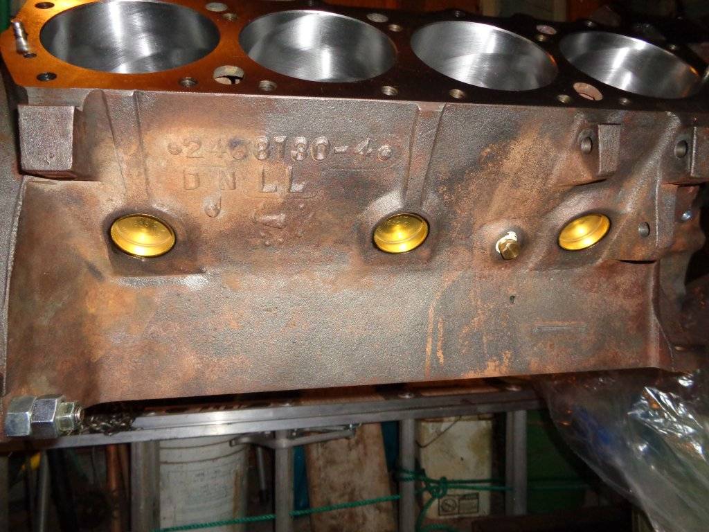

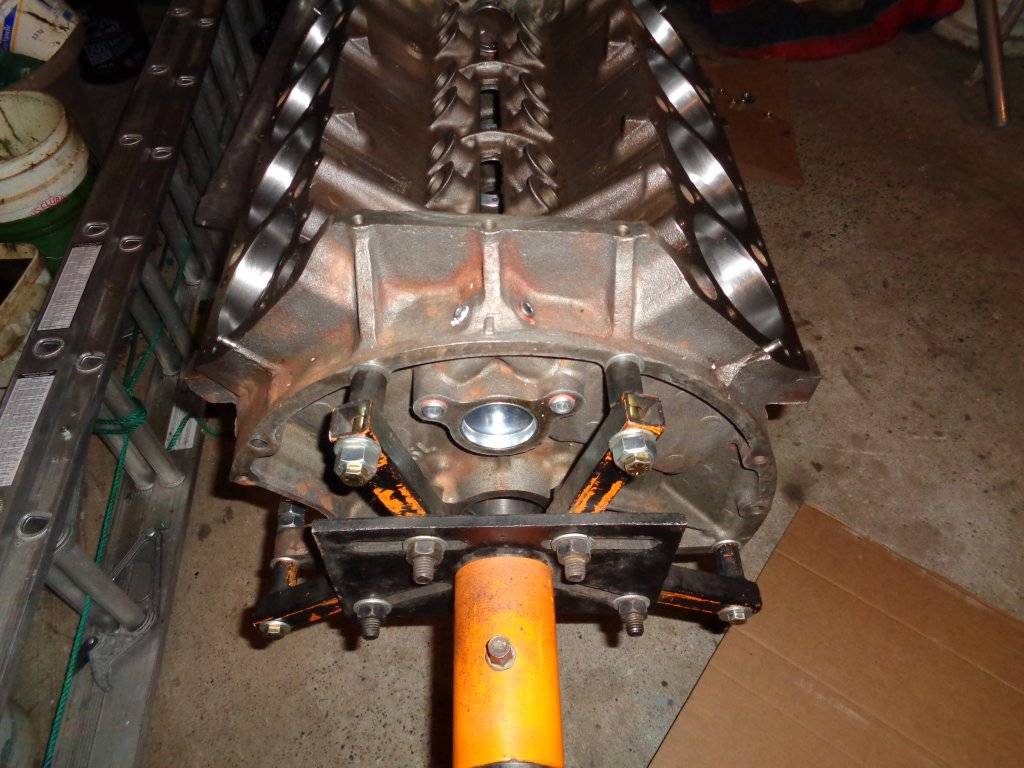

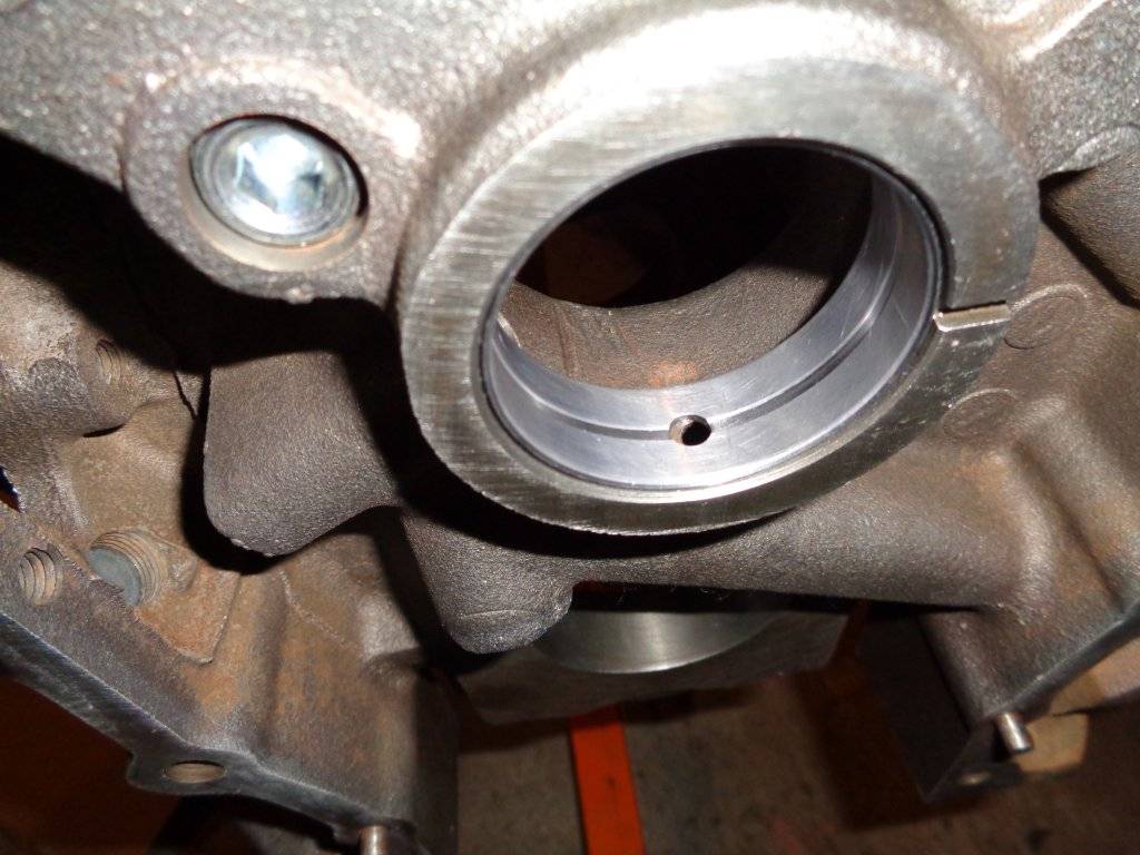

Took a few quick pictures. I'm a bit worried anout this front cam bearing. Is it something to take it back for?
$2800 you'd think it would be perfect. I was there all summer. lifter bores look untouched. not sure it thats good or not

Hey Cartel, I’ve talked to a few Engine builders and they said perfect cam bearing alignment is desirable but the 75% that is open like yours is totally acceptable and okay. There will be plenty of oil pressure and flow. As far as the lifter bores, did you pay to have them honed? If not, they should have at least checked to make sure a lifter slides in and rotates easily in each bore. Otherwise depending on which rings you’ll be running, the bores look good. Hope this helps.
#1 cam bearing looks bad but will work perfectly.
Check very closely the cam bearing further back with several holes is lined up properly.
Was a cam installed, and did it turn smoothly?

the stock cam did go in freely. the other bearings are dead on. maybe they do that to the front for some reason?

IMHO, the hole offset won't hurt a thing.
If it bothers you, you can open it up a couple ways, but you need to be careful and chances of things going sideways outweighs any possible gain.
If the front cam bearing bothers you, it will bother you. Is it bad enough to take back for a fix? Probably not. You'd have to buy another set of cam bearings as that's the way they are usually sold, possibly.
As long as normal pressure gets to that hole, LUBE will happen in sufficient amounts for good durability and such.

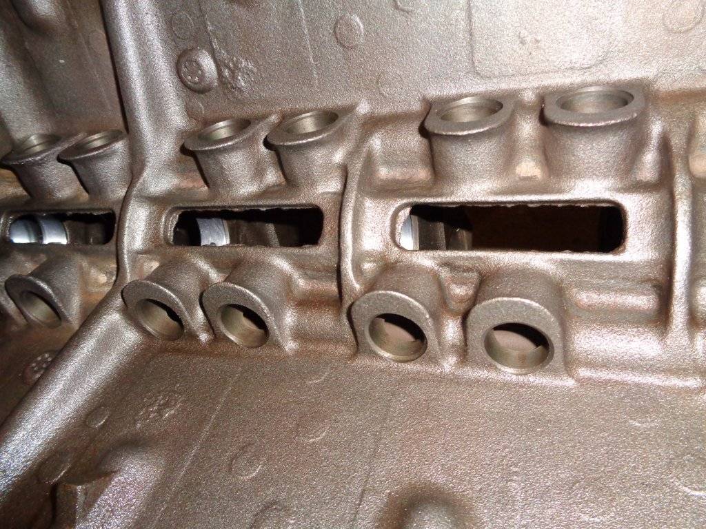

The lifter bores look fine, if it were my block I'd clean them up with some red scotch-brite and wd-40 to remove residual rust and dirt. Just make sure the lifters move freely in each bore.

I think the #1 cam bearing will give plenty of oil for any street or street/strip cam.

you don't want to hone the lifter bores just to hone them. too much clearance will cause low oil pressure at idle. the lifters should be checked to make sure they slide in before honing. they should have cleaned up the oil return slots a lot of rough metal that might break off.

ONE word of caution, as you have the block in your possession, be VERY careful about doing any further de-burring or casting flash removal on the inside of the engine. Same on using any ScotchBrite pads, too! These things can introduce grit and abrasive items into the mix in a place they don't need to be, especially after the machine work has been done and the shop cleaned everything they did, delivering you a clean block to deal with. At this point in time, consider all of that "good enough" as it was like that from the factory. Don't be potentially causing future failures, no matter what.

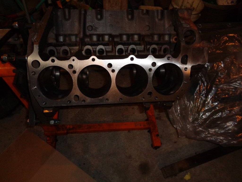

That slight offset on the cam bearing oil hole is a non issue as far as oiling goes.
You said you paid a lot for machine work. What exactly did you ask for, and what did it cost.

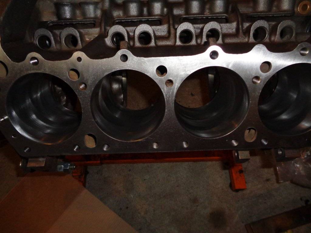

The decks don't appear to have been cut, which unless you just asked for the block to be bored, should have been done as a matter of course for general block prep. The full treatment would include squaring and setting the piston deck height, usually to zero for a flat top piston.

The deck is -10, cylinders bored 30+ Crank was polished and checked good at std. block was cleaned magna-fluxed, cam bearing and frost plugs, galley plugs replaced. supplied cam bearings installed. The block was also final cleaned and prepped ready to go. old pistons off the rods, new pistons rods and crank were send in from the shop for balancing. For some reason they didnt need the rings but 1 set of rod bearings. rods put on new pistons, supplied rod bolts were put on before all that too.
New bronze shaft bearing installed and burnished also.
the lifter holes I'd guess they would just scuff with scotch bright but I guess they were ok.
I still need to order a cam and lifters, heads and the rest of the valve train.
The shop did a great job, the block was a pig sty when I took it in and its pretty spotless. He supplied the plugs and the bronze bushing
