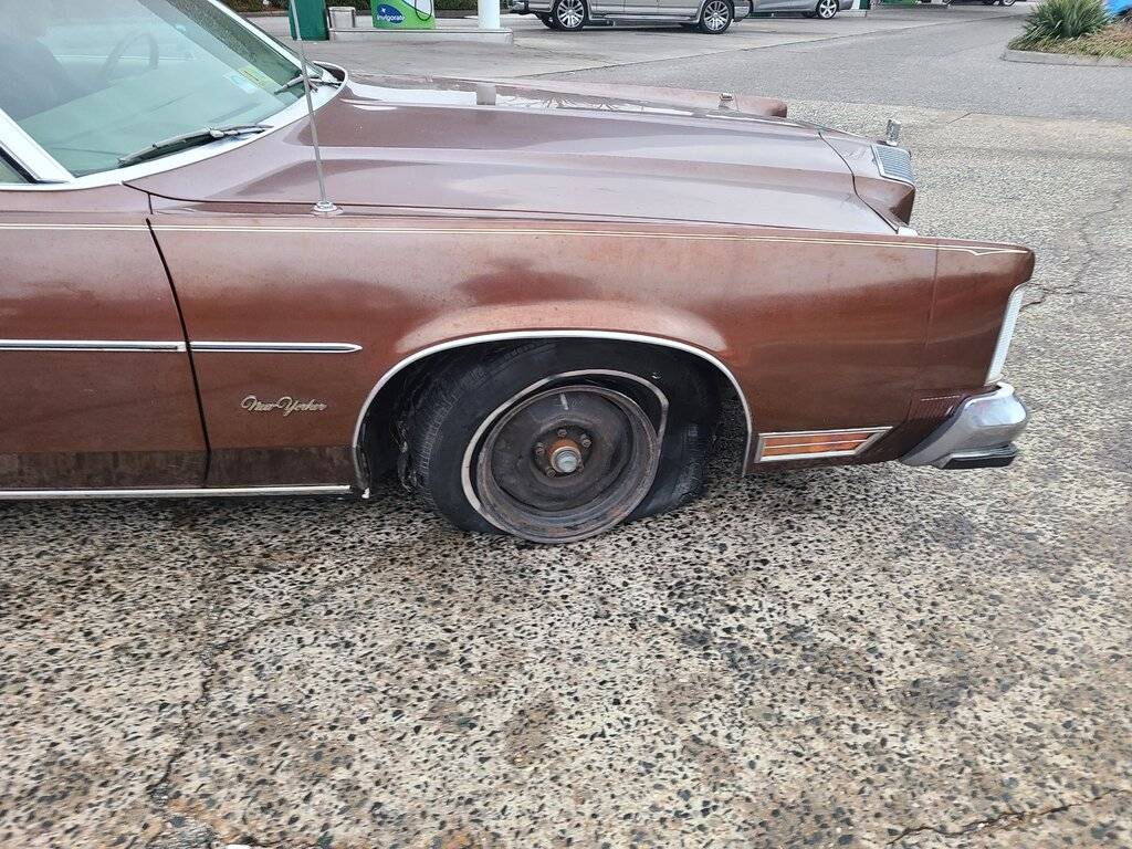

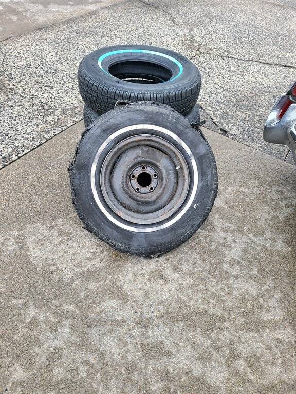

So, today, my dad and I started up the car and took it through the country roads with no issues on our way to get the tires replaced. Since the fuel tank was low, we planned to stop at a gas station on our way to the shop. So, until then, the trip was going well, until about 50 feet from the gas station. The front passenger side tire burst and the belt got completely destroyed, so we pulled into the gas station and inspected the damage, and a picture can be found below.

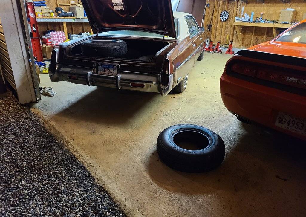

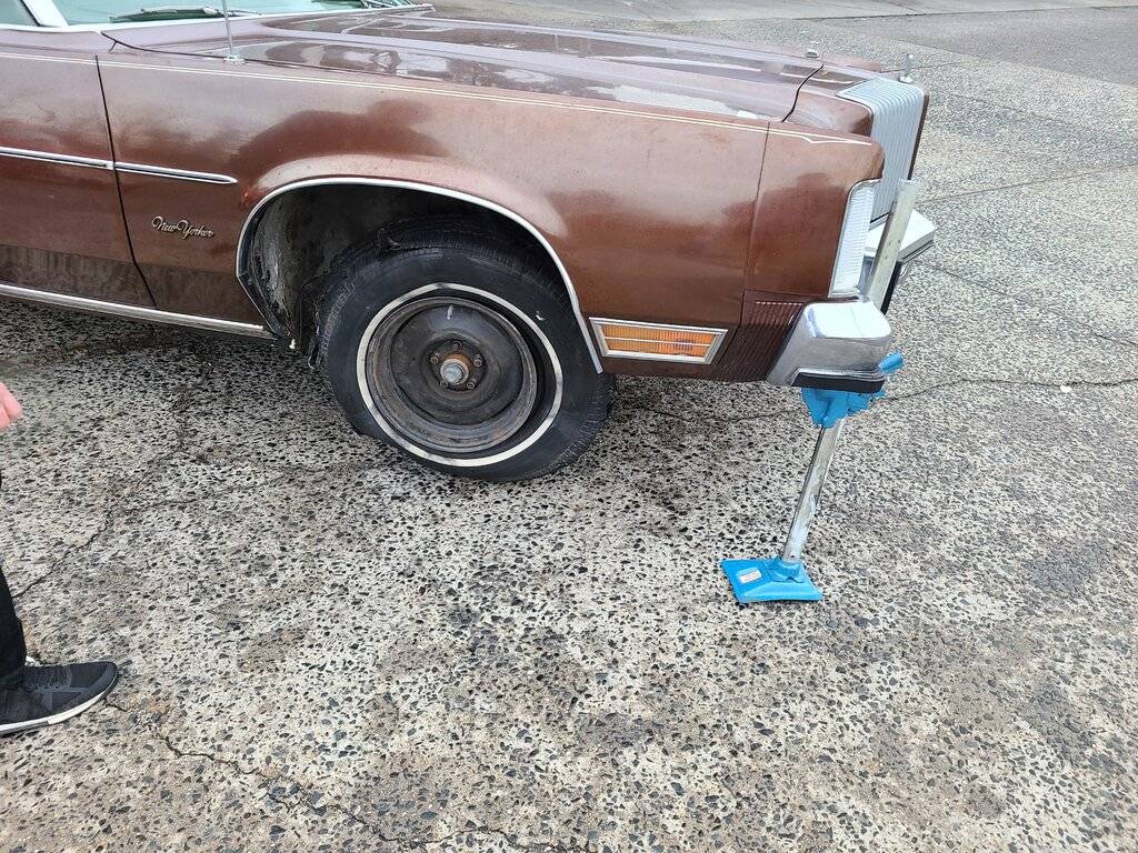

Fortunately, we had a spare in the trunk so we pulled out all the new tires and the original spare. Then, we pulled out the bumper jack and gave it a try. The bumper jack hook did not seem to line up with the hole in the bumper as the instructions on the trunk deck recommended, but we were able to fit the jack on a different part of the bumper and jack the front end up. With no issue, we were able to replace the bad tire.
However, we arrived at a problem with lowering the bumper jack. Since my dad and I have never used a bumper jack, we were not super familiar with it and we not sure how to get it down. We put the switch into the down position, but the jack did not budge. My dad then called my mom to arrange a ride home to pick up our traditional jack so we could use that to pull out the bumper jack and lower the car.
At this point, I was in the middle of a BP parking lot with my Chrysler jacked up in the air, so I was drawing quite a bit of attention. While waiting for my dad to get back, I loaded all of the new tires and the bad tire back into the trunk and was working on organizing the tires when a good samaritan came up, complemented the car, and asked if I need any help. I explained the problem, and he took a look at the bumper jack and explained that I was not pulling it back far enough to allow it to click and lower, which I did not do as it felt pretty tight and I was not trying to break it. Then, we were able to lower the car and pull it into a parking space. My dad got back with our jack about 15 minutes later and was happy to see the car back on the ground.

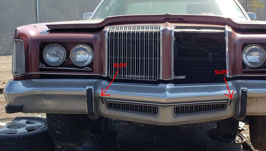

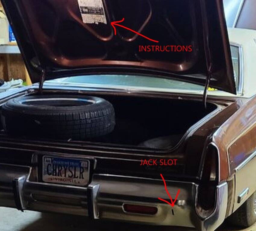

Glad you got it solved but for future reference for anyone else, read the jack instructions on the trunk lid if that is there or get out the owners manual for instruction to change the tire.
77newyorker440
Aug 8, 2020
513
283
Peanut State, USA
View attachment 436123 View attachment 436124
Ah, I never realized that those slots in the bumper were for the jack. I did use the instructions in the trunk but I could not tell where the slot was in the picture. However, the owner's manual was helpful, as it included some further info. Thanks for showing what those slots are for!

Those old factory jacks were designed for emergency roadside use only. They can be tricky to use.
Anticipate the car moving away from the jack as you raise it, place at a slight angle to compensate. just moving the lever to "down" is not enough to lower. One must jack it down, just as it was raised. (The instructions don't tell you that).
CAUTION! Never get under a car supported by a bumper jack, and do not place your hand on top of the jack stem while lowering.
