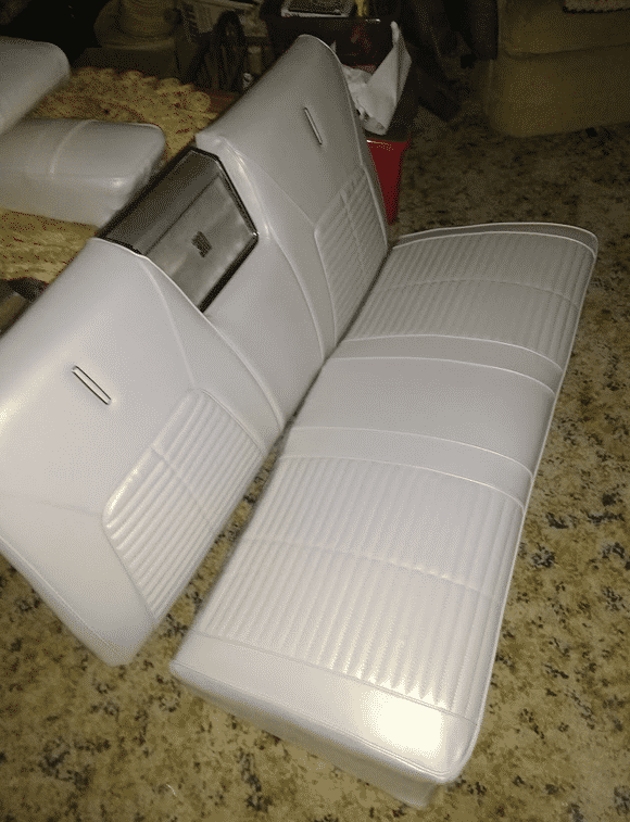

Still waiting on the front ones to be finished (very soon I hope) but I was so excited to get these back after 3 months I had to post a pic. Came out pretty nice I think. Oh, and the center console is done too. The rubbery covers that go on the center console pivot frame were pretty ugly so I painted them first with SEM Sailcloth White and then Herb's Pearl White over top and they match the upholstery almost perfectly.
Yep, the original foam was shot. The upholsterer supplied the foam, so I don't know precisely what he used. We provided the seat covers (from Legendary)

The rear seat foam isnt custom molded so its simply use 1in think I think it is by the yard.

Dunno, didn't get the bill yet. But this guy is pretty well known in the local area for doing this kind of work so I'm going on faith that it's going to be a fair price

Seat foam is measured in density. Find a local supplier of the foam, (upholsters have to get it somewhere), and go for a visit. Rule of thumb when buying foam is that no matter the thickness it should be firm enough that your knee doesn't contact the surface the foam is on when you kneel on it.
You can even combine different density foam. A thin, very firm base and a less dense and softer top layer glued together.

Thanks for this. My Polara has the same pearl white interior and the side panels look a little drab against the new upholstery. I was thinking about doing what you just said. Thanks for the brand names.

Seats came out great! Congratulations. :thumbsup::thumbsup:
