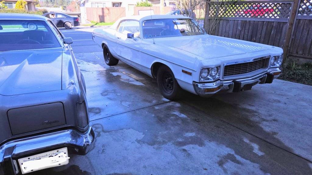

Edit- oh and here's a photo I'm picking her up this week

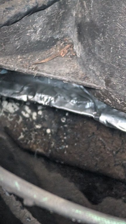

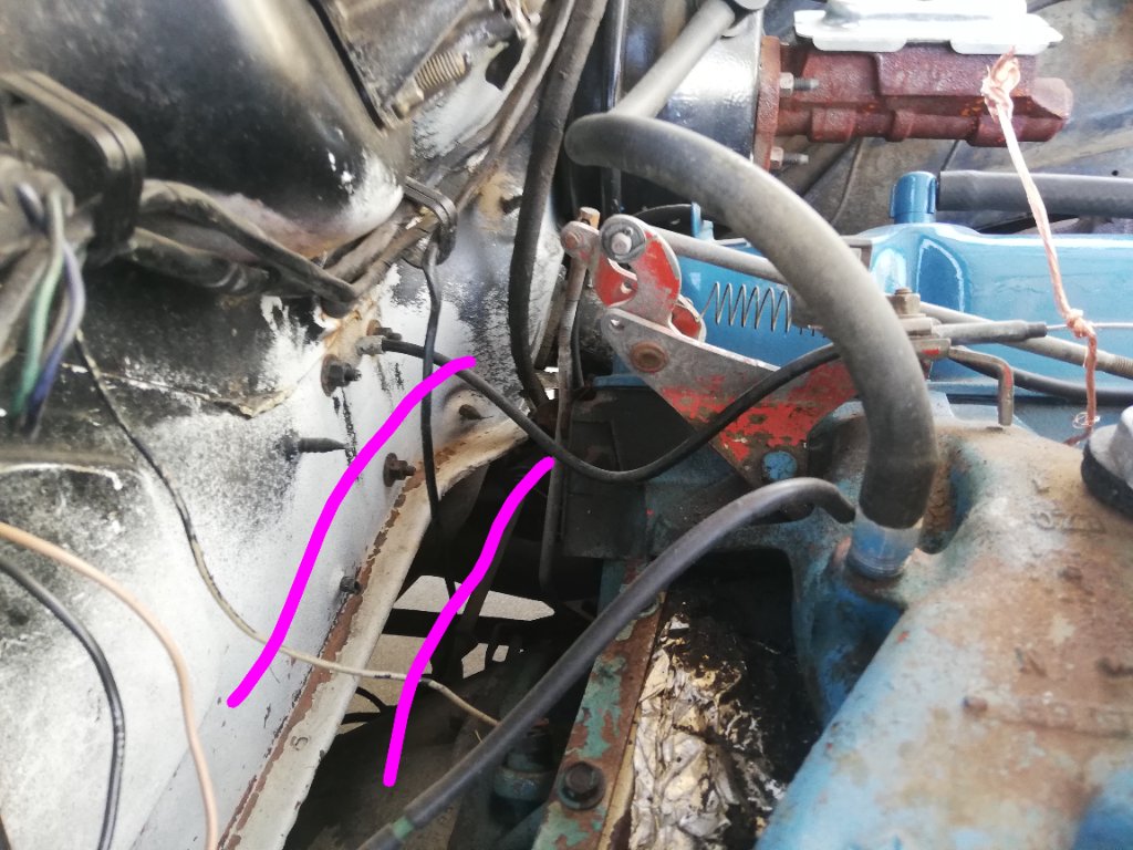

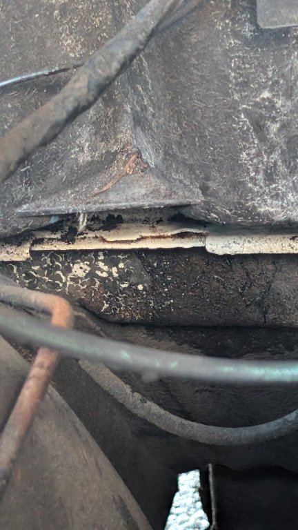

There is a pinch weld that runs the length of the firewall, it's a little ledge that water will sit on. Over the years it will find a way through the two pieces of metal pinched together. I found this out once after checking everything else. Also, that's a 1973 Polara.

That pinch weld sounds like a distinct possibility, is that easy to access and maybe get some silicone on, or is that a essentially a huge PITA I'll have to live with?
Fluid changes will also be first on my list, once it's in the air I'll have a look at all the brake lines and fuel lines, that's good information.
The pinch weld is quite accessible, I used a small wire brush and a pick to prep and brushed on a thick coat of rubberized undercoat, really pushing into the crevice and then creating a bit of a bead in the little V channel. As I recall there were a couple of notches in the upper stamping that seemed to be the problem areas.
Well I got her home today.

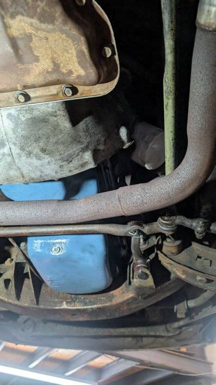

Stopped off at marko's place and we referenced his Plymouth and looked at some areas I can start working on such as getting to the seat bolts underneath to get those out and get the carpet out. He's also got a good idea on how to easily access the blower motor and replace it if necessary, but first I'll try pulling the switch assembly and checking the contacts.

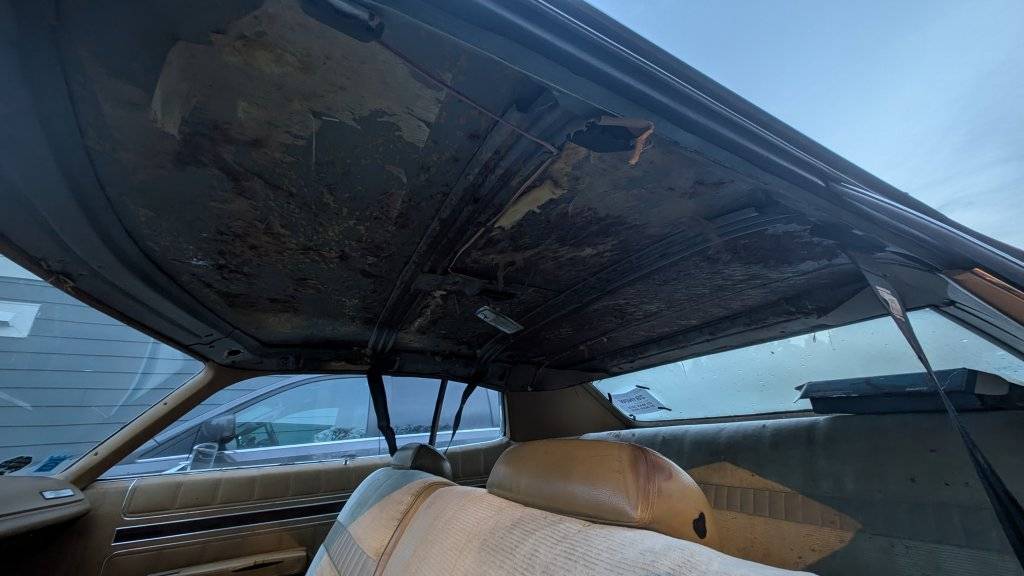

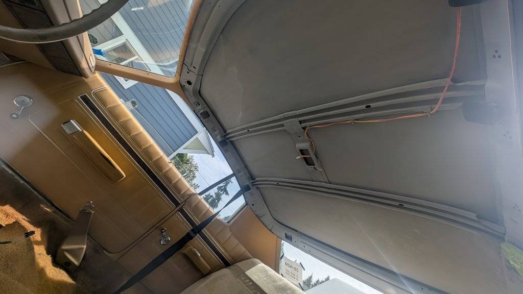

Headliner has to come out it appears to have had critters.
Then just the idler arm and some new fluids.
The wife is royally pissed to see a project car in the driveway and I will be sleeping in the shed tonight next to my lawnmower.
It's great to have found both the forum and a fellow enthusiast in the neighborhood to draw upon the knowledge base.
Here she is next to marko's immaculate New Yorker.
Got the cruddy, disintegrating, mouse pee-soaked headliner out yesterday. Think ill just wire wheel, acetone, and rust encapsulate the inner roof for now. I'm not really too big on the idea of "restoration", I don't mind the rough project car vibe. Maybe one day a new headliner can go in but moreso I just want it clean and dry in there. Carpet is next. That is salvageable and I hope to keep it.
