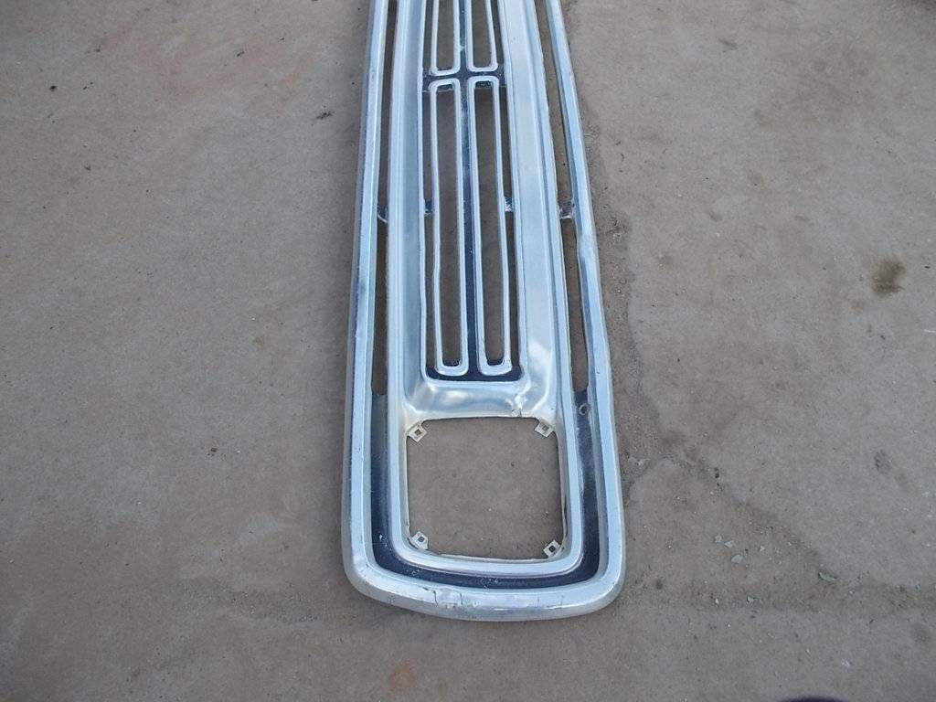

I'm wondering how hard it would be to clean up these dents on this grille. Don't want to drop a lot of coin if I have to restore it, I can do that with the one I have. Can the dents be worked out and the grille then be polished? My friend has a buffing wheel and compounds so I can do that.
Yes sir, an elusive 72-73 version. I got it off my friends Grandpa's truck that we pilfered the 360 and drivetrain from. And any other usable parts, like the bumper also!
I guess that's anodyzed aluminum ? Polishing will remove that layer and it will be prone to mist up and Need repolishing from time to time. You get at least acceptable results with straightening out the dents with some TLC; stainless is much better to work with.
First off, some of our guys were going to "polish" their aluminum trim on their A- and B-body cars. With a buffing wheel and compound, it took forever to get THROUGH the anodized layer and to the base metal, but when there, the trim polished-up nicely and looked like stainless steel trim. BUT, once one piece was done, had to do the rest to match! They said "Never again!"
As for knocking out the dents and such, just like any other piece of aluminum, although the anodizing seems to make things harder. Might need a little heat, but not too much? Then sand and smoothout, then some polish. Seems like I saw some "clear anodize" spray from VHT several years ago?
You CAN paint on top of the anodize, as many did to touch-up the flaking factory black moldings on '77-'81 Z/28s. Didn't do too well, even when they sanded before paint, though.

The anodize is removed very easily with chemicals like original EZ-Off oven cleaner or even straight Purple Power degreaser. Dents are easy to work out, patience is the key word though so as little file work as possible to smooth it back out. No heat needed, the aluminum is hard from age, but not so hard it can't be easily worked.
I've straightened and buffed a lot of stainless and aluminum and believe me, it's not rocket surgery. It's just taking your time and thinking about what you are doing.
The original anodized surface is gone, but it just takes a little more care to keep the surface from oxidizing. Some guys have done clear powdercoating over the finished pieces and that seems to work. I tried some clear lacquer and wasn't happy with the end result, so I just keep it polished.

If you try, the old saying for dent removal is "first in, last out"... Do not work from the deepest part, but from the edge of the dent.

Thanks for that "removal" information! When our guys were trying find a way to get rid of the white-milky tint the windshield moldings had acquired with age, the best course they could figure out was "polish" with a buffing motor and such, like other metals. This was about 30 years ago. Obviously better ways to get there, now.
