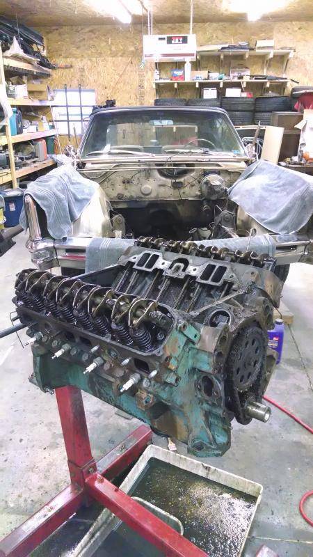

I got the engine and transmission pulled today, everything went smoothly had the engine mounted and the transmission separated within an hour.
Never used an engine stand before what a wonderful thing.
time frame is April 1st that may be kinda tough working Saturdays and Sundays. The whole front end needs rebuilt, dropped the steering off today to be rebuilt.

Ok I have made my decision on my engine. I know several of you will disagree but I am not going to tear the engine down and rebuild at this time.
Here are my reasons why. After looking over the engine we could find no bearing wear anywhere on the lower end. What we could see of the cylinder walls they look great and are smooth.
One of the biggest reasons why I'm not rebuilding at this time, because when I do rebuild I want to upgrade several things and not just keep it stock. I want it to look stock but not run that way. That is definitely not in the budget now and won't be 9 months from now either.
Another reason not to rebuild now. What am I going to do next winter??:thinker:
Seriously I hope to rebuild the engine a few years from now and build it exactly the way I want to. I can pull the engine in a weekend, so it doesn't seem like a big deal to me, practice make perfect. The winters are long in cold and this is part of the fun.
I respect your decision but it's easy to pull the motor now, not so easy to pull from a freshly restored engine bay. The hood must come off and the design of the motor mounts makes it difficult to mate the trans and line up the mounts. All while trying to not scratch anything. I hope I'll never have to do it again. That definitely was not part of the fun.
I see where he's coming from, but I agree with your decision. The engine ran fine before you pulled it. You pulled it anyway, and opened it up to inspect it. It inspected fine for everything you could check. No reason to go further if upgrades aren't in the budget.

My plans are going to rely a lot on the input here. I only have enough knowledge right now to make me dangerous and that has all been gained from this forum. It has been suggested to me get a set of open chamber heads like a 452 or 906, so I am thinking along that route and maybe a mild cam too.

I think you have a good plan I would put a roller timing chain in now and it will still be good when you go back in, very easy to put on where your at also head gaskets I know heads are on in pic did you pull them the steel shims are coming up on 50 years old and if heads are off make sure to check timing marks for accuracy dial indicator on #1 at tdc makes tuning sharp even stock, I'll bet you a beer at the nats that they are not accurate. My 2 cents keep us posted.
