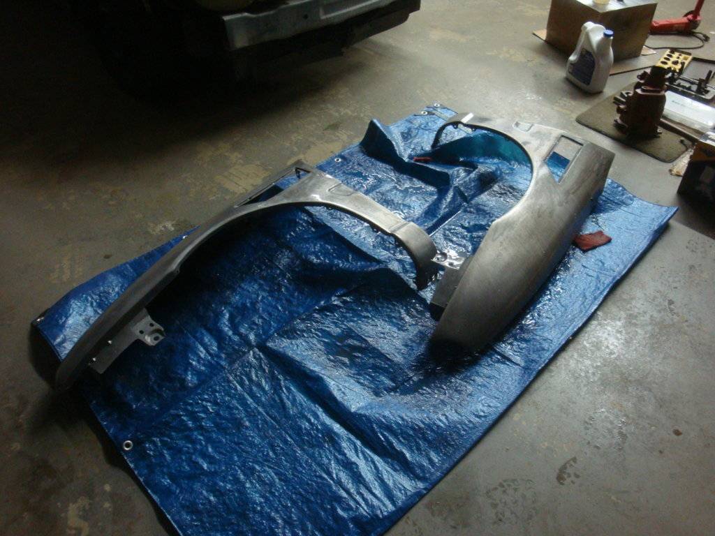

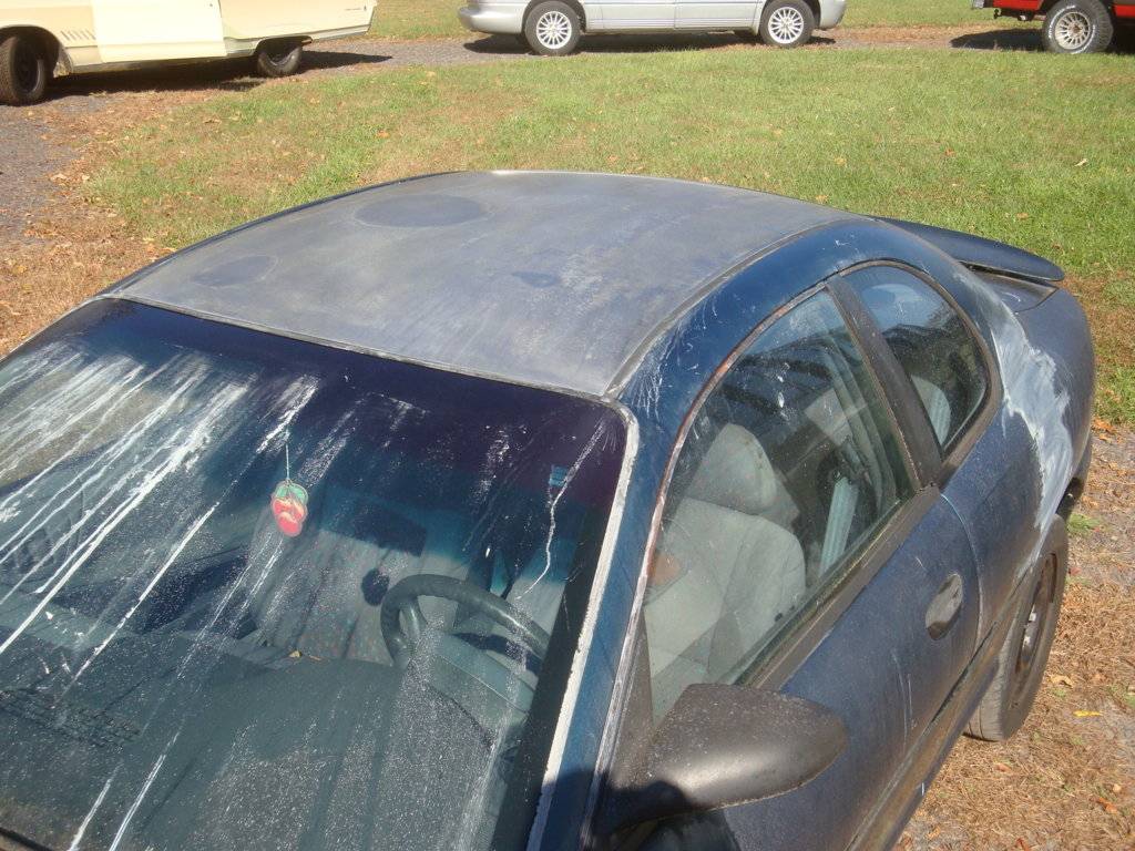

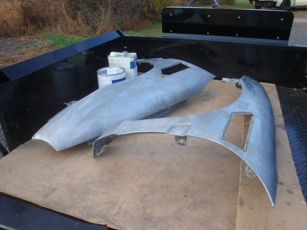

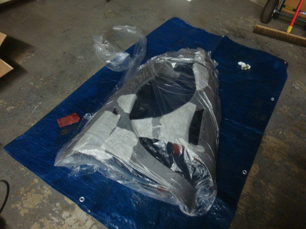

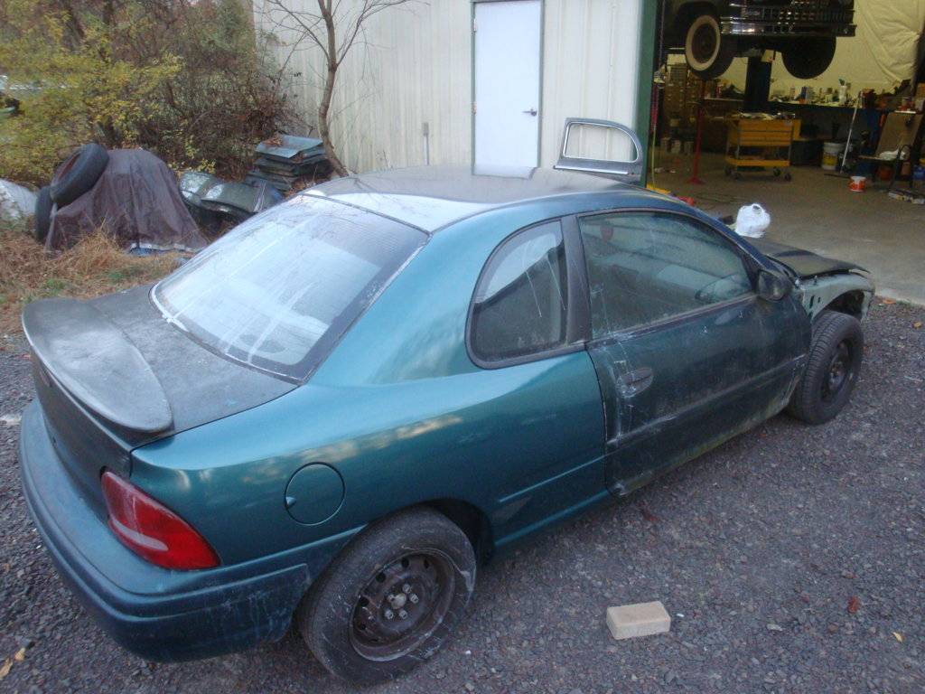

I did some surface rust removal on this Neon for a customer, though I can't remember what product I used. I think it was either the stuff from Hirsch or Safest Rust Remover. I'll keep wetting it down while I find something else to do between spray downs. On this car the rust went in really deep, since it was salt air rust. The spots that still weren't clean by the end of the day got soaked paper towels, and I covered everything with plastic and let it sit overnight. I was doing this in late October, so it was fairly cool and the chemical process wasn't as strong as it would have been in warmer weather.

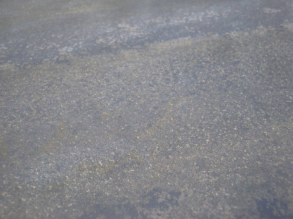

This is a close up of the roof panel. You can see how deep the rust pits went. After you wash the surface with water, you'll usually get some orange staining that looks like rust, but it actually isn't. What you are looking for is that it's no longer dark brown or black down in the rust pits.

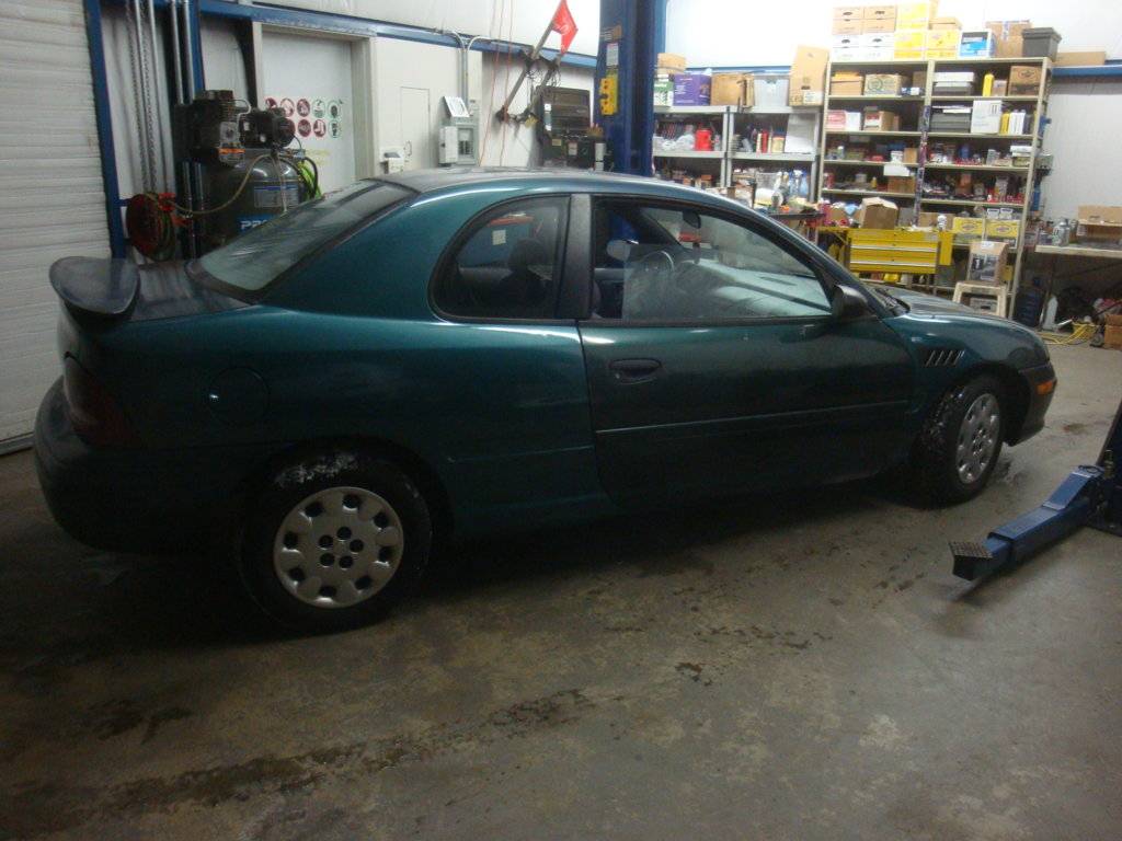

This job was just a preservation, so I painted the panels with whatever paint I had left over from other jobs. The roof ended up silver, and I had enough green to do the fenders and quarter. I never did take any decent pictures of the finished car, just a few in the too dark shop.

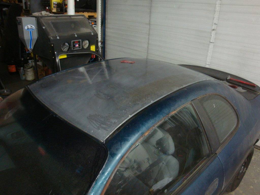

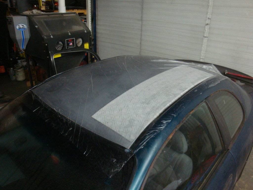

So I tried what I could find locally...it did ok...removed all the surface rust but not the hard stuff. I went over the entire roof with 36 grit feathering across the hard rust and removed the actual rust layer. I still have a very black surface which I found to be a stable low oxygen rust that actually prevents oxygen from getting to the parent metal. From what I understand, I can paint over that. FE3O4...it shouldn't spread as long as I get it covered soon. I will clean it again really well to get any rust dust off and media blast it to get into any pits then epoxy it. It should last decades.
You didn't mention that you had a blaster. That would be the preferred way to deal with the rust from the start. What kind of blaster and media do you have?
You should be able to do all the rust on the roof with that set-up, as long as you don't go too high on the pressure. You always need to be wary of warping sheet metal when blasting. Anywhere near the edges of the roof, there's no concern at all. As you get about 3 inches or more from the edges, then you'd probably want the pressure down around 80 psi at the compressor, maybe as high as 100 depending on the pressure drop to the blast gun, and hold the gun back a bit further from the surface. Blast first, then follow up with the rust remover chemical to get way down in the pits.
The coal slag took off the black rust without damaging or warping the metal. Got it primed last night. Have to go back today and use glazing putty to smooth some small spot out, but I should be able to get another coat on and get it painted over the weekend.
