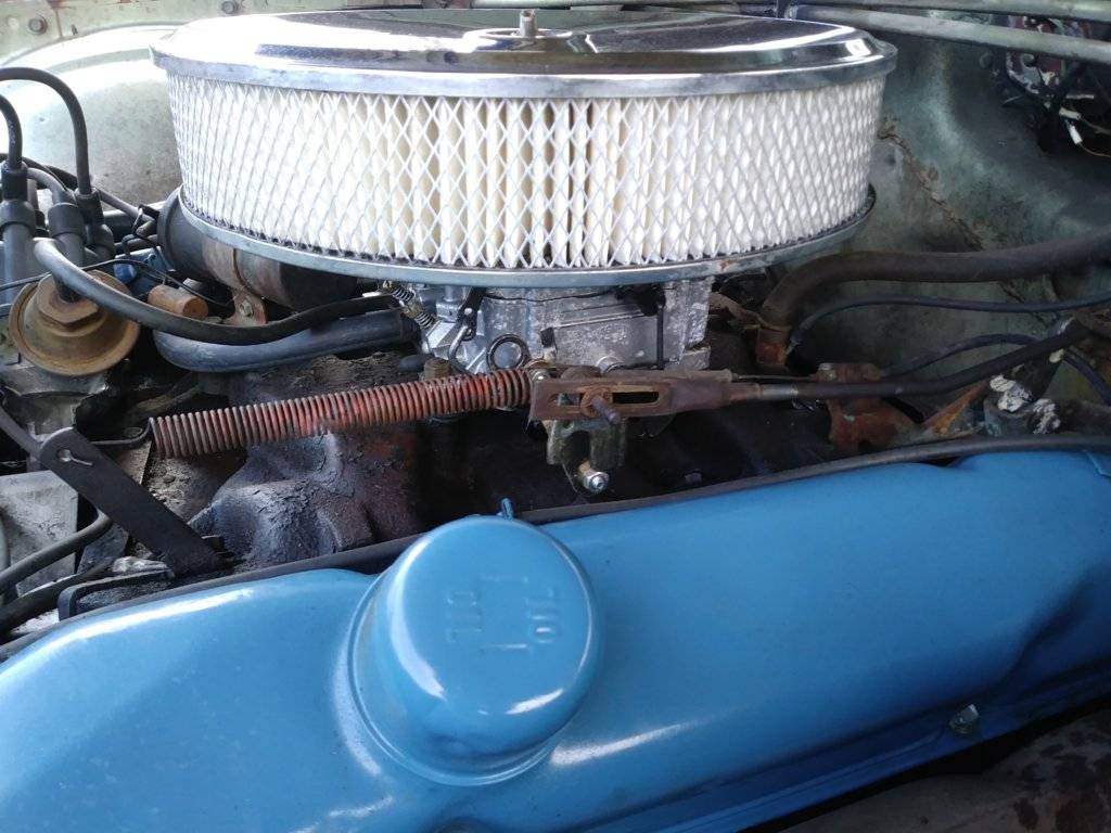

Looking at pictures of the setup...I think I might be missing a spring too...Don't remember there being two on it but can't tell til I get home. Will try adjusting and see what happens. Also have to check the fluid...can't remember if I checked it already.
Yep....missing spring. Will start there and adjust.

I believe if memory serves me correctly without having to search through many engine pics that this rod is upside down. Carb bracket maybe incorrect that's why rod was installed that way.
Ok if my memory serves me correctly.....

I have done a few 2bbl to 4bbl conversions before, but have a large box of misc rods and linkage form parts vehicles over the years to draw from. I also will cut, bend and weld if I need to extend a rod or ???
My guess why that rod is upside down is that it is for the 2bbl cab and would have been mounted on the other side of the bracket and in the correct orientation, but that would but the mounting point for the kick down on the carb in the wrong spot, hence the flipped rod, at least it mounts up now. But you may not have enough adjustment to get things set properly, looks like it's threaded out almost all the way now.
