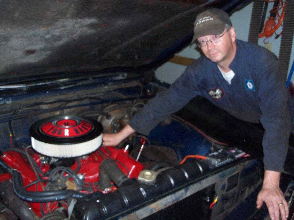

I have 452's on a 66 300 383 with a 68 301 cast intake. Works great!
Regardless of head casting the rebuild cost will be the same so do hardened valve seats.
Keep in mind the 915's will increase compression which will increase the chances of detonation on todays corn fed gas.
I personally prefer the 452 heads that already have hardened seats.
With a good 3 angle valve job and with some porting and gasket matching they will flow better than the 915 and no ping.
