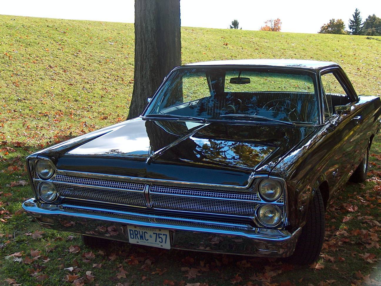

Sorry for this ridiculously late reply to your post - I've been busy working on my other car, a 64 Fairlane 500. Here's a pic of chromed aluminum on my 65 Fury - you can enlarge it for better details. It should be noted that in the process of chroming aluminum a good shop will apply a layer of copper first and that's why the cost is higher. On the other hand you end up with bright chrome on the front and a protective layer of the same substance on the rear making it a one time process. The first thing you will notice after chroming is that the weight of pieces literally double and are very rigid. This is truly a worthwhile undertaking.

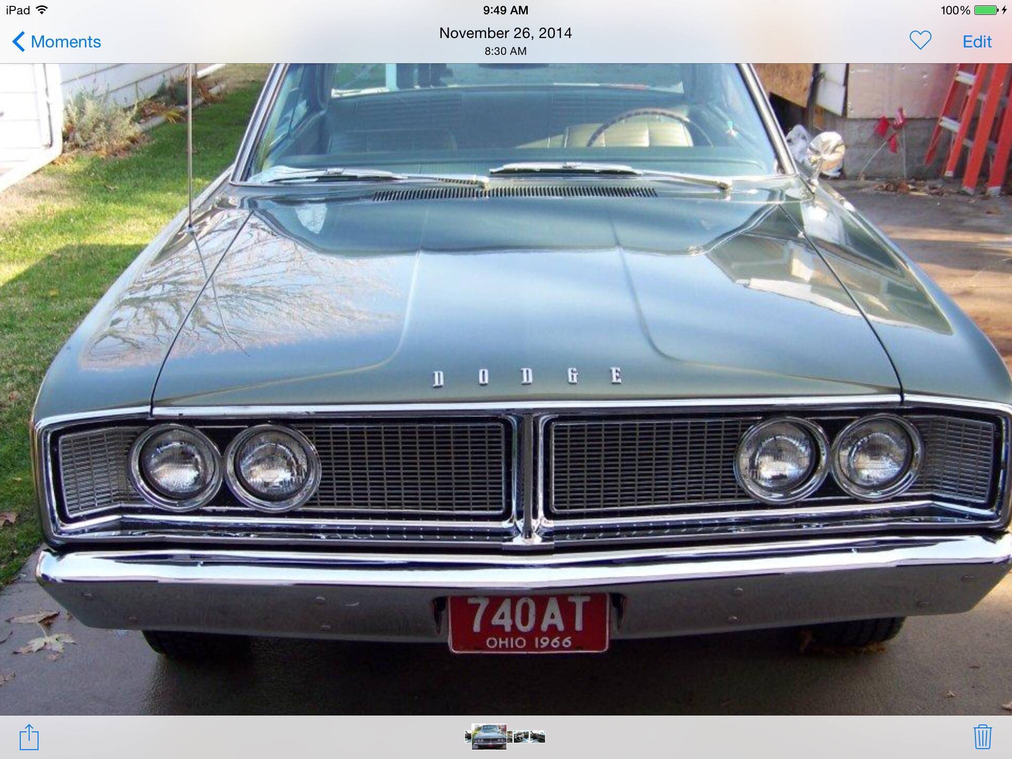

The anodized grill on this '66 coronet has been chromed over 15 yrs ago and still looks fantastic, I like the chrome much more than the anodized look and much easier to keep clean

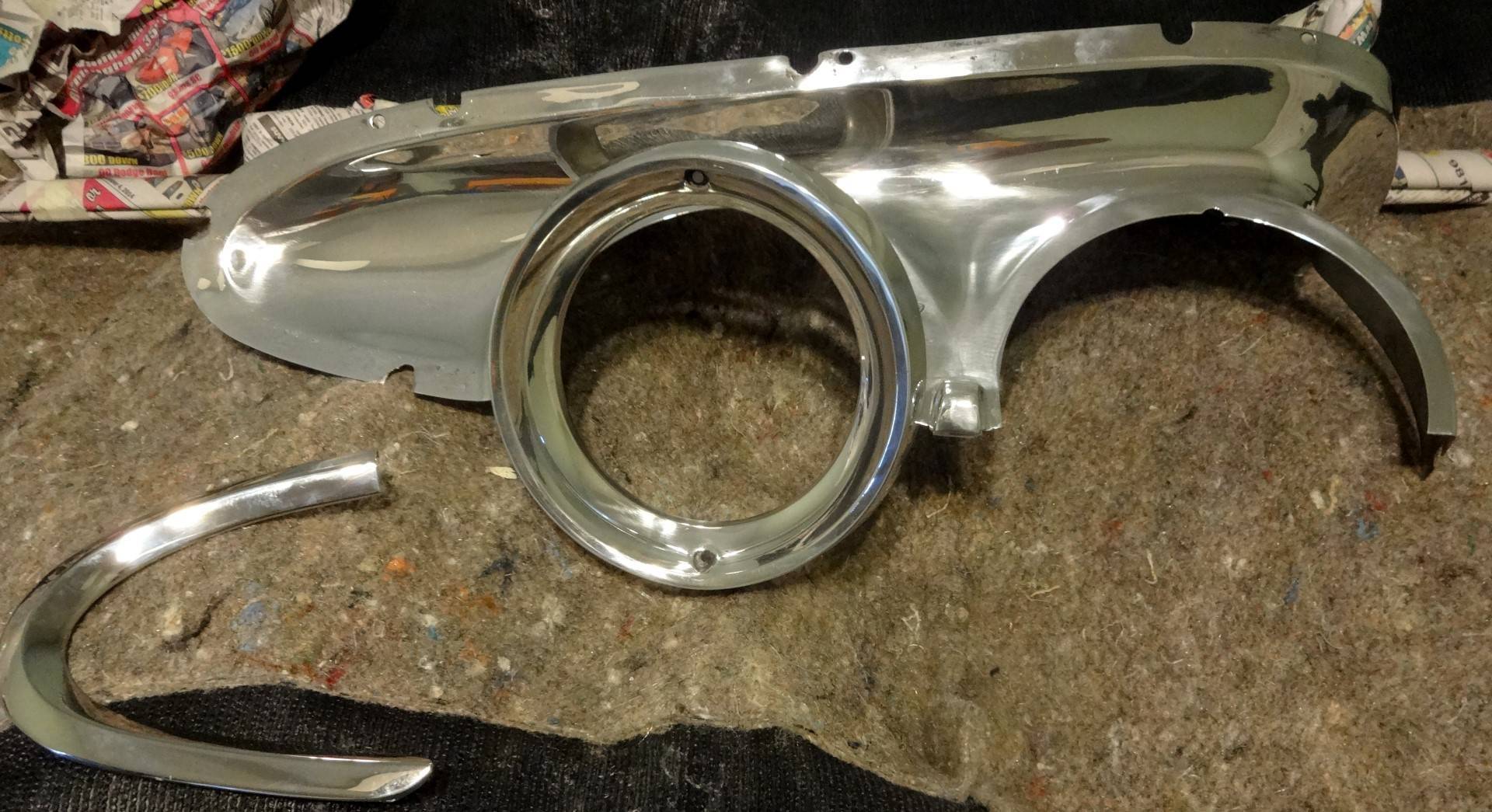

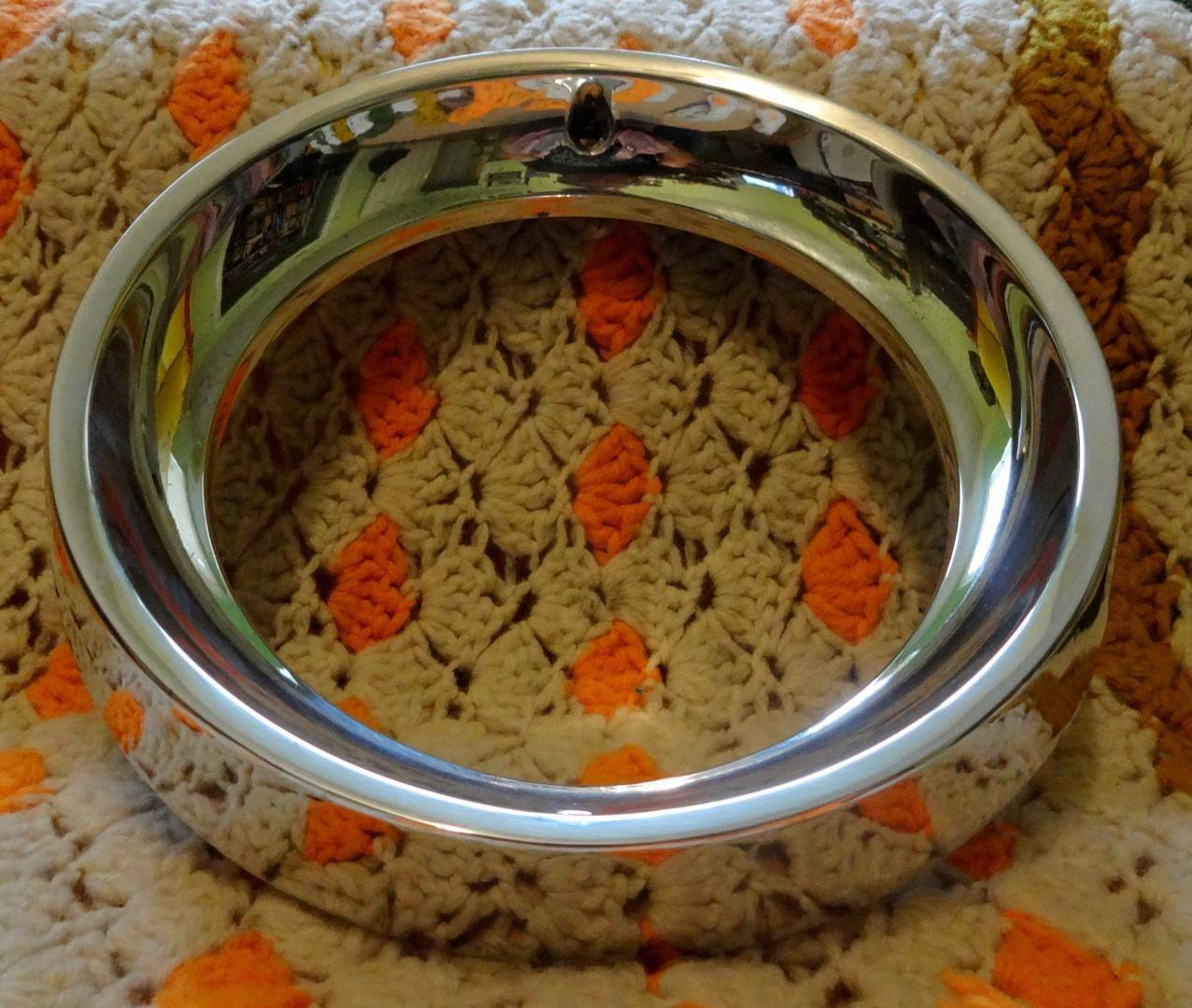

Here are photos of some pieces he has done for me.
Thanks for the pic. Looks great! The added weight isn't a big concern but how the pieces fit after with the added metal might be a problem.
