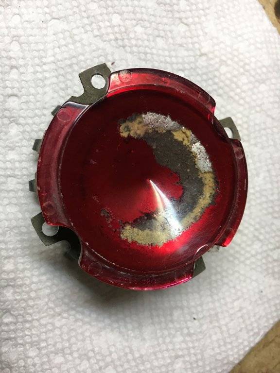

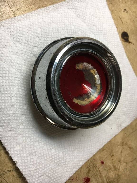

Looking for tips on restoring the red center cap plastic on this wheel
The red and silver paint has peeled of the interior face where a gasket behind it probably caused the damage from water and salt
The original paint does not come off easily, I have tried brake cleaner and laquer thinner, but it did not work. Would sanding with 1200 wet and dry work with no real damage?
I plan to repaint the cap face with a similar dark red metallic auto paint and polish the front face when done.
Any suggestions as to old paint removal and new application would be helpful.
After you get the paint off, lens polished. you would get the red in a semi transparent, then spray the red with a chrome paint. get the depth and shine.
Wet sanding increasing to a polish for paint removal should work.

Tamiya makes a red that's semi transparent. Spray a few light coats and then spray a silver coat. I'd use a Tamiya paint for the silver too... Just so there's no issues.
A well stocked hobby shop should have this, but if not, there's sellers on eBay or Amazon. They also have a version for painting lexan, but I would stay with their paint for plastic.
ITEM# 85074
TS-74 CLEAR RED​
Spray TS (Plastics)
A good while back, when model cars were kind of still a bit popular, one of our Mopar club member bought a Road Runner, but they didn't offer the car in the color he desired, so he repainted it. How to get the old paint off? He decided to use brake fluid. Did not attach the plastic a bit. Then he washed the plastic and began the re-finish operation. Came out pretty nice.
With those wheel emblems, you do everything from the backside. Kind of going in reverse order than if you were doing a normal paint operation. When done cleaning and polishing the outer portion, give the outside a good coat of silicon-dioxide "nano-wax", which will shine things up more and offer better protection.

Brake fluid did not cross my mind, but I think I'll try that first.
Thank You everyone for your suggestions, I will post more as I progress.
Vlad
I do not recommend brake clean or any harsh solvents on plastic at all. Especially vintage plastic like this. No telling how it will react. Brake clean only usually works on paint that it can dissolve, like alkyds.
Brake fluid might soften the paint but it will take a while, probably overnight. Do a small test area first.
Well, I got all excited about the brake fluid method and tried it.
73 Coupe, you were right !
I tried it on a already broken piece and here is the result
The brake fluid did remove the paint but the plastic did not survive intact.
So, live and learn, on to the next method
I should add that I tried 3 solvents first, Brake cleaner spray, laquer thinner and a grafiti spray to no result, so it's possible that could have affected the result.
