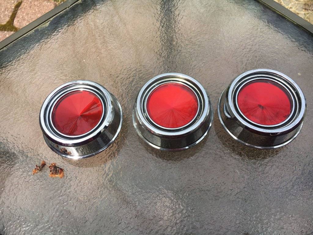

First, want to thank Marty Mopar for sending me a new NOS cap as I was not sure how my efforts would pan out.
But I do have the final result of the restoration.

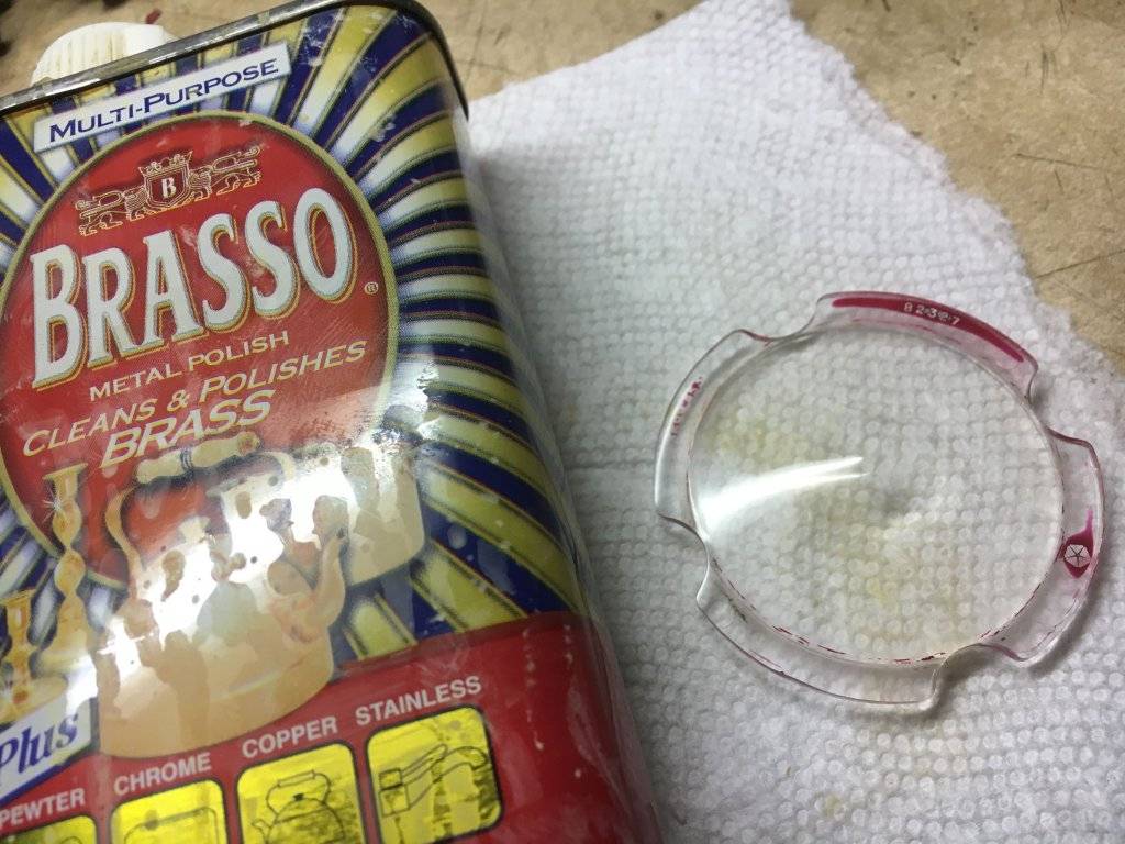

I sanded the good plastic center with wet and dry 800 sandpaper, polished it with Brasso and painted it with 3 light coats of Tamiya TS-clear red (thanks to Big John),
2 coats of Krylon metallic silver.
The 3 center caps above show the result...left is the new NOS cap, middle the restored cap and right the original which shows some wear
