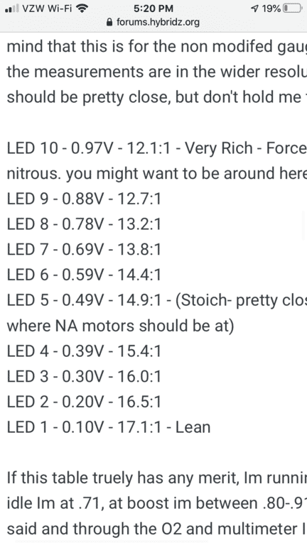

Here Is a chart I found online (everything is true on the internet)
Sure how accurate it is.
