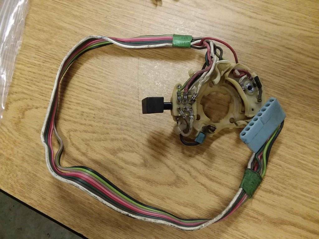

That is what it looks like, but I am quite apprehensive going into that job, seems pretty serious

Hazard switch is broken. Is there a way to disconnect it from the wiring, so you can see how the lights perform without a shorted hazard switch?

As I seem to recall, the button on the hazard switch attached to a C-shaped piece of plastic which overrides the turn signal's contacts (or possibly adds to them, considering the separate flashers for the two systems?). If you can pull ot out to the un-engaged position, squarely, then it might put things back to normal?
Pulling the steering wheel is not as onerous as it might seem. Just need a lock plate compressor and steering wheel puller to do the deal. Might be able to get those things on loan from a local auto supply store? Past that, it's just a somewhat simple process to disconnect the wiring harness near the base of the steering column, attach a wire to its end, then pull the harness out from the top . . . reverse to reinstall. Getting the main connector to turn sideways to be removed and then similar to reinstall, using the "pull wire", it all works reasonably well. Check the FSM before doing any of this so you might know what you're looking at when you see it, for good measure.
Once the lock plate is compressed a bit, it will reveal a small round-wire clip in the recess in the shaft, which keeps the lock plate in place. Use an awl or small flat-blade screwdriver to dig it out, carefully. IF it might fly off, just get a normal paper clip and bend and snip it to fit. Been there, done that on my '70 Monaco Brougham. The clip is the same as on the GM Saginaw columns, but I suspect that FEW if any GM dealers now stock something like that, but it might be in the HELP Rack items at the auto supply or via Dorman products.
Be advised that there is also a "master spline" (wide) at the "high noon" position of the steering column shaft (when the front wheels are in the "straight ahead" position), which mates with a similar item on the steering wheel's splines. Align those when you get ready to put the steering wheel back on. Might check for the torque value of the "nut on the steering wheel", too.
Next thing is to find a quality turn signal switch for your car.

Thanks, Willis
Then I'm understanding the formal turn signal switch assembly still looks like this fuselage unit. No way to disconnect hazard.

I believe the earlier switches had the separate contacts, but perhaps that changed somewhere. Or they were consolidated into a different configuration? Sorry for any mis-understandings I might have.
