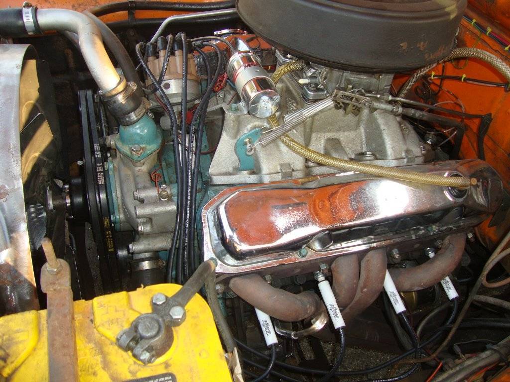

had b e body headers on my 65 880 rag , but it was a 383 . going rb so i'm sure they still will . seeking more ponies ? and that sound of the tubes putting tone is very cool . and for the next step is to rejet for them . i put 7 percent more jet and rods in my 383 in my 64 d100 383 from iron hp manifolds to headers . and note a spark plug boot change to ceramic tipped wires . pic of the 383 hp d100 . has some overlap in the cam , headers glow red with heat pulse .
