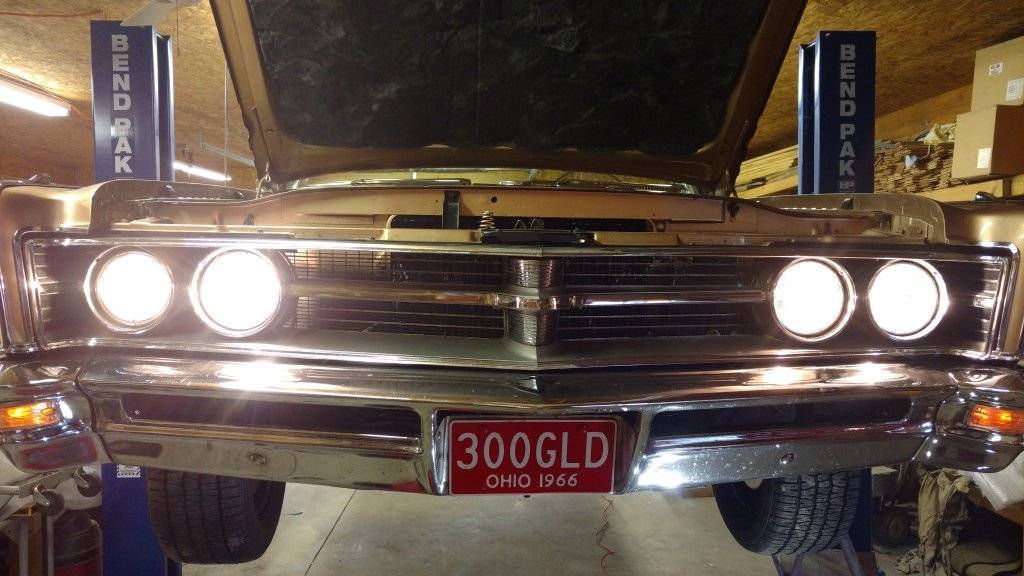

I bought these relays over 3 years ago. I started installing them and didn't finish for some reason. In he meantime my computer crashed and lost contact info and directions.
I decided today would be the day. I seeked out some help on he FBBO site, which is where I initially where I contacted him. I basically figured it out once I started laying it out.
I will give a side by side comparison next time I have it out after dark, but could tell already they are definitely brighter.

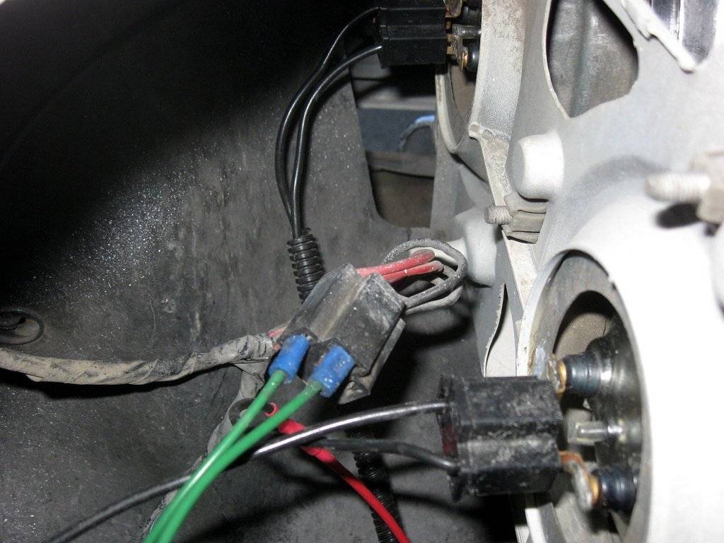

When I was looking for the original directions I noticed you were interested in the mod too, but it is too funny that you haven't installed yours either. It was really easy, I remember I spent most of the time hiding the components.
I've been fairly happy with the stock brightness once I removed the after market eyelids with B/N headlight bulbs but know that the wiring is under sized so it is a matter of necessity in my opinion.

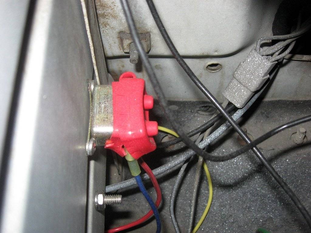

It's a pretty simple circuit. The key thing is to buy genuine Bosch/Tyco relays and not the Chinese clones.
I took the entire headlight harness out of mine and added the new wiring and put larger gauge wiring in for the power source, but the way it's done in both those links is a little simpler.

When you do this mod, one thing you may want to do is make a couple jumpers to bypass the relays and toss them into your "road" tool and spares box.
