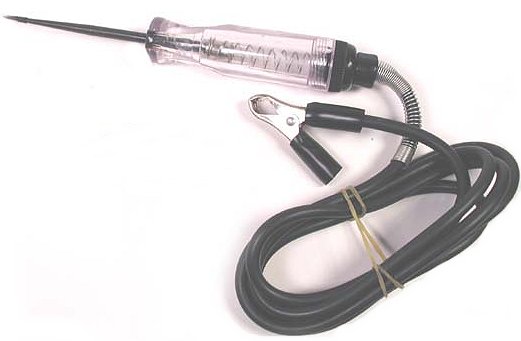

How can anybody think of doing an electrical diagnosis without starting with this????

You HAVE to own a test light....
Is that what that is called? How do you use it? I may have one somewhere............nope....nope I do not own one.
