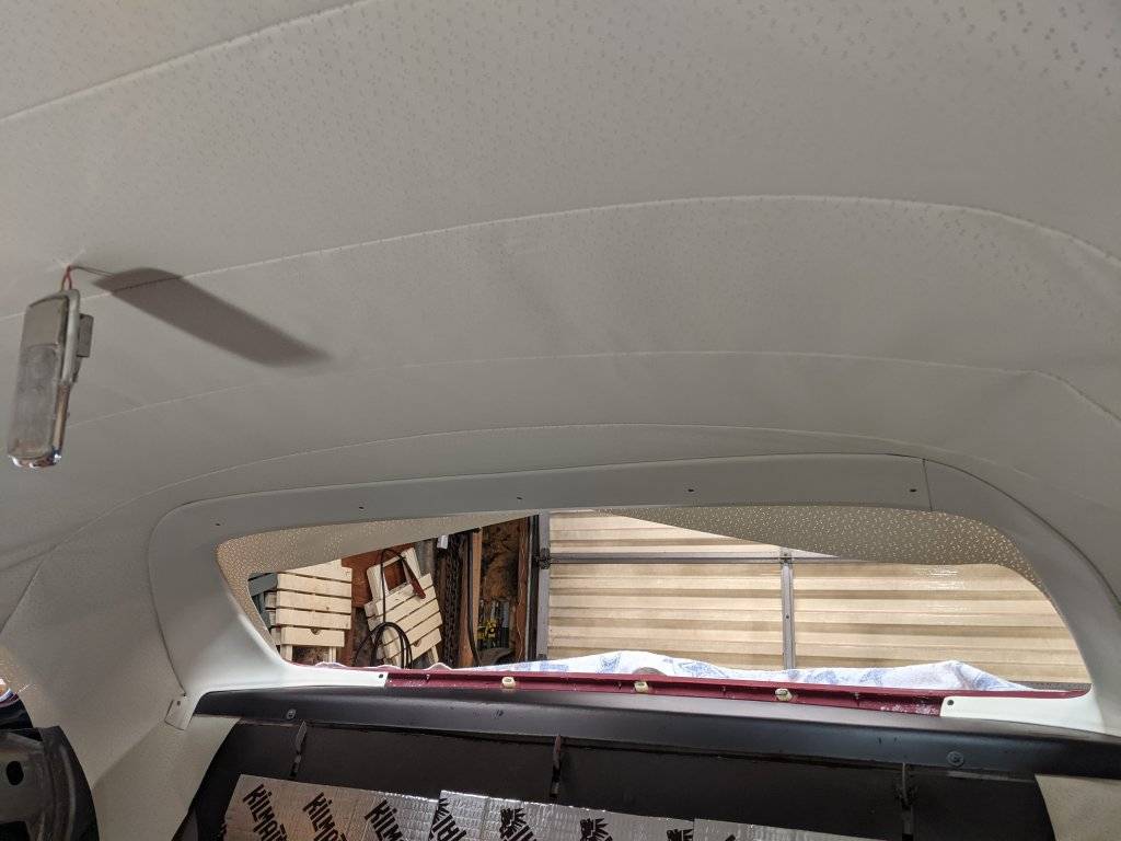

He came to my house to do this:
Windshield and rear window (yes, the big window) out.

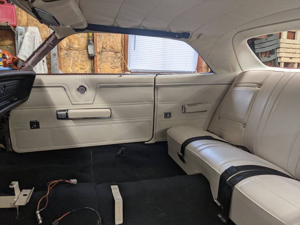

Wow! Nice finish though. Now to reload that glass.
Glass was easy. That big back window took another person to help me lower it in place, but otherwise easy stuff to do.
BTW, the myth that those rear windows are rare and expensive is just a myth. Everybody with a early Barracuda (including me) has a spare sitting around that's one step away from getting hit with a hammer to get rid of it. I saw a pic of one sitting at Carlisle with "Free" written on it... No one took it.

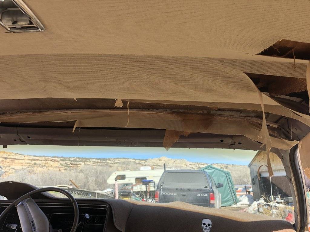

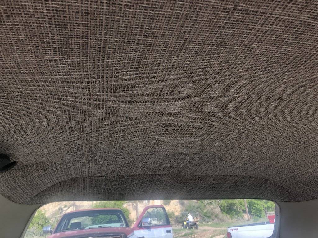

It’s a pain but can be done material was 3.00 per yard I’ll get better pictures tomorrow. The main thing is be gentle
as all the plastic and rear shelf dis real brittle p
