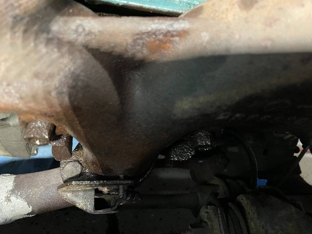

I was trying to take the exhaust manifold off that side this morning I stop cause this bolt head stripped on the left!so not sure how I’m gonna get it off!!
Heat from a torch before you started. Now clean it up and weld a nut on the end. Those shouldered bolts are buggers
