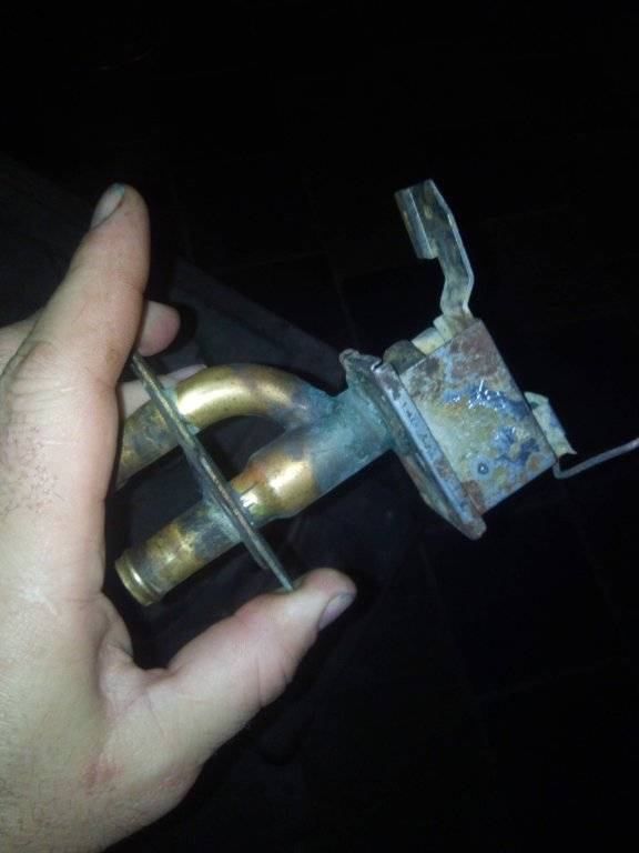

In my 1964 Newport, the heater control valve has sprung a leak. I've bypassed and removed the old and wishing for a new. Does anybody have a source for these? Or perhaps know of somebody that rebuilds them?

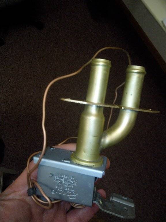

Gotta be a shoutout to Joe Hudacek. I mailed the above heater valve to him. USPS said it would arrive on Wednesday last week. I mailed it with a check for $90 in the box. He fixed it and mailed it back. It arrived today and now looks like this. heatervalves.net. And, what's more is that the check didn't even clear yet.

I didn't get this in as soon as I would have liked because an attractive teacher at a nearby school persuaded me to come up with a project to do with the kids. Three high school girls worked together to put the valve in. Once it was installed, all worked as it should with no leaks. They also are in the process of making a video. Once it's done, I'll post it here.
