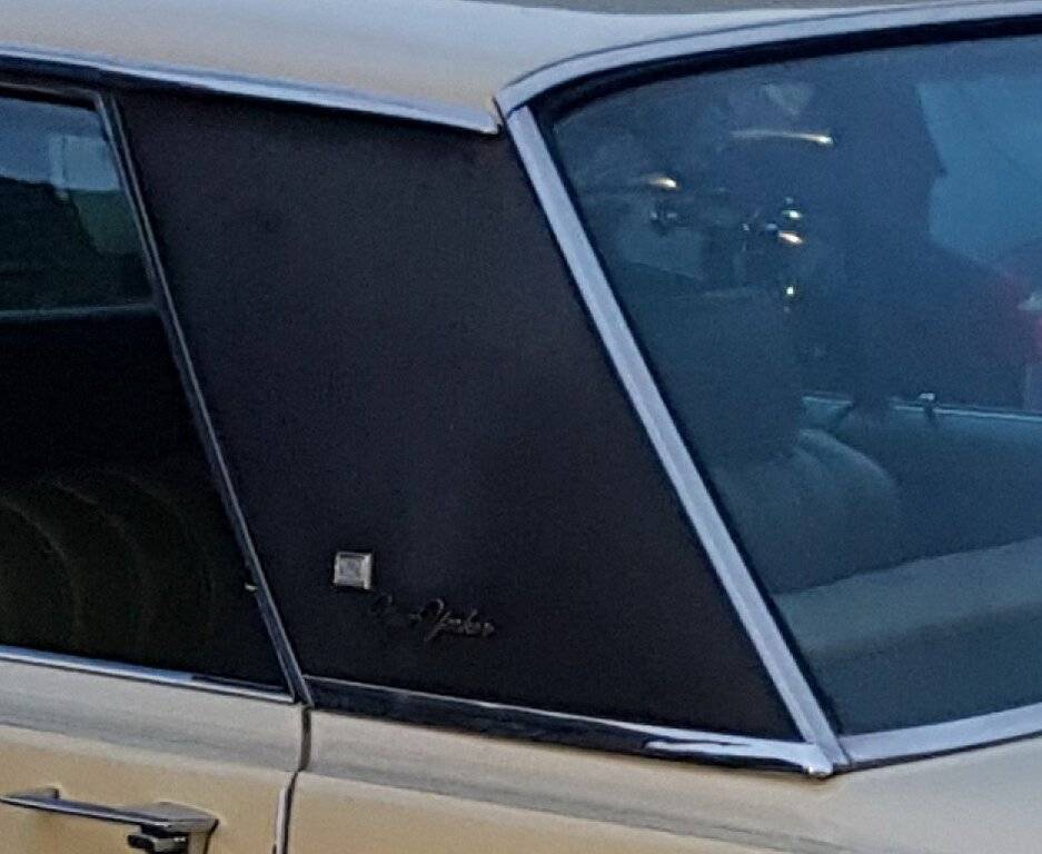

I want to re-new the vinyl on the c-pillar of my 68 Newyorker.
can someone tell me, how to remove all that trim ?
Are there pictures of that work somewhere in the internet ? (i didnt find anything)
Next question, is there a possibility to download a shop manual for this year ?
I found everything, Plymouth, Dodge etc, but not for 68 chrysler.
Here is a picture, hope it works
Greetings from germany
Gerd

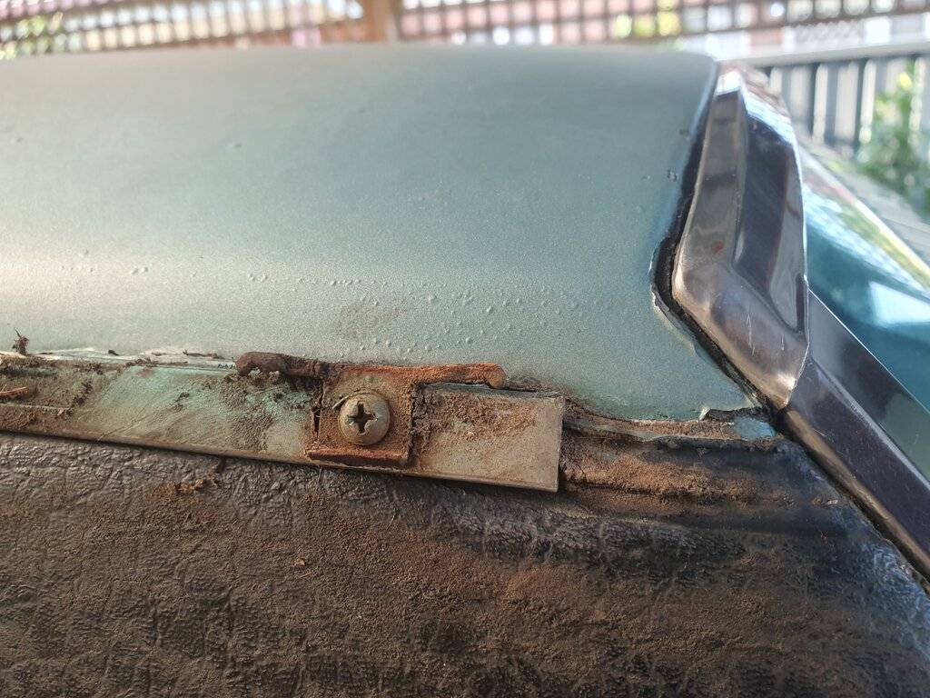

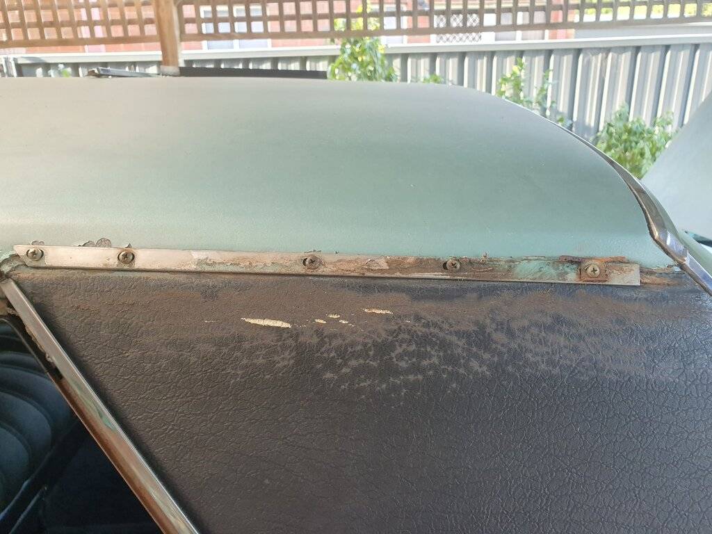

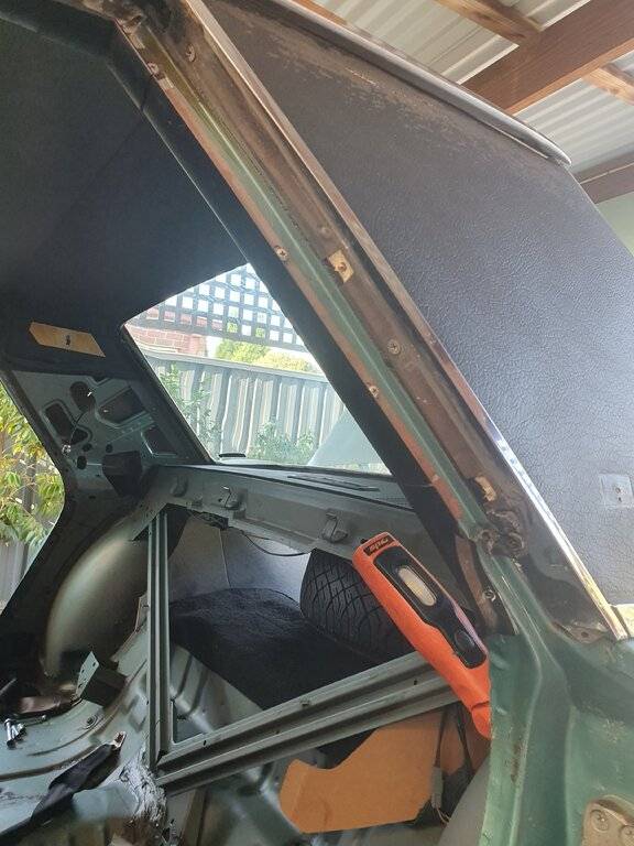

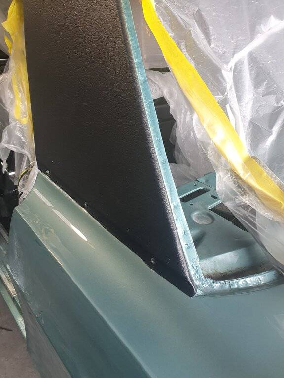

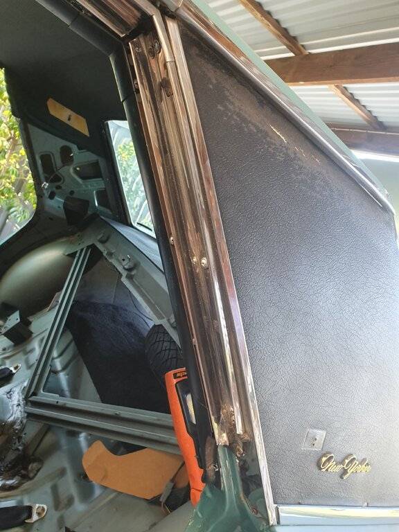

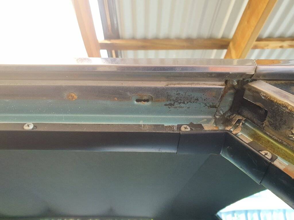

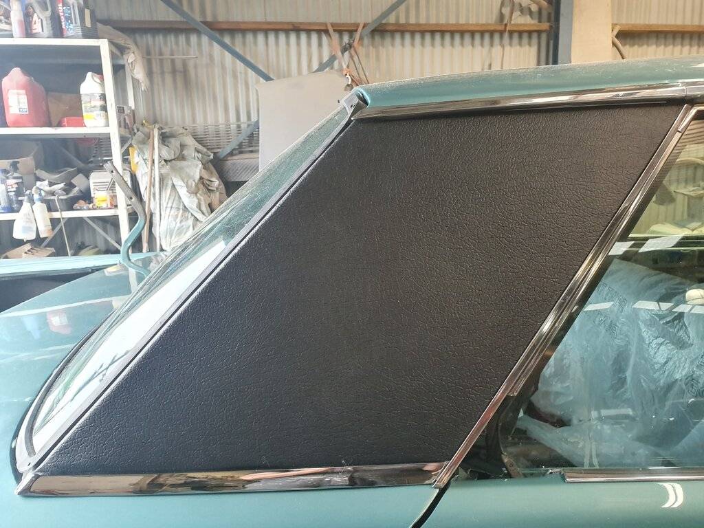

Hi, I have the same car and removed all trims before i repainted the car las year.

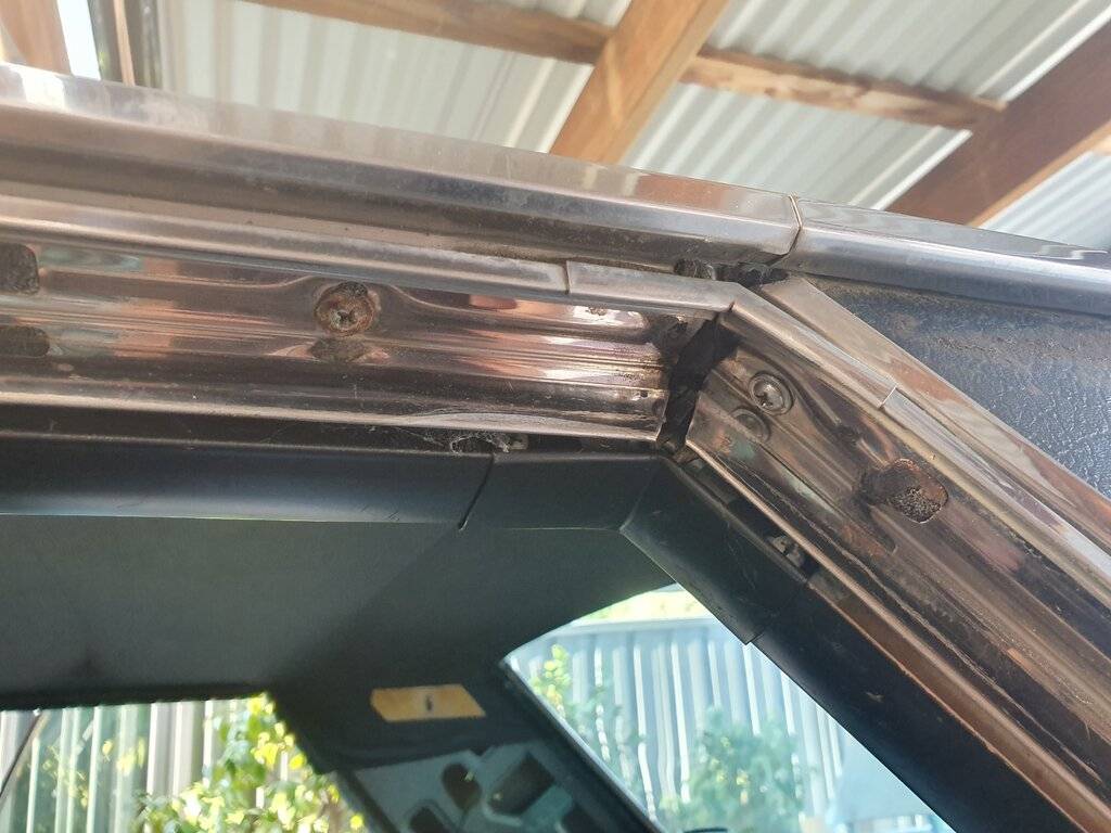

So start by removing the roof rail rubbers (the rubber that the side glass seals against when up, this should just pull out of the channel it sits in) once removed this will expose the screws that holds the trim that the rubber sat in.
Once you remove this trim piece (rather long) it exposes more screws to the top molding that runs up the A pillar and along to the roof line to the back glass, this trim is 2 piece with a join above the 1/4 vent on front door.
this trim is also held in place above the vinyl roof panel by clips and it will pop off easy enough.
The last trim that runs down the front of the C pillar will just unscrew, the chrome trim on bottom of C pillar is removed by removing interior C pillar trims and remove the interior sail panel.
Once sail panel is removed you can get to the 3 hex head nuts that hold this chrome piece in place.

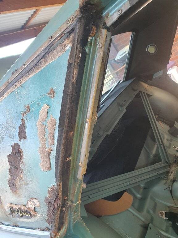

The trim around the back window is always tricky, and requires patience and plastic trim remover tools.
The rear glass has to come out, as the vinyl sail panel sits in under the rubber, and there is a metal strip at top of the sail panel to help hold in place with 3 or 4 screws.
It is a time consuming task but new sail panel vinyl really sets the car off, i got my correct grail vinly from SMS, they do have it it stock if your looking for it.
I have attached some pictures of my car and when i done the job.
If unsure just ask me, i love your car, the pale yellow really suits it.
Gavin
Ballarat, Australia.
