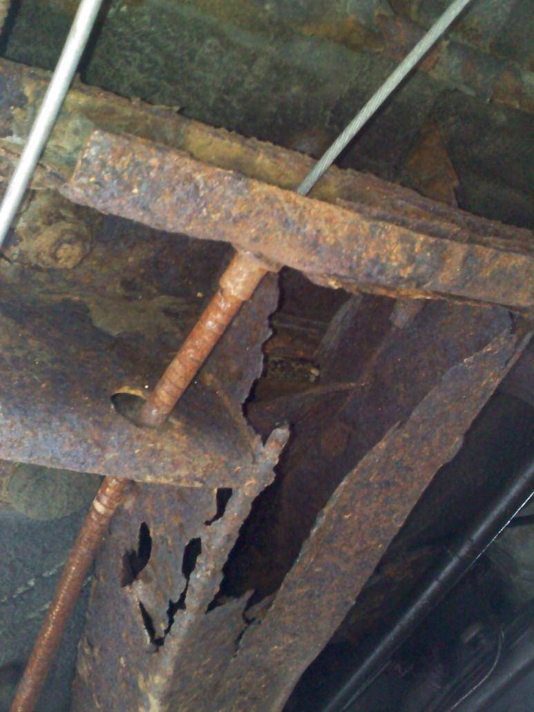

My name is Paul...just joined after purchasing a 1967 Polara that needs quite a bit of TLC. I just discovered a rotted out portion of, what I believe is called, the torsion bar cross member (part of the frame). Does anyone know if that portion of the frame can be purchased somewhere? I guess the rotted portion would have to be cut off & a new one welded on. Thank you.

It's the part of the frame that is connected close to the middle of front doors (4 door), so I would say slightly behind the trans. I will take pictures tomorrow when the sun is out. I'm not sure what that part of the frame is called.

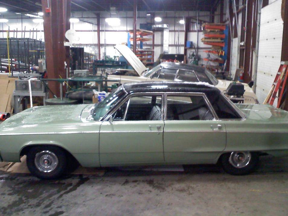

I have kept my Polara here at work b/c the co-owner of my company is a master welder, metal fabricator & a hell of a mechanic...as well as a good friend. He actually bought a 67 Polara sedan (I have the hardtop) in NH...I picked it up with him & we trailered it back. Very cool to see the 2 cars here at work! (below picture of the 2 cars at our shop replacing my water pump and his engine mounts Saturday).
He has proposed to help me with that rotted section (2cnd pic below) by cleaning it up and welding in new steel. If it doesn't work, I am going to pursue cbarge's friend's front sub in NY.
Sorry, the green one in the foreground...same as the one on the pic for my avatar sitting at the Super Dawg drive in in Chicago...P
Both are nice, but I love that green paint! Very Nice!

Thanks Fratzog...My buddy felt the other way about it though. I'm just confused...LOL. I liked the sub too because I felt I could have it blasted so I could coat it & restore what I needed to in comfort. It is still not out of the question though, we're gonna try the replacement steel first & if it doesn't work, I am off to NY to get the sub.

Good stuff! Not an easy repair from underneath but definitely doable. Just make sure that you prep the parts for repair very well by getting as much of the rust from around the area off as possible. While your under there you can coat some of the rusty stuff that you're not replacing with some converters or a p.o.r. primer to keep things from getting worse or spreading. Check out the eastwood catalog, they have a number of products that I have used that are excellent for rust conversion and prevention.

Well... the metal is already gone, so that's one down. I've changed these sub-frames before, and for a living have been involved in many frame up/off rebuilds on Scouts, and I think these things have rust as part of the factory package.
I would rather replace the sub-frame... any day, and it won't come back to haunt you in the future. You are talking about patching, vs replacing the integrity of your car... Pull the radiator, hood, front clip, crossmember, engine/trans as a unit, steering column rollpin, fuel line, brake lines, roll back some carpet, etc. It sounds like a pain, but it is not bad, and it beats getting burned welding rusty spattering crap overhead. If possible get the mounts and bolts with the good sub-frame, as I'm sure yours have not faired as well.
I actually used a sub-frame from a '68 Monaco on my '39 Plymouth pickup... Worked out well.
For the best results you'll have to pull the stub frame and weld in new metal - I've done it several times on several cars.
Pull the clip, the block and tranny, disconnect the steering column and the emergency brake cables from the pedal and the splitter on the aft frame, support the body, pull the bolts and drop it. The first one I did was in 1978, it's easy. Make sure you keep track of the shims and their number on each side.
