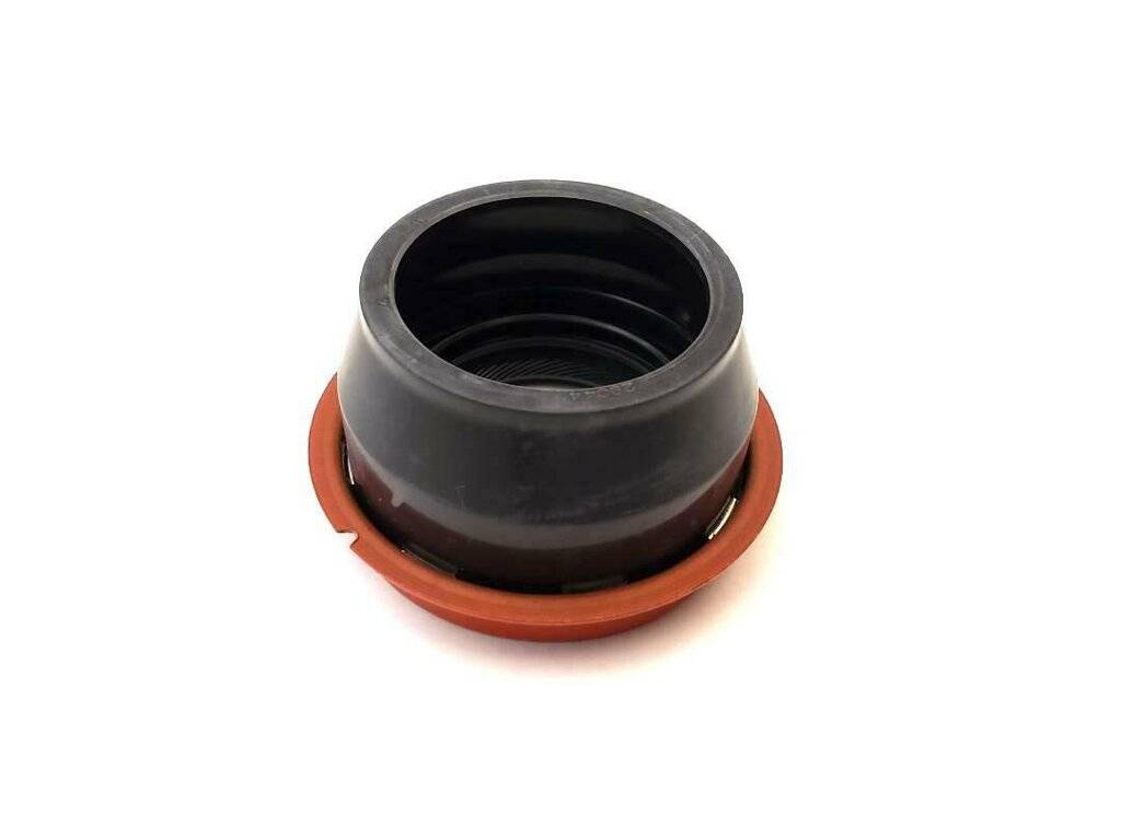

The 754 in my 66 Fury had a seal on the output shaft forward of the spline. This sealed to the inside bore of the yoke in front of the spline. The rear of the slip yoke was completely open. It seems this was a one year only design. Could be a problem with that "extra" seal?? Just a thought. Check your FSM. Lindsay

Rebuilt huh? Look at the rear trans seal, does it have the OEM extended boot? Or is it flush with the rear of the trans like nearly all the aftermarket seals? If it is flush, are you trying to push the yoke in to the wear mark on the yoke from the OEM extended boot?
