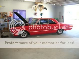

Now I am not going to try kidding you or myself....or anyone else for that matter.....looks are important to me. That's why I wanted the one inch over. I wonder how much my stock springs have actually settled? Is there an online resource that has any fender well or bumper heights for the rear of my car? Perhaps just the stock arch will be fine. Ugh, so many things to decide on. The first thing I did when I bought this car was meet the car hauler at the edge of town and take delivery. I drove right to gas station because the car was empty. Filled her up and drove to the local watering hole. My wife was there in a dart tournament or something along those lines. Anyway, I pull up to the curb and get out. As I am locking the door, three kids on bicycles stop about 25 yards away and I hear one kid say, "whoa! Look at the low rider!" I stuck the key back into the lock cylinder and drove home and straight into the garage. Two hours later I had the whole rear axle assembly out from under the car and the lowering blocks set aside. I started preping the rear for paint since it was out, and that's where the snowball started.
This what she looked like when she arrived...
In the garage...
Now I don't dislike the lower look near as much as that day, but I don't think I am going to back that direction.
I despise the lower look most of the time. Yours is definitely low. I like the aggressive stance of a 1" over stock height but your front end needs to come up too
Personal taste...... I like em low. I also like a modern vibe, not everyone does.
Car looked bad *** red & low.
Oh yeah, thats right. Someone else getting a car done in front of me.... I like it
yes, personal taste. I would never knock anyone for how the build their car. And like I admitted earlier, the look isn't so bad to me as it used to be. Most of my friends think the car set perfect in the red pictures. The red paint was horrible, not the color, the work. It was a cheapo resale red and there was overspray on everything.
