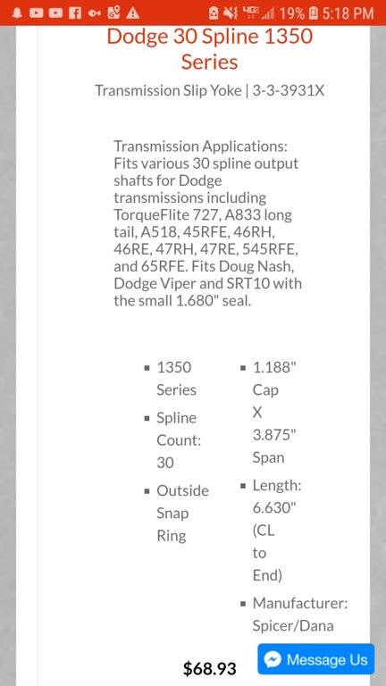

So, it's approaching time to put the engine in my fury and my priority is the driveshaft at this time. I need to order a yoke but the transmission came minus driveshaft so I need to pick the correct one. This one is made by dana so it's pretty good and I think the 30 count spline is correct too but I'm not sure. Any suggestions?
