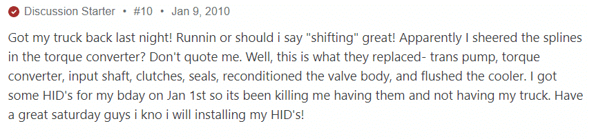

Yeah, it makes the same noise in P,R,N,D,2,1. It really sounds like a 6/71 blower whine wile ideling. I found an old thread online where someone describes pretty much what happened to me, and then says the torque converted sheered splines. I've never dealt with anything like that so I don't know how to go about checking without removing.
