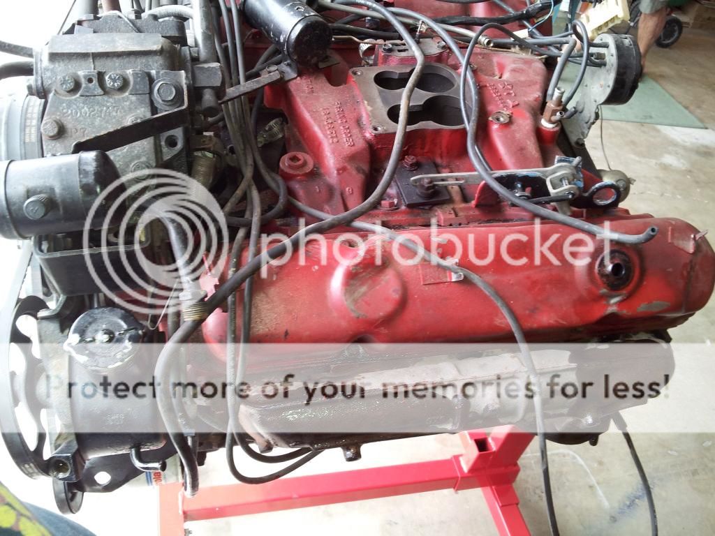

Finally got the engine home and out of the jeep.. What an adventure it was. Was supposed to have a cherry picker from a freind to use, but he was using it. Had another freind have a buddy of his come over with an old ford wrecker. Hooked the motor up, and dragged it out. The engine got banged up a bit on the back of the wrecker... :angry4:
The right side valve cover got a nice couple dents in it, the power steering pulley got bent, and the crank pulley got a small dimple in it :BangHead:. Granted I'm gratefull some freinds came over to help, but damn.... What can you do.

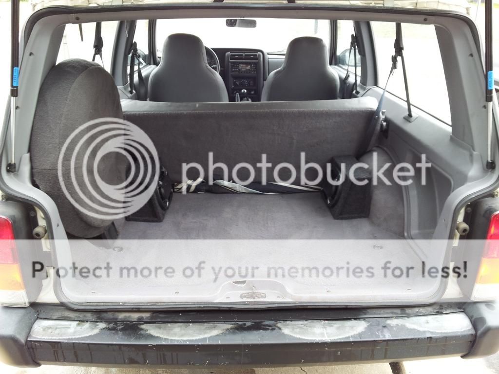

The real work came after it was out. The engine leaked oil all over the rear of the jeep . After 4 hours of cleaning finally found the carpeting.

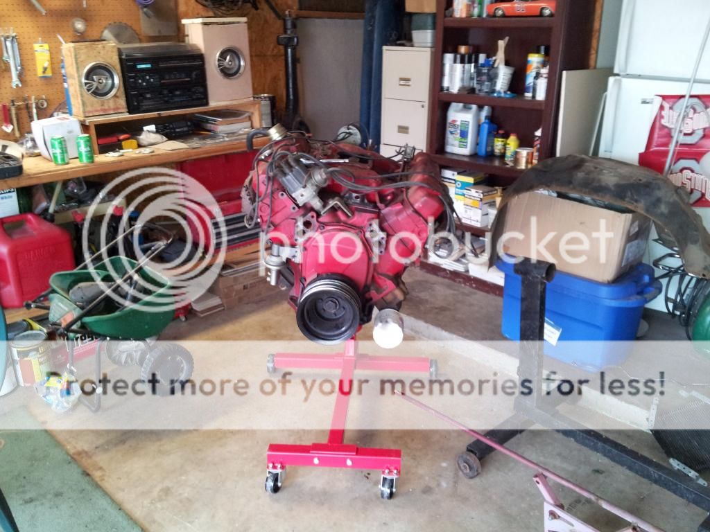

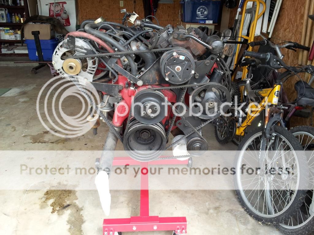

Regardless the engine is out, and on the stand. Removed the accesories and putting a plan together.
The engine is a '73 440 that has been recently rebuilt. It is bored .030 over. The basic plan is to throw a few goodies at it, regasket, and paint it, then put it in. Sound good?
What do you guys think? Any tips on what to do? Was just thinking an intake, carb, and cam. Maybe a few other little mods..
I did question your sanity when I saw the pic of that engine in the back of a carpetted SUV....

Worst part is its the girlfriends jeep... She was a little pissed haha. I promissed her a new carpet if it didnt clean up. I think she was satisfied with the clean up (cross mf fingers).
Didnt have any other way to get the engine, and i couldnt pass up Ross` offer.
