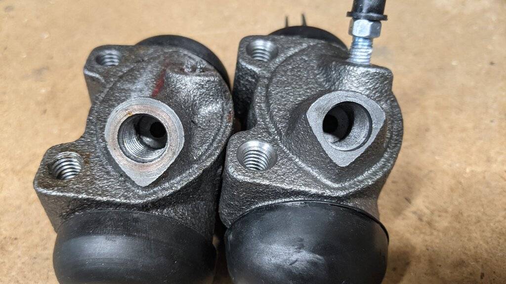

I'm replacing all the brake lines, master cylinder, and all four wheel cylinders on my '68 Newport Custom which I just bought late last year. I've run into problem after problem and am at the end of my patience with this project. Hoping that someone out there may have done this recently and can give me some advice.
My latest problem is I snapped off the bleeder nipple on the front left cylinder. It's a really tight fit to get a wrench in there and I bent the nipple which is why it snapped off. This cylinder had a bleeder nipple that used a 7mm wrench.
After not being able to find a replacement nipple (don't know how a parts store can sell a cylinder but not the replacement bleeder) I ordered a new cylinder from a different parts store in the hopes that it might be a little better quality. It came with a bleeder nipple that uses an 8mm wrench. That's all fine and good but the 7mm wrench already barely fits and I don't think an 8mm wrench will. I was going to install it just to see but then noticed that the flat surface that the copper crush washer seals against is quite a bit smaller on this new cylinder. The new cylinder is shown to the right in the attached picture. Would you guys install this? Do you think there's enough flat area for the crush washer to seal?

If I understand the question right, the size of the bleeder nipple should not be an issue - as it is a new unit it should open and close easily enough with an open ended spanner. As long as the existing hoses attach and seal correctly you should be good to go.
and a flat seal washer just needs to make a tight seal, it doesn't really need to have a 2mm flat area, so to speak, as long as it has enough area to make a leak proof connection between the 2 surfaces

Contact Craig@mobilparts, a vendor on this site for quality US made cylinders. The ChiCom wheel cylinders usually have bleeder screws made out of peanut butter, very soft metal that twists off easily. Replacement bleeder screws are available on line if you Google, "Bleeder Screws"

IIRC I had quite a few aftermarket/parts store wheel cylinders back in the day where the bleeder screws were different sizes, had to use 2 wrenches to bleed the whole car.

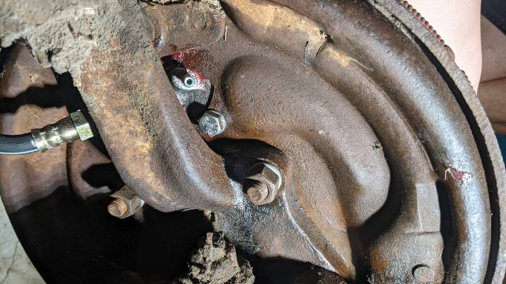

Here are a couple of pics of the clearance issue. You can see that there's not much room between the bleeder and the suspension piece (steering knuckle?). I can just sneak the closed end of the 7mm wrench over. I don't think there would be enough room to get the closed end of an 8mm wrench over the bleeder. I'd have to use the open end.

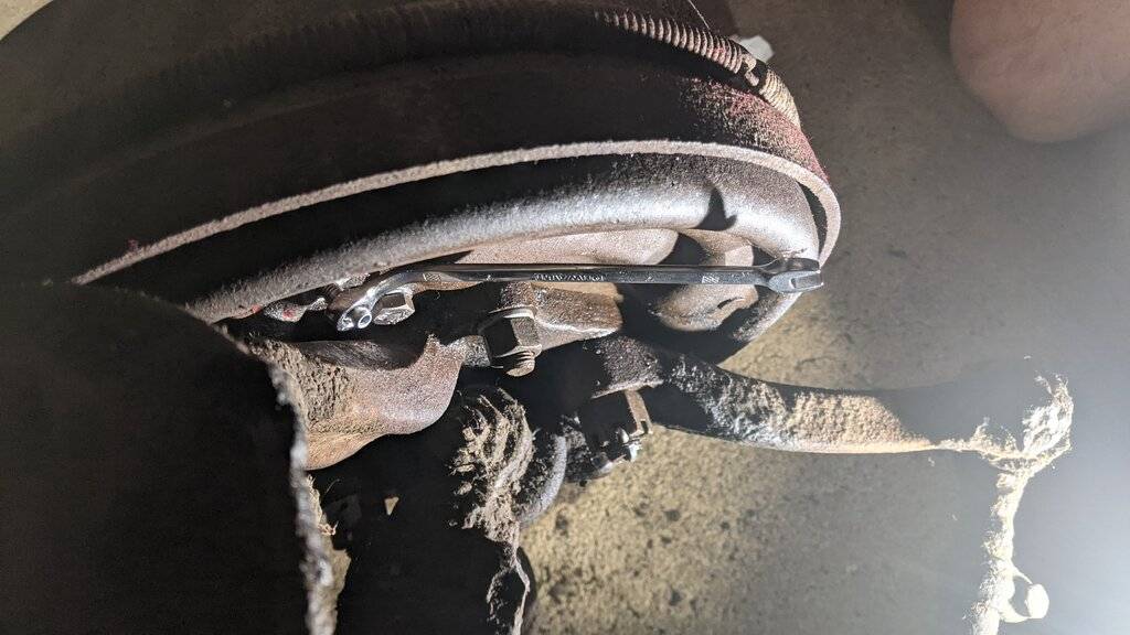

You can see my "homemade" bent 7mm wrench in the one picture. I can't help but think there must be a better way to do this.

Yes there is a better way to do this. Use a 1/4” drive socket on those bleeders. Don’t try to use a wrench. The China wheel cylinders have metric bleeder screws.
