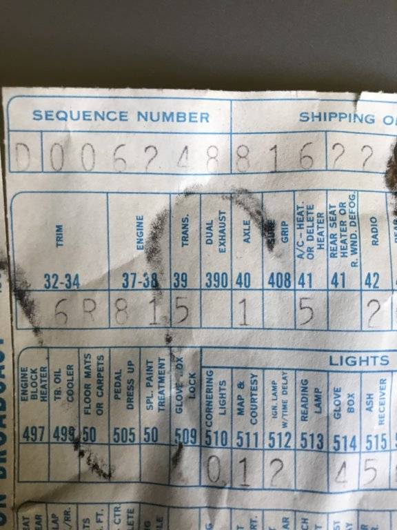

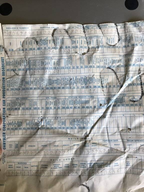

I have been searching for Broadcast sheet codes, but have not found or don't understand some of these codes. Can anyone tell me what axle ratio I have? I thought it was 2.72, but maybe not.
Code 401 for 68 is 2.76 ratio. You can always count the number of driveshaft rotations vs 1 turn of the tire to confirm.

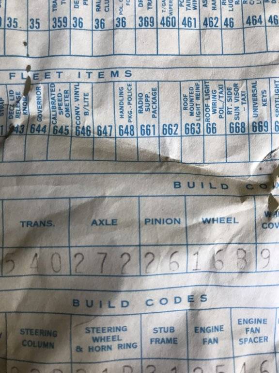

I believe the 272 is related to the part number installed on the car for the axle assembly.

CODE 401 - so, that's how you read these things! the column has 40 and then they print the 1 to get 401. Makes sense now. Thanks.

On the broadcast sheet, you look for "sales codes" typically. The "272" number is a code number used on the assembly line to identify the axle assy itself. The sales codes will identify the ratio, especially if it's an optional ratio. SureGrip is a separate option code (although the "272" type number would include that in the assembly ID number).
The middle '70s broadcast sheets had the "decode" on the back side of the page. These were also the ones with multiple colors for the various areas on the sheet.
