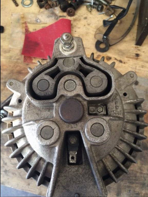

Alright - for anyone still playing along... I pulled the Alt this afternoon and it looks to be a stock single field. What threw me for a loop however is here in the 2nd pic. There is a 3rd wire wrapped up in the harness to the alt. It's tan (pink?) but doesn't show up in my service manual as anything but 2 wires going to the alt. I haven't been able to trace it back (yet). It's all rusted and corroded, so I'm not sure what if anything it hooks to. Maybe this is an aftermarket harness setup for dual field? Anyway, I'm going to take the alt up to a local rebuilder to have them diagnose whether or not it's dying.
