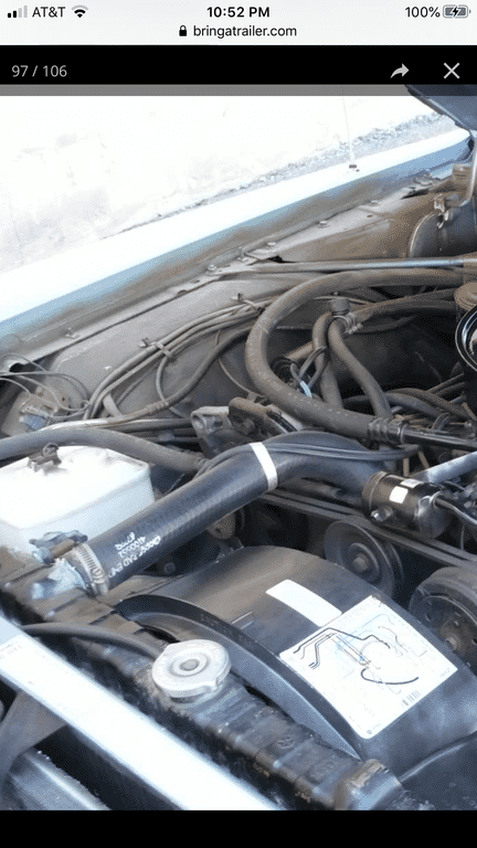

    Starter ring gear replaced at 9k+ miles?
    Don't believe this is a 15k mileage car, more like well cared for 115k car.
    Do we need to post up the picks of a real 15k car for comparison?

    Also still has the lean burn in addition to ATC II. Nice car, but I also doubt it is a 15k car.

    The 4 mounted tires appear to be the original Firestone 721 radials. The sticker is still on the A/C compressor & brake booster. The original clamp is on the original resonator. The front seat belt plastic clips are still in place. Original hoses & ignition wires; just 1 new clamp. Original wiper blades. It looks like 15k original miles.

    Firewall, fender wells are real dirty for a 15k car.

    I think its mileage is 15k. I Don’t see wear on the usual places to be 115k. Driver door panel looks pristine. The top of thre grill shows no cracks or blisters.
    So, unless it was driven by an incredibly anal adult who weighed less than 100 pounds since new... I see a 15000 mile car.

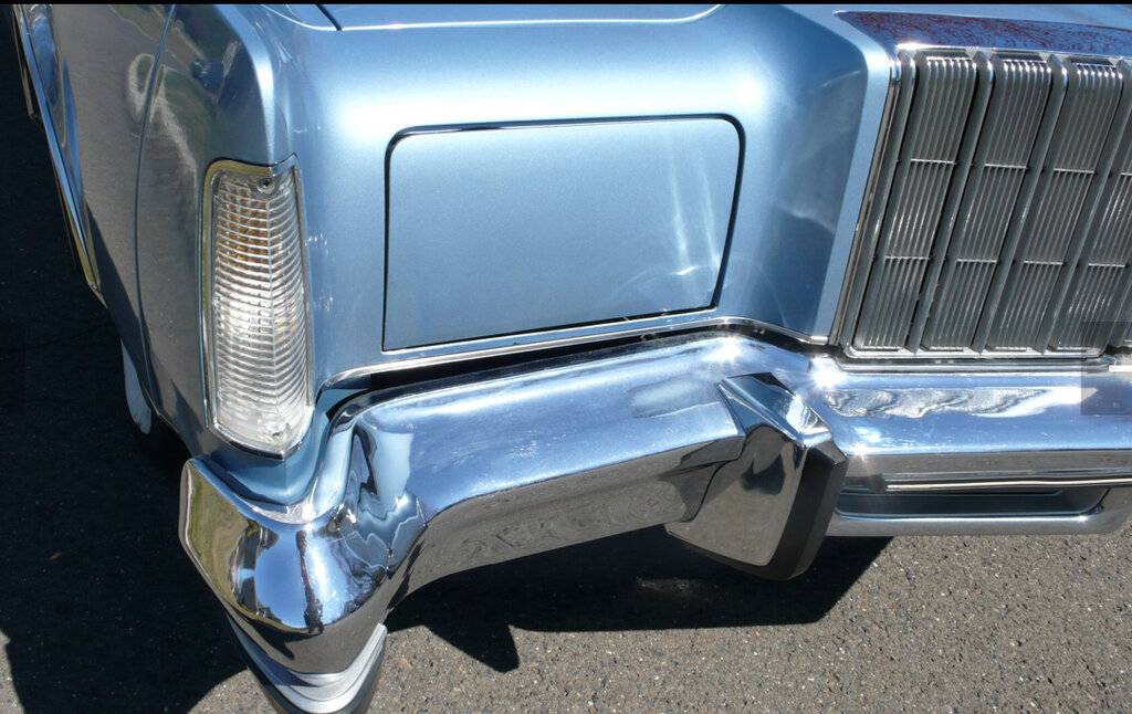

    it also has that factory fresh drooping bumper ends ....
    .... bane of our existence

    I clean mine every time I’m in there and mine are dirtier..... Lots of shit flying around under the hood when running. Belt rubber, road grime, coolant vapor, oil smoke off the exhaust manifolds (valve covers all leak a little), plain old dirt through the fan.
    I see rust proofing overspray... my car came with the same stuff all over the inner fenders. Mine was blackened by the heat. This looks fairly fresh and tranluscent.

    From a distance it is hard to tell, but I would have expected a seller to have cleaned up the firewall as part of a detailing process for sale to show off the still shiny paint under the hood. At 15k I would not expect to see much rust or dirt under the hood after cleaning. Seller is either lazy or knows the area can not be cleaned up to look like anything. I am usually suspicious of claimed low mileage, especially by dealers. It is entirely possible this could be a low mileage car, but I would want to see better proof than a dealer's say so. Bidding is stuck at $7600 for 2 days now and I would have expected it to have gone higher if that mileage is correct.. A detailed history of the car's ownership history would also be helpful if the dealer expects to get big bucks for it. Even if it is a 115k car, it is still a really nice example of an American luxury car. In that case, the car's value is someplace close to the current bid. If the mileage is legitimate, it might fetch $10k-$12k, maybe more to the right buyer. Pricing has all gone weird in the covid-19 market. The non-functional ATC and the still installed lean burn might also be putting a damper on the price and the late 70's cars do not bring the higher prices that the early '70's cars bring. In short I do not know enough about this car to say it is either 15k or 115k, so I would error on the side of caution.

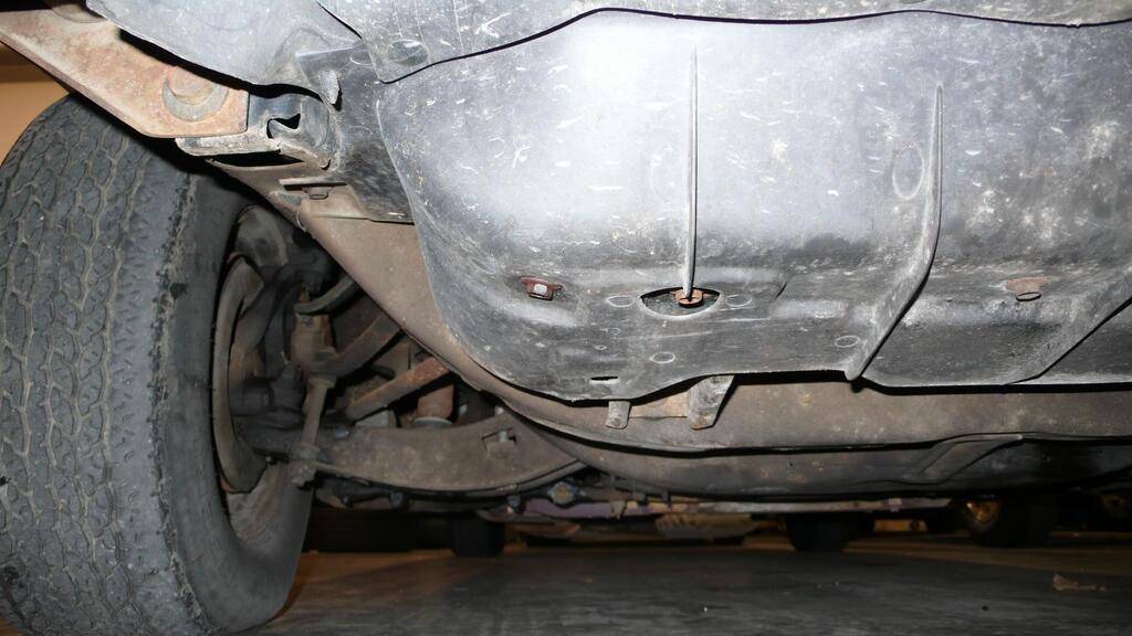

    A 15k car should look like it just come out of a museum, click on the other +46 pictures and look at the front end undercarriage. Plus why did someone spray what looks like new undercoating, I've seen that colored stuff, VatoZone rattle can stuff all over the gas tank area. There is a reason why you don't undercoat a gas tank.
    Front end looks like it needs a alignment. (inner tire wear)

    There is also a lot more grease on the UCA and LCA around the ball joint, at 15K you would expect none. Also note grease fitting on lower ball joint, The cars had plugs installed from the factory which were removed at the first service, well past 15k, 36k was the recommended interval, further evidence that this is not a 15k car.

    Undercarriage at the wheels looks a bit too grimy for the stated mileage. Regardless.... berry nice overall condition.
