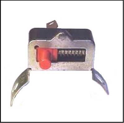

The switch should on the steering column, check the wires to be sure that they are all attached. There may be reproductions available.(www.nationalmoparts.com SKU#2770945N) Example below is approximate as to the type, slider mount is used to center the switch so it on when the car is in reverse.

The contacts in these switches were famous for getting corroded, you might be able to clean them up.

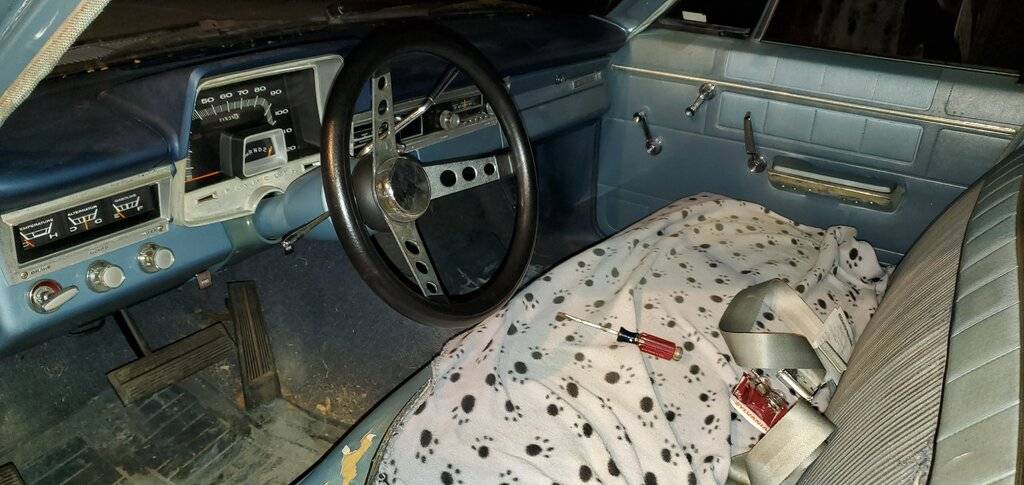

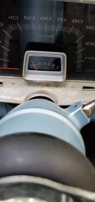

All you guys kick ***! Thanks so much for the replies. Ill keep you posted on the repair. The selector needle doesn't move when you shift the column ots all the way over to the right on number 1. so im guessing that switch broke, what size stud did you use to fix that?
what size stud
I think it was about 1/4". However, my column was really sloppy and I probably should have found a replacement. I'm not sure how the needle is hooked to the selector, as the indicator on mine was mounted to the column.

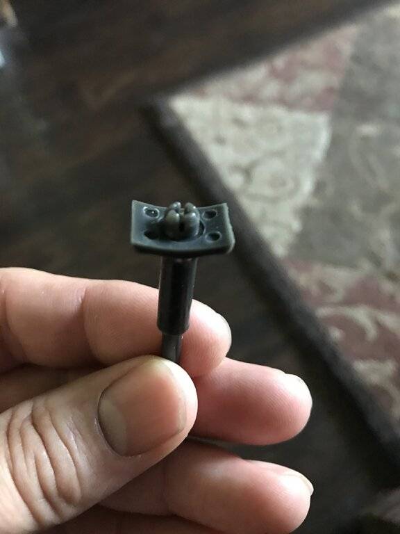

Any time the steering column is taken apart you have to snap the little peg off to take it apart. To install you snap it in place and push the pin in to secure it. This is what the ‘68 peg looks like.
There should be reproduction parts out there. I am not 100% if the ‘65 is exactly the same, but should be similar.

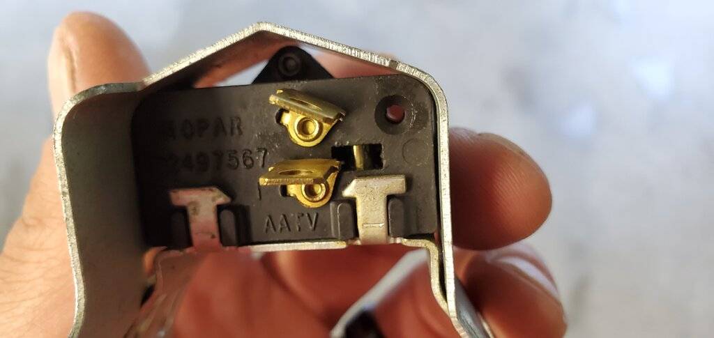

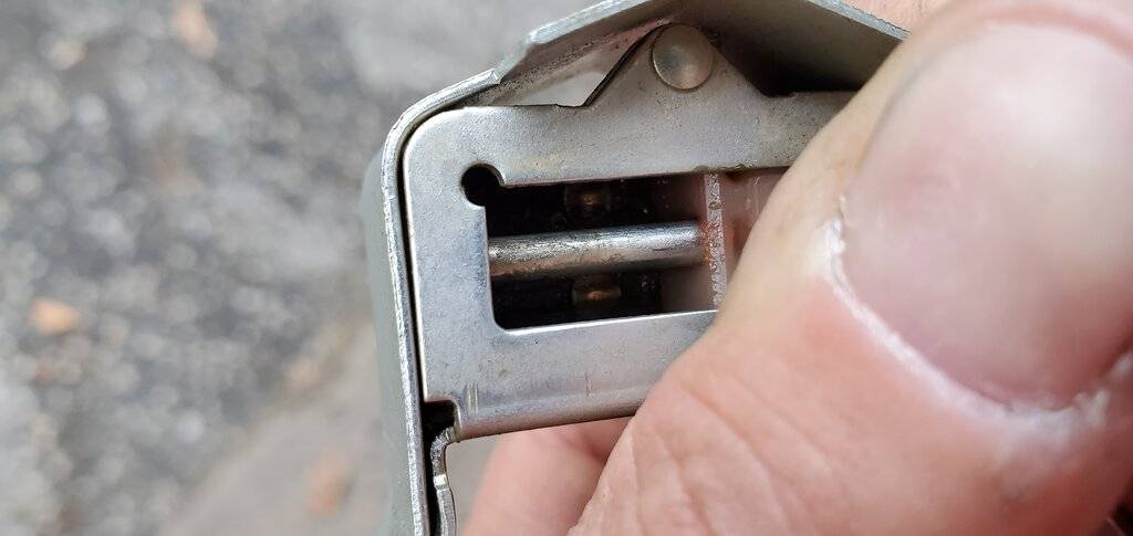

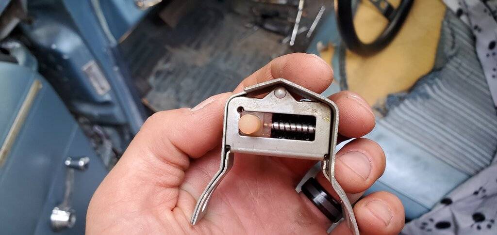

Alright guys so I dug into the shifter selector lever and got that figured out, which was pretty simple, I also dug into the reverse switch as well cleanup the connectors and the switch itself. Got.it all back.installed and still no reverse lights, however when I manually move that pin to make contact with the wire contacts reverse lights work.any idea why it wouldnt be actuating?
It is a fine line between on and off. A little play in your shifter column can turn it on or off.

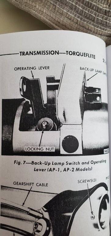

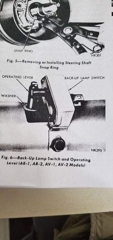

Yes I believe it is in the steering section ( steering column). The ‘68 switch has a locator hole in the switch. You move the Plastic nub in the switch to a certain position and insert the pin (I used a drill bit) to hold the switch mechanism in the proper place. Then position the switch on the column against the actuator post and tighten the bolts. Then remove the pin. The manual will give the exact position.

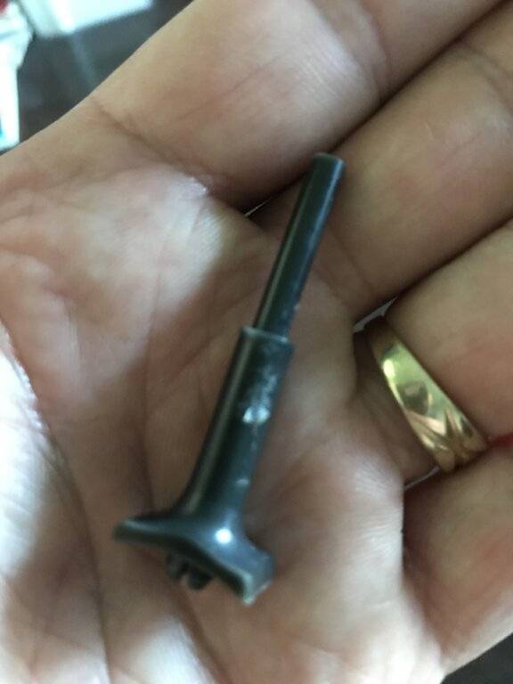

So i have the AP-1 or AP-2 model I think I am missing the operator lever that moves the nipple on the switch. I have this style i beleive because of the AP1 AP2 model the other tpe is like a a little shaft.
