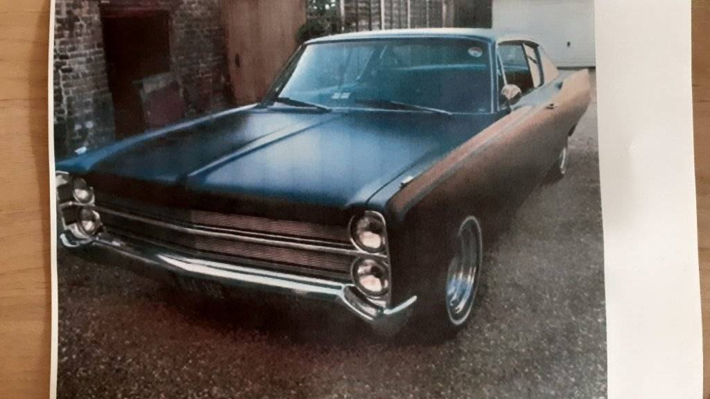

I attach a photo of my Fury VIP , which is off the road at the moment whilst i try and refurbish some of the cosmetic parts, the front fender has just been re chromed and i hope to collect it this coming weekend.

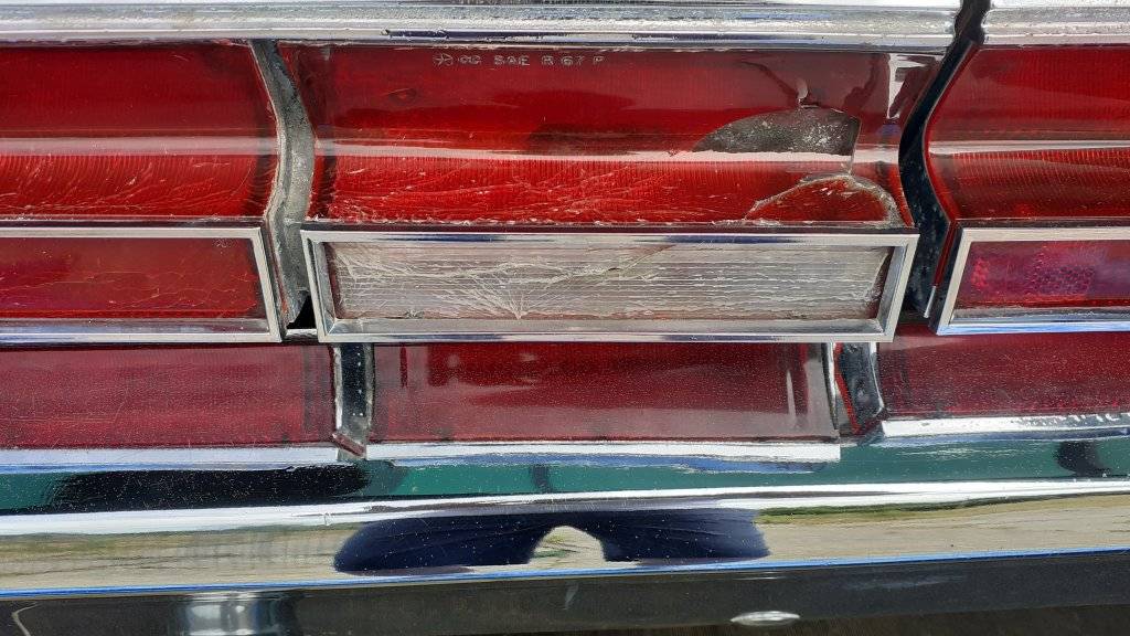

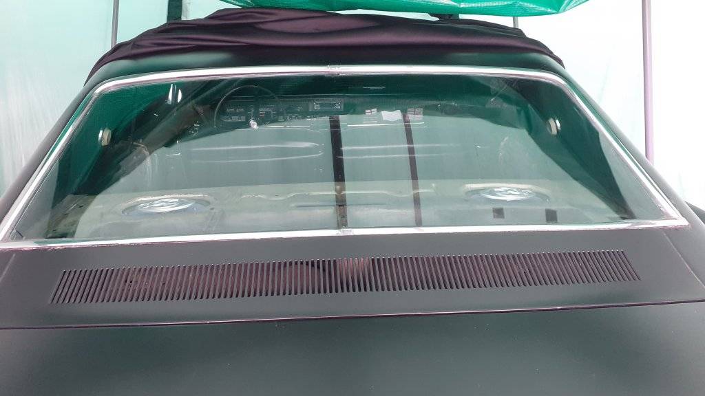

I also attach photo of the damaged rear light that i am trying to replace and the rear windscreen gasket which unfortunately leaks.

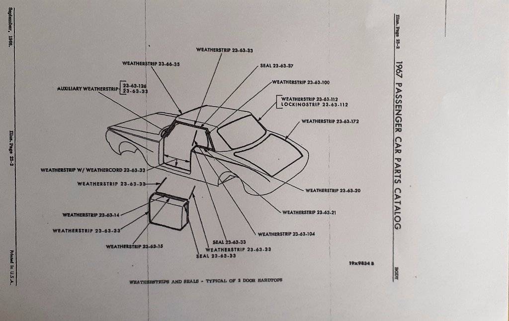

I am also trying to replace the rubbers to the windows and doors, again i attach a sketch of these.
I have a parts manual if it would help to look up the numbers.

The 67/68 fastop rear window uses rolls of buytl on waxed paper and the glass is pressed down upon it. If I remember correctly I think it is 3/4 inch buytl.
If it is leaking there is a good chance there is rust lurching underneath....Very common on this design.
The sideglass weatherstrip and cat whiskers you can get from Restoration Specialties or Dante's. Check them if they offer overseas shipping.
