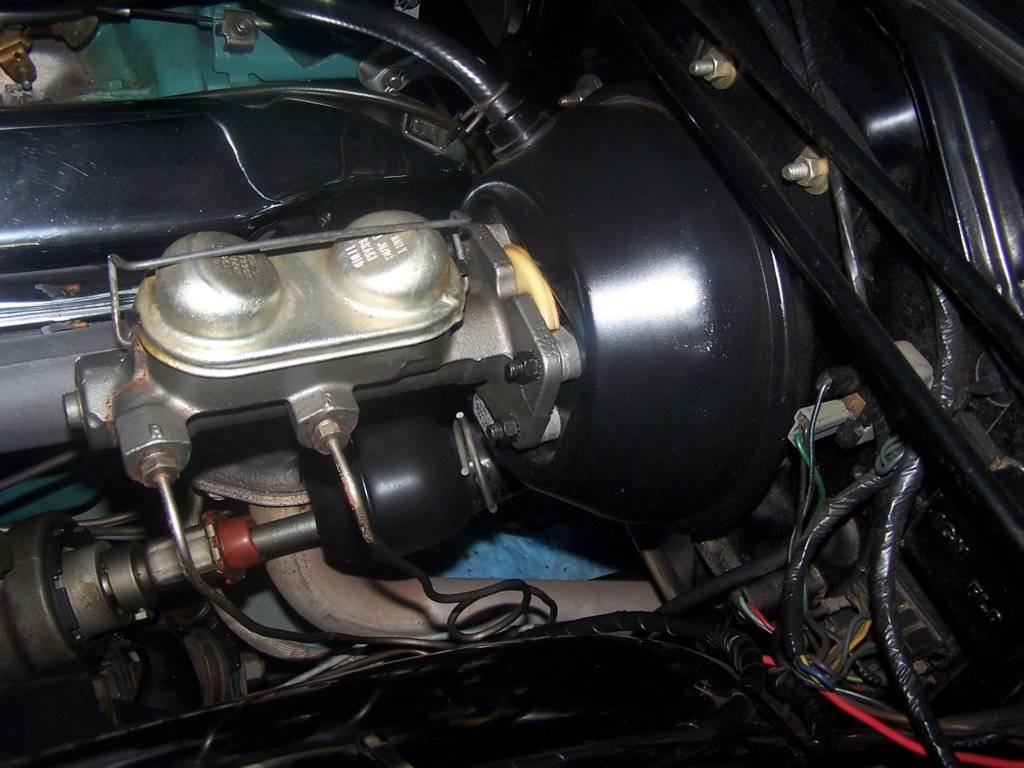

I too was nervous about the single master cylinder on my 65 Sport Fury. Never gave a thought to not upgrade it. My car had power drum brakes and still does. I upgraded mine back in the mid 80's. I robbed the lines and brake tee from a 68 or so C body and bought a new MC for the car I robbed the tee and lines from. If my car would have had manual brakes, I would have stayed with them and just used a manual master cylinder. Here is a pic of mine. Do it and don't look back. If you can't find a tee I have an extra.
