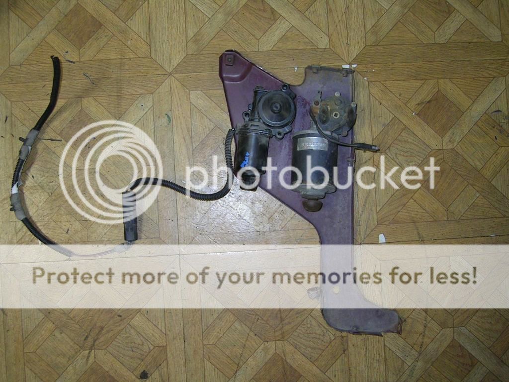

I have a 68 300 headlight motor upright support, with motor, and a newer motor from a early 90's New yorker. Here are some pics.

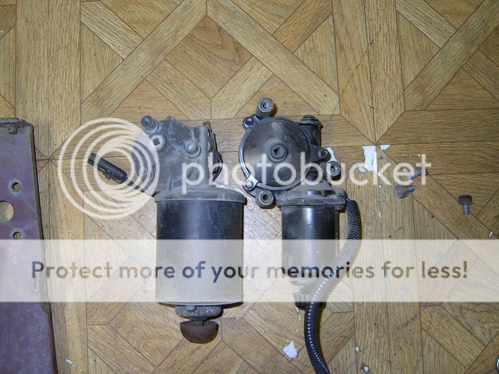

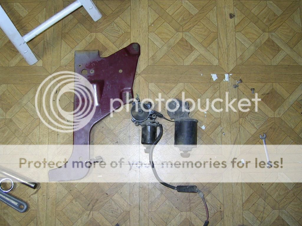

Here you can see that the main bolt pattern is much larger on the newer motor. But the shaft sizes are exactly the same...I mic'd them to double check.
So all that would be required to use this motor would be to make a template to position the motor properly, then drill 3 new holes.
