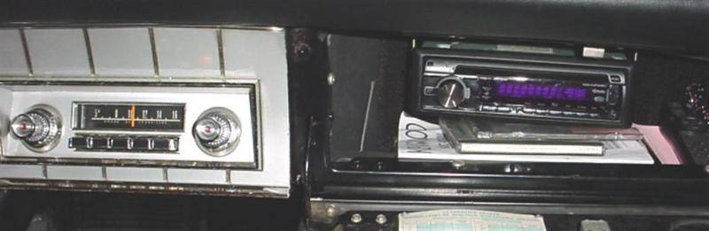

This subject comes up every now and then. I have a 65 Coronet that I wanted to keep as OEM appearing as I could. I bought a Kenwood radio, am/fm, cd, aux for mp3 and installed it in a reproduction glove box. The car is a convertible with no package tray and I didn't want to cut speaker holes in anything.

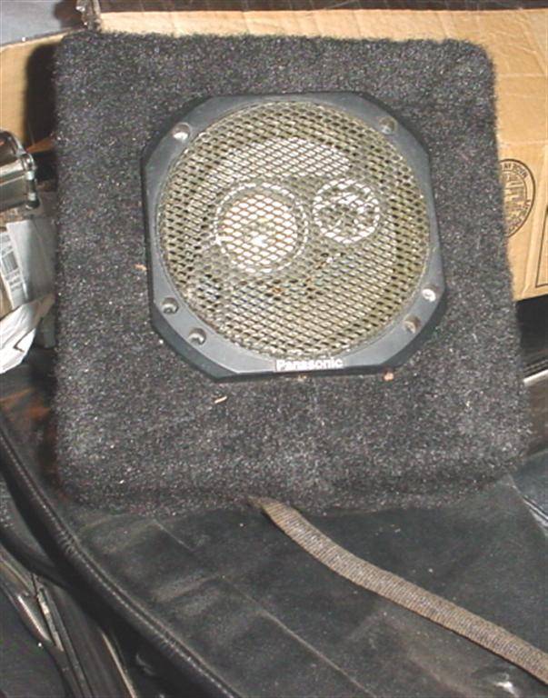

I fabbed up two wood boxes, lined with styrofoam and mounted 5" round three way speakers in them. The wire run under the sill plate and passenger seat to RCA connectors which I can plug into the 10 foot speaker leads. I can unplug and remove them for the OEM look ..... and can place the speakers as far as outside the car or on the boot at cruise ins ...... works great at drive-ins the broadcasts the sound through the cars radio.
