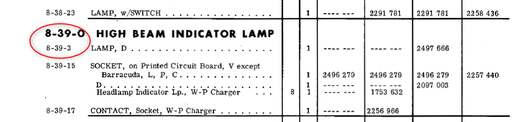

So far the parts catalog is showing 8-39-3 as the bulb
now to translate it into something useful
Know that the code 8-39-0 refers to the LAMP which is a bulb and socket assembly.
The bulbs by themselves are listed by part number crossed referenced to bulb number in section 8-44-0
High Beam Indicator bulb is part number 127 934, which cross references to Bulb # 57. It's used in many different applications including Monaco and Polara USA versions, for everything from Gear shift selector to turn signals, heater controls, etc.

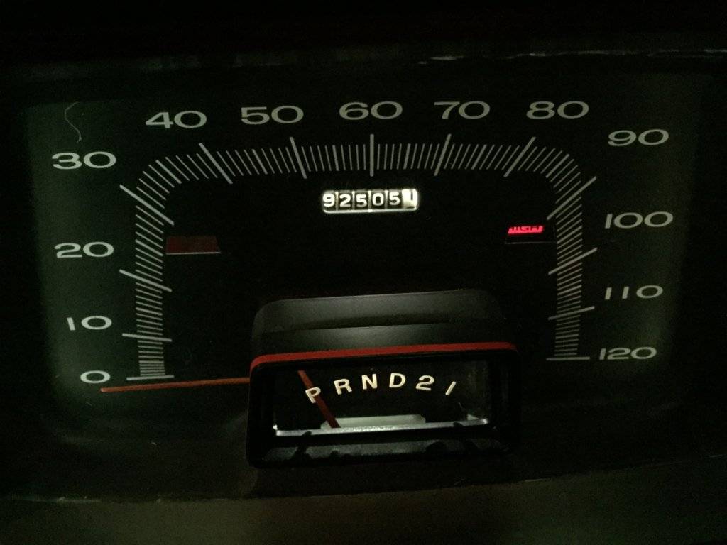

I just went out and took a few pictures of the cluster & the 1895 bulb is going to suffice for now as this is a big improvement over the #57.
The #57 was definitely too dim to be of any value. I did clean the circuit board and socket as this is powered by the printed board & not an external power source.
Have a look. The picture makes the indicator look brighter than what it really is.
