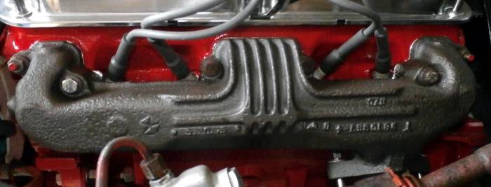

I had my 318 manifolds ceramic coated a couple months ago when I was having my front stub and a bunch of front-end parts powder coated. Was all done by the same place. I was thinking of having them get an aluminum-tone color, but the guy said that because the manifolds were so pitted, eventually you'll see rust again and it won't look good on a light color, so we went with this darker color:
I've had the engine up to operating temp about 1/2 dozen times so far, they seem fine, no smoking or anything like that. Was about $250 (CAD) = $185 USD. The heat riser was working just fine but I took it out because it would have interfered a little with the process. And I don't intend to run the car in the winter, engine warms up fast enough without it. I just put a couple bolts through the holes to plug them.

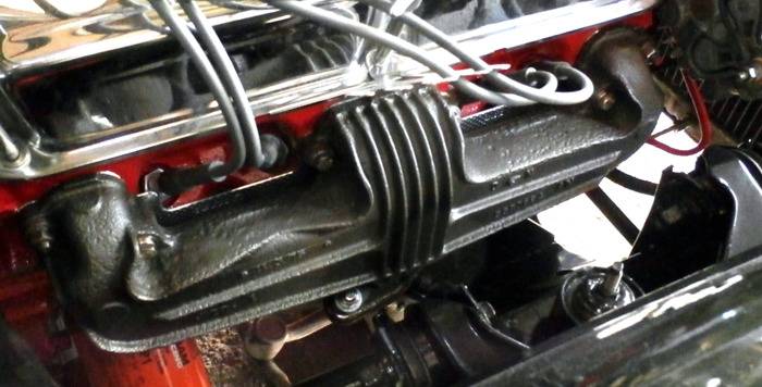

I used Eastwood's manifold paint.
You must follow their instructions to the "T".
I sandblasted my HP logs, cleaned them and brushed on their paint.
Took 7 years for them to turn color..lol

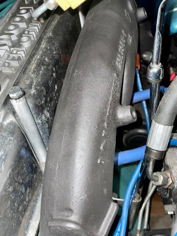

zybar! I did mine in it and it seems to hold up better than ceramic and also seems to work better as a thermal barrier. I actually ended up doing my full tti exhaust with it

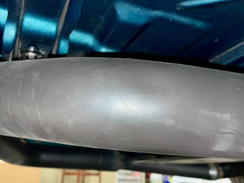

I had multiple things coated with different coatings at the same time but the full exhaust portion with zybar was about $300 from manifolds to end of exhaust. I used black and it came out with a satin finish basically.
ok thanks for your reply, So did you have it done or did you do it yourself? Did you user their primer or their clearcoat or just the base color coat? Can you really tell a difference with reduced under hood temps??
I paid someone else to do it. I wanted to oven cure the coating before putting it on and did not have anyplace big enough to do that myself. No primer is needed but its crucial to do the prep properly. Since the manifolds were already ran previously the powder coating place off gassed them for me by baking prior to media blasting them. The pipes they just media blasted prior to coating since they were new. The clear coat was not available when I coated mine and just adds more of a gloss finish along with maybe a slightly more abrasion resistance with the increased finish thickness. I''ve been very happy with the finish and thermal insulation properties. I chose to go with the full exhaust because I noticed the mufflers that were in the car before with the smaller exhaust radiated a lot of heat through the floorboard along with the manifolds radiating a lot of heat by the plug wires, steering gear box, starter, etc. There was a noticeable difference afterwards.

application and prep is similar to ceramic coating but in my opinion is a more durable coating once cured
