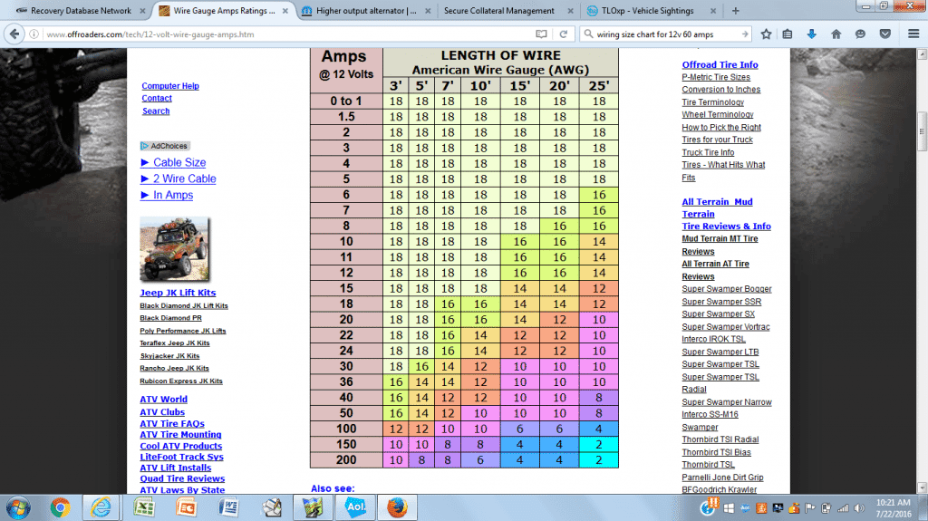

Now, I went ahead and bought 7ft 10ga wire (would have prefered 8ga but 10 was all they had) and formed a direct connection between alternator output and battery. What should i say, hovers at 12.9v at idle and 13.3v above idle. Perfect. Takes load off the ammeter too, which now dosent move really all that much. Only thing I have noticed is, that the 10ga wire to the battery gets quite warm, id say hot. But comparable to my fanwire and my standard wires. Also, i put it in a sleeve and have it across the engine, so that could introduce heat too. I guess i will be on the lookout for some 4ga wire and a mega fuse and do that the right way! But for now, its charging fine.
You might want to jump that wire up to 10 GA at least.
Edit, read your post wrong, need coffee.
It's amazing how much better everything works with a charging wire. Removing the ammeter was a great move for me, sounds like you're going to be happy with the new configuration.
but if you use TXL wire that chart isn't completely accurate. TXL even SXL can carry more current than the standard PCV coated wire from a parts store.
Wow no kidding. I'm learning by accident, thanks!
