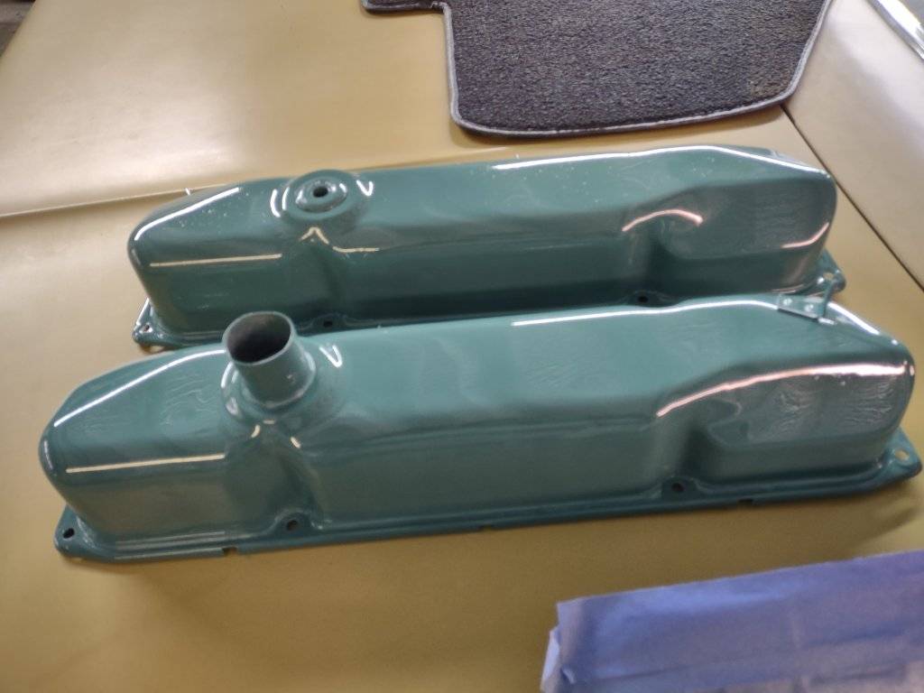

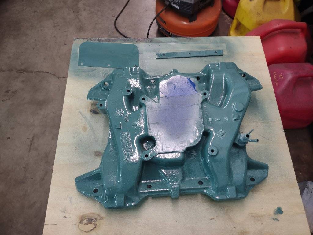

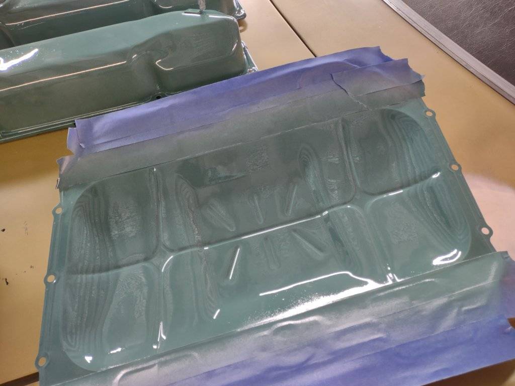

Anyone have experience with hirsch engine paint? It went on and looks beautiful. How long does it take to dry before i can handle it, put my engine back together? Its still tacky after 2 hours.

I love the color and gloss. Best paint ive ever sprayed

Its gorgeous paint so i definitely didnt want to rush it haha

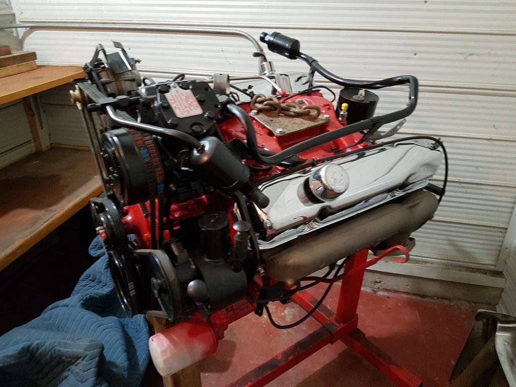

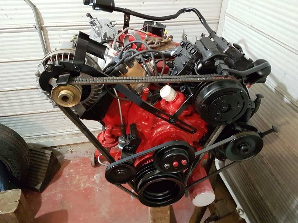

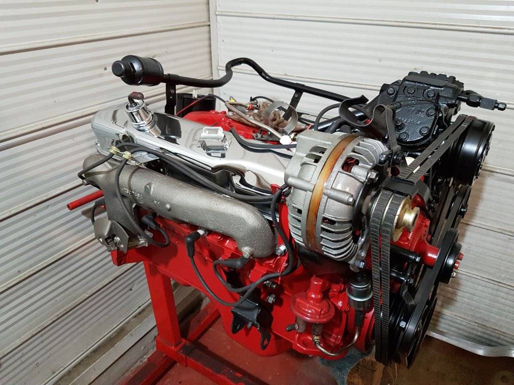

Mine was brushed on (I would have sprayed on the valve covers, but I'm going for chrome as you can see) ; Hirsch Chrysler Red (correct for 1966 Canadian Windsor-built 440s).

your Hirsch paint looks much closer to the proper color than mine did...happy it worked out for you...maybe they got things figured out in the 2 years it was out of stock
