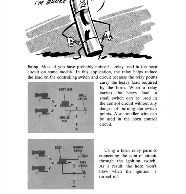

The Imperial has 3 horns and a relay. I understand that the Plymouths didn't have a relay, so it makes sense that the Imperial, with a more complicated system would need the ignition switch on for power.
From the 1957 "Service Reference Book" #118.
Note "some models" which would be logical that the Imperial got the better system. Also note that with the relay, the ignition has to be switched on.
