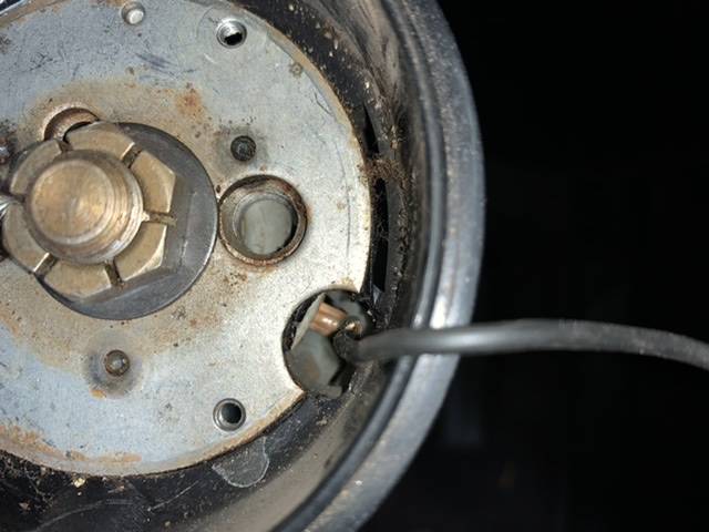

    Horn won’t quit blowing. This is the opposite problem most encounter when dealing with horn issues. I have confirmed that the wire running up the column is indeed grounded to the column without engaging the horn switch but nothing obvious is pinching the wire running up the steering column. The horn wasn’t engaging in the past before I had lowered and ‘rested’ the column on the drivers seat while I worked on the steering box, but I was careful when handling it. I’m guessing that I still aggravated something effectively closing the horn circuit. Is my only option pulling the wheel and looking into where the horn wire is grounding to the column?
    Hoping to button up the last few things so I can get the car inspected. I also noticed that the left turn signal light is not activated in the dash and I have no general dash illumination whatsoever. I did see a bulb hanging loose above the fuse box that may be the culprit but I didn’t see an obvious mounting point for that bulb. Hopefully the turn signal indicator is a replaceable bulb, although it looks like it may be a PIA to get to.

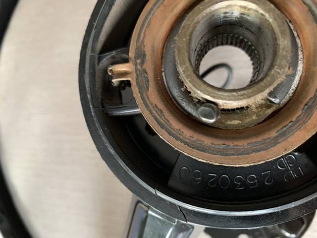

    Yes original wheel. I did disconnect the horn relay to stop the horn and I can confirm that the horn switch in the steering wheel works fine when tested independently. What I’m saying is the Black wire running from the relay, through the firewall and eventually up the steering wheel column is already grounded to the column somehow rendering the horn switch in the wheel useless or already activated.
  6. 78Brougham
    78Brougham "Chump" FCBO Gold Member
    Messages:
    14,381
    Likes Received:
    13271
    Joined:
    Nov 10, 2013
    Location:
    Wellsboro, PA
    Somethings not right there. That spade terminal shouldn't be bent over and touching the ring that circles the nut. That's gonna ground out and blow the horn constantly. Also there's quite a kink in the black wire, I'm sure it's fine but it shouldn't be like that.

    The terminal is not actually touching and the kink is not as bad as it appears in that picture, but the wire is already making contact with the steering column. I just don't know what I did that caused that wire to 'short' inside the column somewhere. I may run a wire outside the column to that spade connector and verify everything works fine. I certain that would work though based on some basic continuity tests. Are there spots in the column where that wire is likely to get pinched?

    Pull the wire out of the column and inspect.
    It appears from the picture that the part highlighted below is not centered, but it may be due to the angle of the picture.

    I can’t just remove the wire it seems without disassembly. The wire appears to terminate with a 90 degree connector about an inch down ..

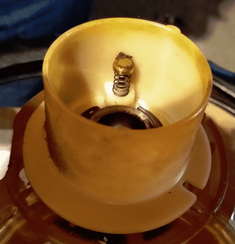

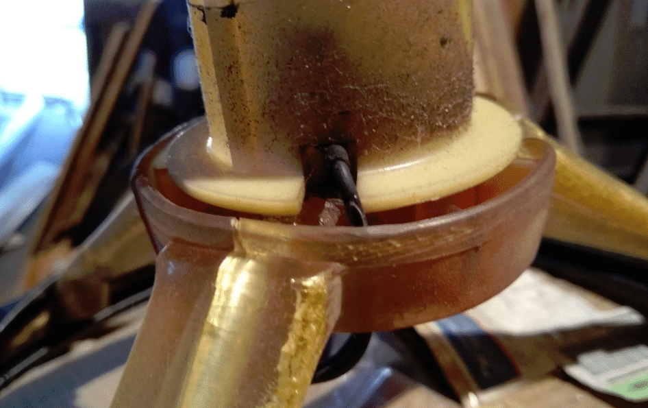

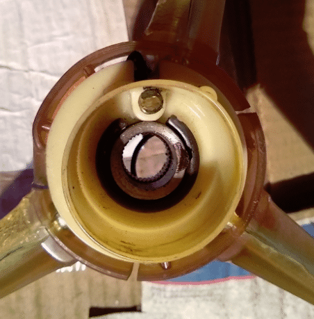

    I don't have a 2 spoke wheel off at the moment, but this is what a 3 spoker from a 65 Polara w/tilt looks like on the bottom. The black wire goes down and makes a quick right to the spring loaded contact going to the slip ring on the column.
    That white plastic collar is way taller w/tilt wheel, but I recall the 2 spoke wheels are similar on the bottom.
    Mike

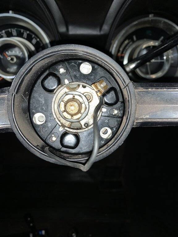

    i can't put my finger on it but something doesn't look right to me. there is nothing here:
    for this :
    to make contact with. there should be a copper ring that the button rides on like this on the wheel side of that button so that it is only grounded when depressed:
    the black plate is a spring plate that allows the horn ring to spring back when released. image-jpg.jpg
    maybe the column is ok and you inadvertently re-grounded the column when working on it , triggering an old problem ?

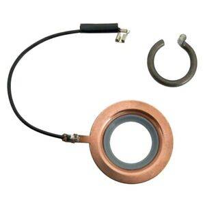

    This gasket must be shot. There is continuity here between plate and inner column. How do I remove the large “spring clip?”
  18. jbooth35
    jbooth35 Member
    Messages:
    134
    Likes Received:
    116
    Joined:
    Jul 20, 2014
    Location:
    Eighty Four, PA
    Where can I find replacement parts like posted in the image?
