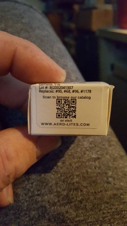

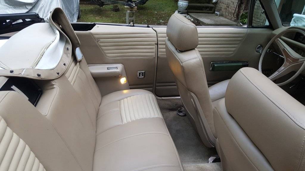

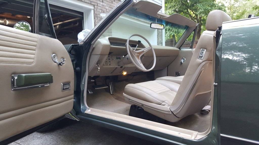

Ok guys, Almost a year ago I found these LEDs and I bought 3 because I knew I had two in the back seat that were the same, the one in the front lower dash in the middle was easy to get to so I replaced it. This is a 69 Polara by the way, these #90 bulbs have got to be the hottest bulbs in this car's whole interior, I think. The lower dash bulb before I replaced you could not put your hand on it after 30 sects it was that hot. Now I know that normally the door is only open for a short time, or you cut courtesy's on temporally looking for something or for someone to find something but GD those bulbs heat up. I can't believe my light lenses in these 3 locations look as good as thay do after all these years. These LEDs are exact replicas in shape size bayonet base and glass globe as #90 incandescent. I'm sure a lot of you all know about these already but I have to say the heat reduction and amperage draw numbers do not lie. Yes, I love original, but I like upgrades too. And this has got to be a positive.

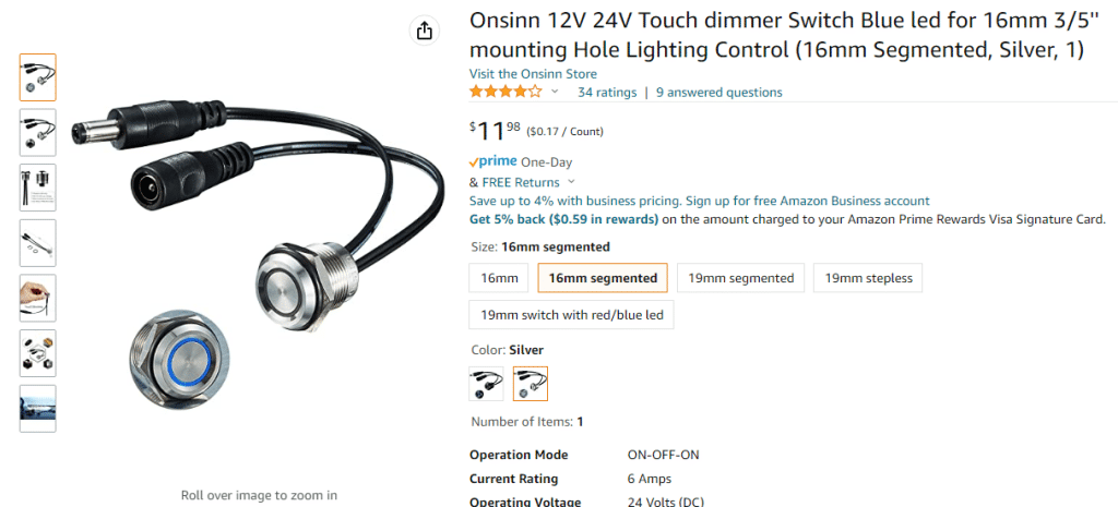

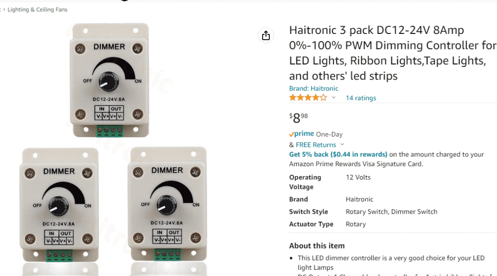

What is interesting about these is that most if not all the 12v leds say that they are dimmable, which usually is not the case. The dash #194 bulbs are this way too. mmmm
Likely most of them are dimmable if a PWM dimmer is used.
Some can be dimmed a little by reducing voltage (via a rheostat) but then they turn off when they hit their lower threshold for input voltage.
These are PWM, the tan box-type has been around for some years, the touch-type are newer technology.

The sockets for the backseat courtesy's have the little finger clips around the socket and it pushes into a metal box shaped shroud? blinder? Not sure what to call it, but its part of the light lens and seems fairly robust compared to other fixtures in the car and didn't seem to get as hot as the one in the front lower dash. Anyway, very interesting how these cars were built back then, the hardest part was getting the two screws under the armrest back in correctly which mine were not! The back screws on both sides were there but not attached, guess they gave up. Almost gave up myself when I knocked loose the screw clip and it fell to the bottom under and behind the lift cylinder! Long screwdriver and a piece of double-sided tape and I was back in business. Clip was bent so it would not stay in place, another unusual piece of engineering here also. Whew, all back together correctly and I'm happy with the results. My FSM was not much help, or I just missed it somehow in the book. Another little detail done, on to the next, seatbacks and hinge covers. Thanks to all for input on this thread I always learn something.
